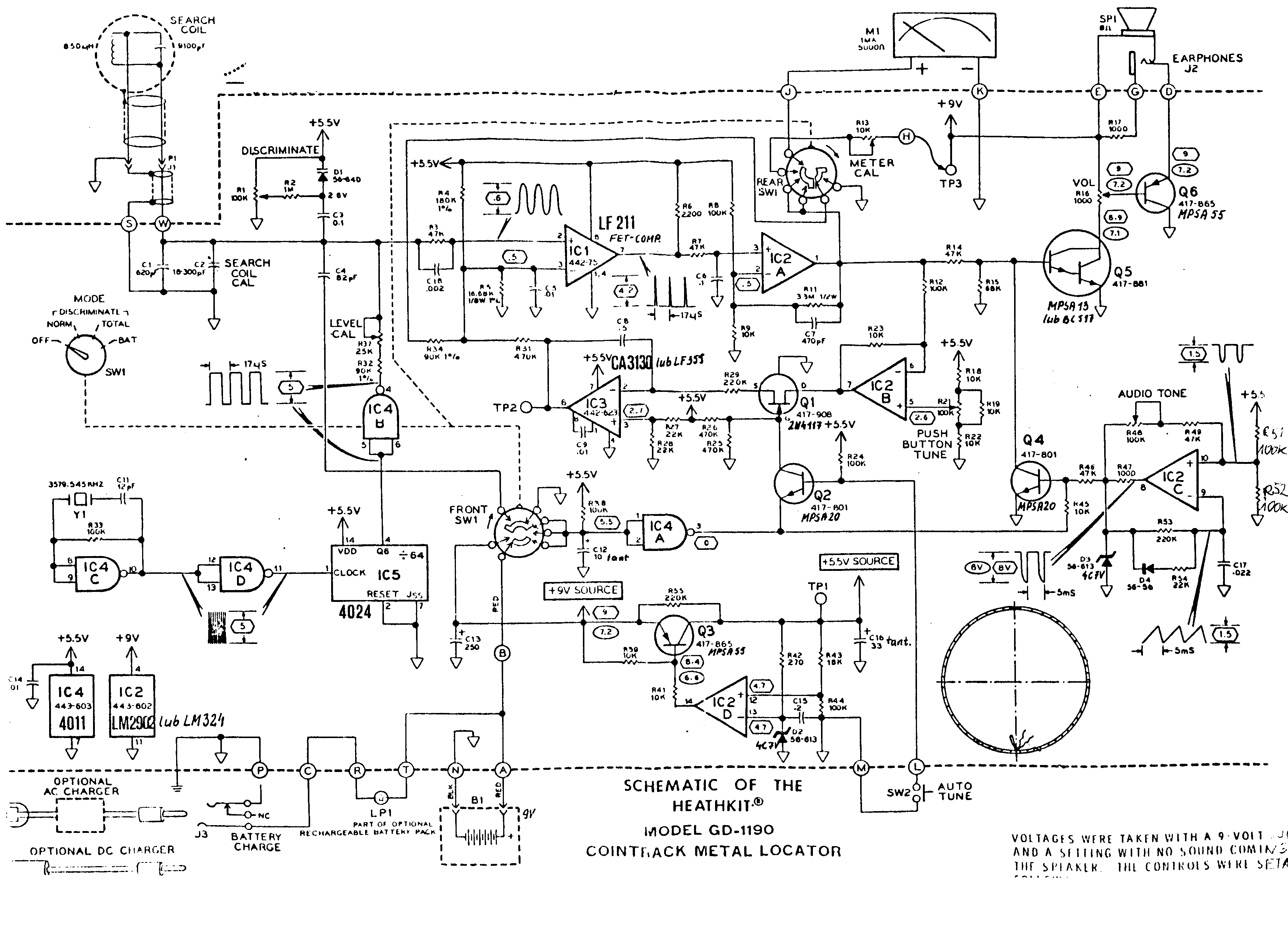

      I guess you are referring to a Heatkit off-resonance solution? That one had a passive tank driven by a crystal oscillator. I think it is the way to go as off-resonance oscillators simply can't be manipulated that easy ... despite the appeal of easy construction. I think there is a way around that constraint.
      You must have both amplitude and phase manipulation at hand (as Heatkit does) if you wish to have discrimination, but all-metal would work off-the-bat with a proper frequency/phase demodulation.

        Here is a Heathkit schematic I mentioned earlier

            Don't think an emitter follower would be a good choice for a coil driver - it has a low impedance hence constant voltage output. Note that the Heathkit design drives the coil via 100kohms or so. OTOH the collector of a small transistor can have hundreds of kohms of impedance, making signal changes due to targets more apparent.

                By single channel I mean that you can't select a single quadrant for discrimination, but two quadrants simultaneously, and hence it operates as "all-metal" channel. The Heathkit solution shows it is possible to have some level of discrimination, but what is less obvious is that when discriminating there is a strong ground influence. It is because the "slope detector" used there is strongly influenced with "I" phase (AM) response.

                    In my playing with the concept, I too realised that a driven tank is a way to go if you have any discrimination aspirations. Point is that PM to AM conversion functions well only in a driven tank. It means that if you observe only the amplitude, and by means of steering the driving frequency upper or lower than resonance, you'll notice that on one side amplitude change becomes greater than the other, and also target tau related. Hence discrimination.
