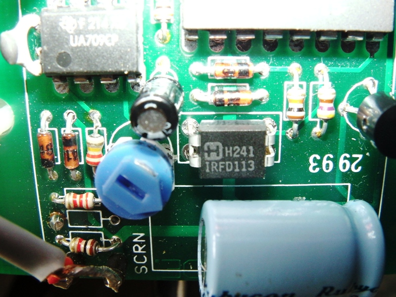

    hello
    I'm looking for information on electronic piece Free
    My pulspower beachscan
    what is the irf d113, and what is the equivalent?
    I do not find this irf in France

      YES the pulspower beachscan is detector of Eric Foster !
        Basic rating is 60V @ 1A, so lots of choices for replacement. You can more easily get a TO220 device, just bend the leads to get it to fit.
          Thanks & best regards Car l
            Yes, the Beachscan is one of mine. The IRFD113 is now hard to get anywhere and may even be obsolete. I have a stock of IRFD110 which is the 100V version and is a direct replacement. Ironically I am now in France but don't have any with me but will be back in UK on 20th and could post one over. PM me with address if you wish me to send one. Person with me in photo is Andy Flind who sadly died a few years back. He published detector circuits in the EPE magazine.

              Thank you very much for your proposal for irf110.
              But I managed to find a irf 113 and it's ok for my pulspower!
              again thank you and all my friends
              fred

                    agree with Carl. you may use more modern one, look this file. there is not direct replacement because rare DIP-4 type for novaday. while those DIP-4 MOS-FET's you can still find out into oldie PC's hard drives.
