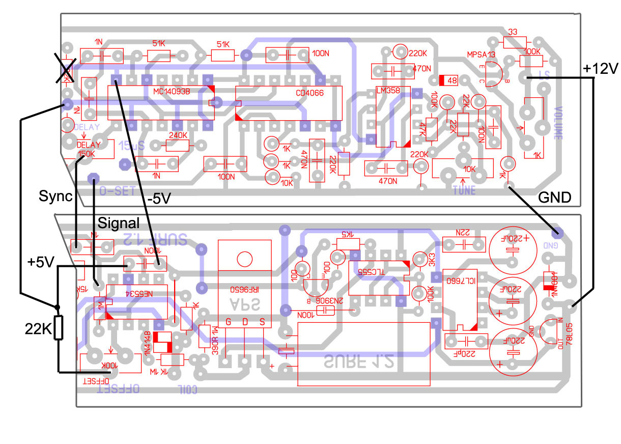

                    I finally made the Surf_PI with the pcb designed by Aq. Thanks to Aq and to silverdog for his very very quality pcb.
                    Now is time for the water resistance Box.
                    Slowly... slowly as the years passed
                      Hi Geo
                      please could you show me the Schematic and pcb design of Aq and to silverdog
                      thanks

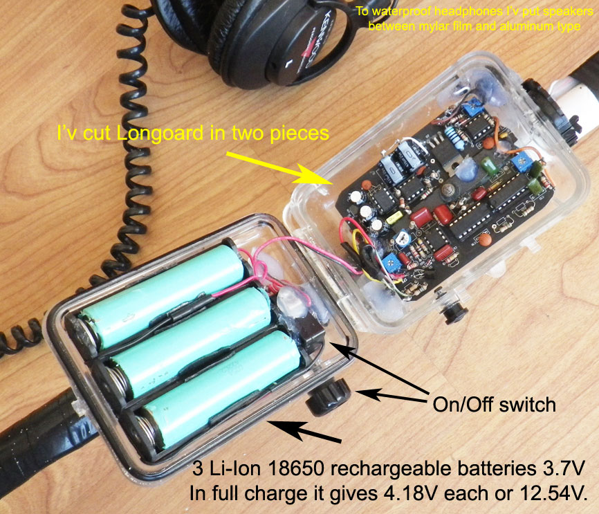

                        I am using "Snap Sights Flash 35mm Waterproof Underwater Reusable" camera box. It works for me 3 years already without problems.
                        For new machine I have purchased one more on eBay for record low $8 with free shipping recently.
                        But you need to cut longboard to let if fit.

                            I have made a few SurfPIs in this case and using it from 2009. Practically if it assembled good it needs no adjustments and works stable. I set treshhold once and never changing it. But probably my additions to schematic and Li-Ion powerful batteries helps to keep it stable. In some versions I am using SAT speed potentiometer to go faster.
                            But I can really recommend you to have SENSITIVITY potentiometer to adjust your machine for example when you go from dry sand to salt water.
                            Best potentiometer is that one from WestFloridaComponents.com !!! BECAUSE IT HAS O-RING INSIDE TO BE WATERPROOFED !!!

                              Hi Waikiki_Sweep
                              could you upload this photo in its original file and please if you have its PCB just upload it also
                              and also the list of components
                              i will be gratful for you
                              thanks in advance
                              Mohamed Ghitas
