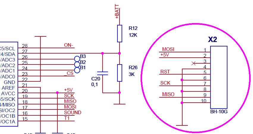

                        can atmega8 be programmed while connected to the chance pi pcb ???? can anyone pls advise
                        • #57
                          Yes, it can be programed and reprogramed (upgraded), via X2 port (marked at PCB).
                          • #58
                            i have just ordered a cheap atmega8 usb programmer from ebay china....can i just use the plug on the end of the programmer cable to fit directly into the x2 port on the chance pcb....will it be configured correctly with the programming pins of the atmega8 on the pcb ????
                            • #59
                              As a rule yes, but you need to check your programmer connector configuration (ask producer for programmer schematic) with this before:

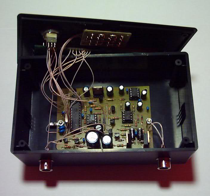

                              • #60
                                New pcb of the chance
                                Hi my friend i have a new pcb and change the etc
