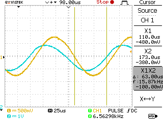

                            hi all guru
                            I CAN adjust the coils I take foto and need to say me is ok?
                            first pics show us that coil not adjust and Phase difference near 50 deg.look
                            second pics when i adjust them , Phase difference 180deg, look
                            thanks
                            please tell me about the speaker it is always have sound
                            thanks
                              bmo 18 looks ok.
                              My IDX is about 160deg
                              Joops is about 200deg
                              yours is about 180deg
                              this should be a good start - make sure you have the PP switch set to run in Disc mode.
                              Adjust the Threshold to quiten the tone.
                              you should be able to reject ferrite and iron
