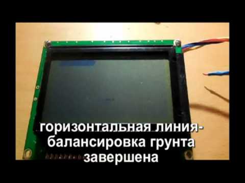

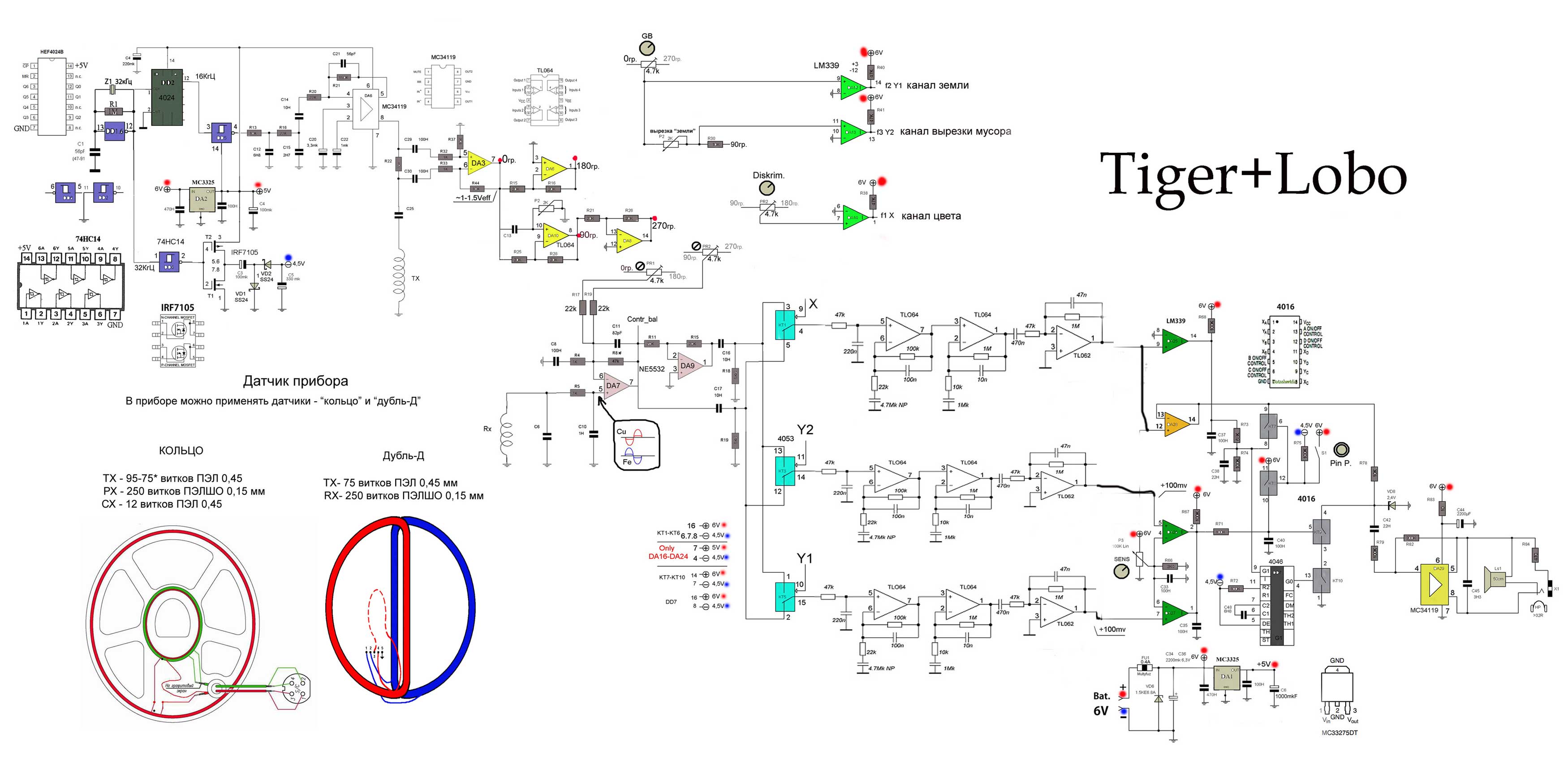

    Alex I see did some kinda hybrid of Tiger with Lobo. a part of Tiger was changed on disc part from Lobo. a sch here. a video from him demonstrating the issue.

            Any opinions on this Tiger-Lobo Combo ???
            Anyone build it yet , besides inventor ?? Field tests ?
            Best Regards................Eugene
              great schematic - very clear,
                Is this a VLF hybrid or PI hybrid ?? 14 or 17 khz ???? I see two schematics one is black/white image and newer schematic in color has crystal [quartz] oscillator ?
                Thank-You
                Best Regards............Eugene
                  no no, it is clear VLF. the black&white image is A PART FROM TESORO LOBO, THE FILTERS' PART, a base of the schematic is Tiger of Alex. yes, Alex's Tiger has crystal quartzed generator. he took FILTERS FROM LOBO AND INSERT THEM in Tiger, then checked that demonstrates in a video above.
                    kt315 all well explained to you, it's part of the 2 devices on the inductive balance. Quartz oscillator 32 kHz.
                    Field testing was excellent. After having I pinned him and hodograph.
                    Last time went last Saturday (in the snow in the cold minus 5). The device is just super!
                      oh sorry ... The generator on quartz 32 kHz, then division and output 16 kHz. It is good for the beach. For better field of 8 kHz (this is also solved directly in the device - is taken from the other foot chip) ...

                            Hello!
                            What is the value of R22?
                            Thanks!
                            • #44
                              Probably around 1 ohm.
                              • #45
                                Thank you!
