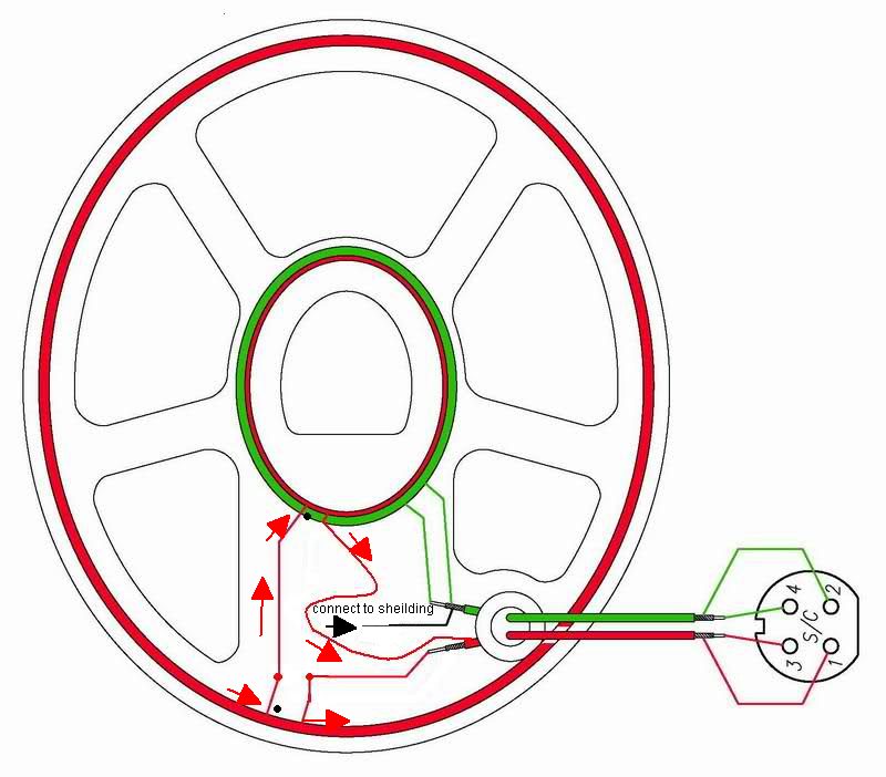

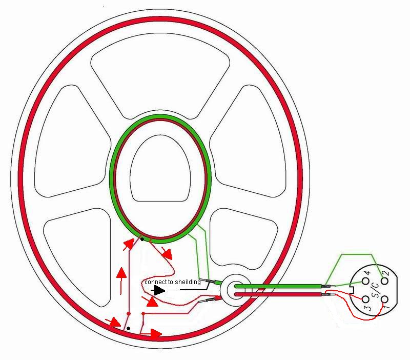

            I didn't use a pcb I used standard foam core from an office depot and filed out some of the foam with a rat tail file between the center of the paper. As far as a schematic, the schematic that was posted by FOMA coil is what I went by to build my coil. It was dead on with the wire connections. I hope it's ok to borrow? I did modify it a bit. Here it is.
            Praco
              Hi mohandes,
              Mistake! must see the following!
              The TX wires were backwards on the FOMA coil wiring.
              This is the corrected drawing!
              sorry...
              Praco
                  sorry...
