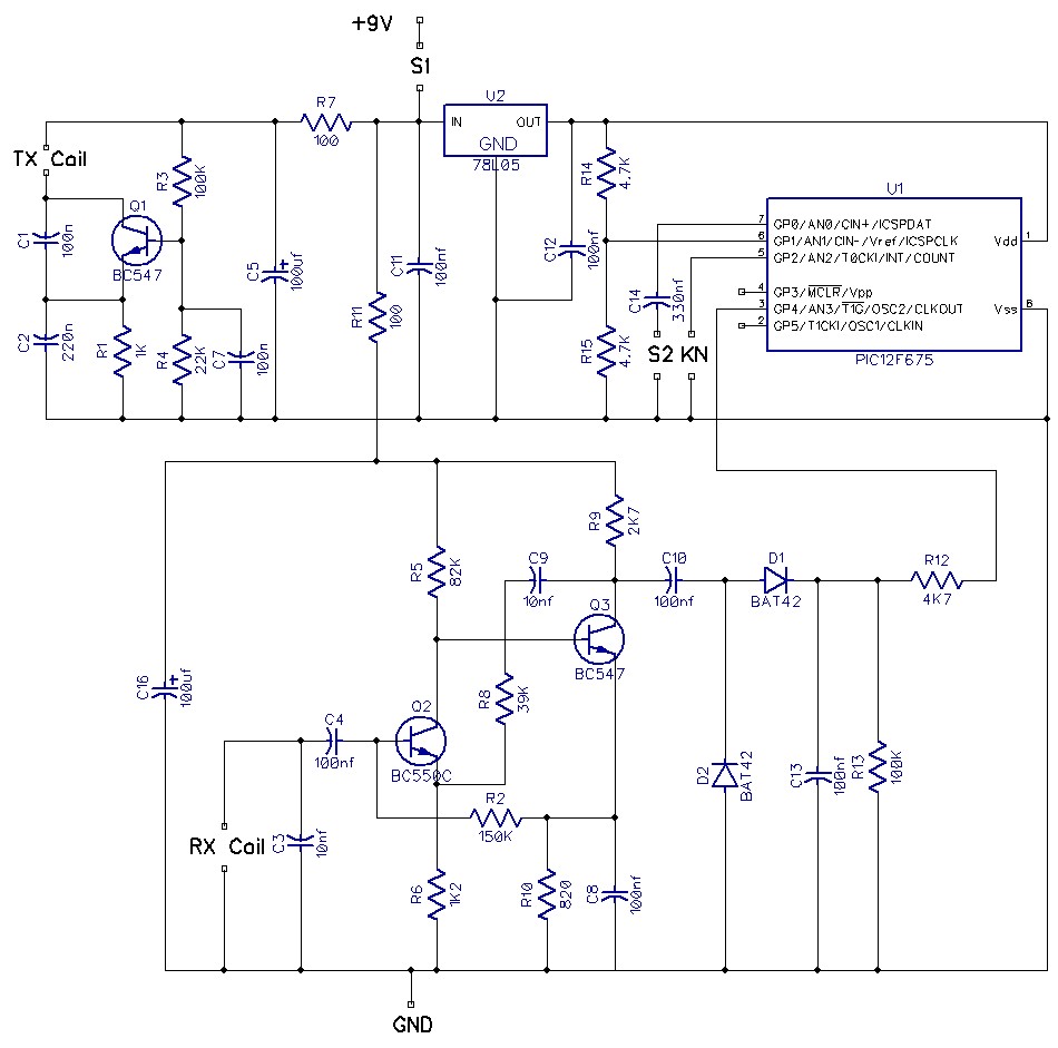

    Hello,
    not sure if it will work but what did you think?

    Hi, put the schematic up please S

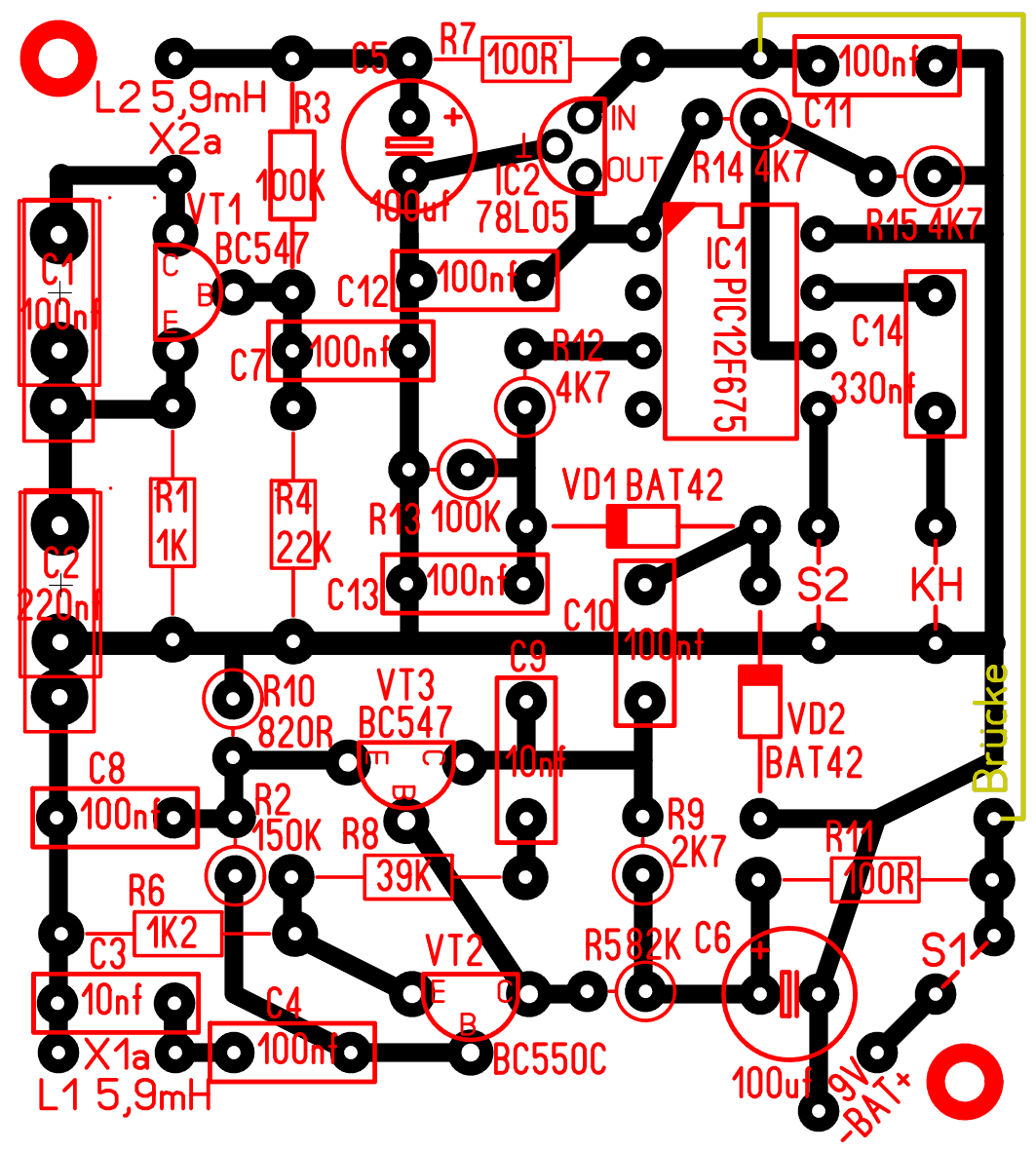

      I was so curious about this detector so I have redrawn schematics from PCB.
      Finally it appears to be some cheap VLF that using only amplitude of signal in RX coil to detect target.
      Because no phase readings so there is no discrimination and probably no ground balance, as I can understand.
      Good for the guys who love to run in "all metal" mode with their VLFs (and even multifrequencies like Fisher CZ or Excalibur).
      But what reason to make simple VLF detector with complicated (balanced) coil if it is much easier to make simple PI detector with simple mono coil.
      Hope some schematic blocks will be useful for further design of something more practical.
      (Someone add ground balance and target ID to this detector )

                  hello
                  i have mounted all components and made first test
                  and must says yes it works
                  easy to adjust
                  balancing tx rx coils is very easy made by tone indication
                  or measuring induced voltage on rx
                  i have changed the resistor 39k to a pot with 100k for more gain
                  the detector hhas following functions
                  s2 for setting the threshold barrier also jused as a pinpointer if you get closer to obejct press s2 button and the new barrier it set more down
                  s1 on off switch should be combined with a reset pushbutton (disconnector)
                  pot 100k for gain(sens) adjust
                  all works fine with a small enclosrue and a single 9v block
                  not depth but i sure i will find some points for improvements
                  btw has anybody some suggestions to pump more power to the tx coil
                  if i calculated right with the frequency it works in the common 1/ 1,2 freqeuncy shift tx/rx as i know it from tesoro projects here but around 6khz area
                  kind regards

                      "...btw has anybody some suggestions to pump more power to the tx coil..."
                      Lower R3 and rise R4. It will affect power a bit, not much but a bit.
                      Try to experiment with R7 too, lower it.
                      Q1 can be some higher gain, maybe?
                      And that's about all what you can try with present setup.

                            The problem with this design is going to be a lack of ground balance capability. It will work fine in an air test, but bringing the coil close to ground will kill the sensitivity to non-ferrous targets, unless you can keep the coil parallel (and a constant distance from) the ground.
