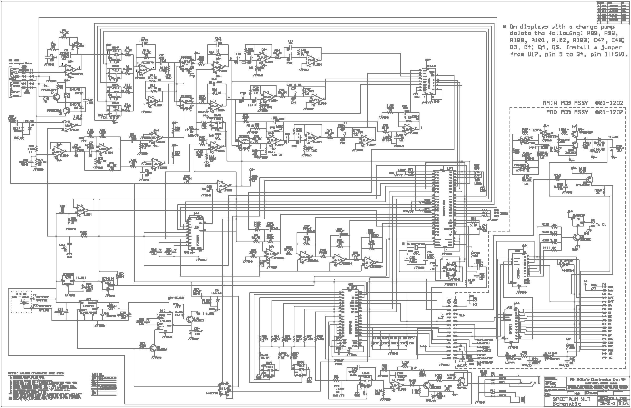

    Hi , I have damaged my XLT inverting battery polarity ...
    It tries to power on but only fast lines appears on VDI then nothings happens.
    Can anyone help me to locate wicht component is damaged?
    in left bottom corner of the schematic you see a power supply... I give also datasheet of converter IC... you see at pcb this chip near ferrite coil...
    try from this...

        Thanks mate I wil try to test it today.
          1.8V in output , I will buy a new one : LM2574N5 5volt output ,right?
            Changed but didnt work , powers up , screen light on but nothing appears on it.
            Any idea?
              The drawing isnt very clear - so forgive if wrong.. but there appears to be a -ve volts generator on top RHS . 2 transistors fed by oscillator does this give -ve volts out??

                  Nothing on the screen? I would start with verifing +5V for the processor then check the
                  crystal to make sure it's oscillating. You can do both with a meter if you don't have a scope.
                  The oscillator should read around 2.5V.
                  Get the processor and display working first...

                    Im thinking that the EPROM is dead...
                      I'd guess U14, U16 and Q3 would be the first to go with reversed power. Why they didn't include
                      a protection diode is beyond me...

                          U14 changed for a new one
                          Q7 changed for a new one
                          C31 changed too
                          Q3 , U16 , U20 , caps and diode seems to be OK but dont boot
                            Did you measure the supply rails?

                              12v input on U14 but only 2v output on U14-4 U14-7 , changed again U14 and same measure (1.8v - 2.7v).
