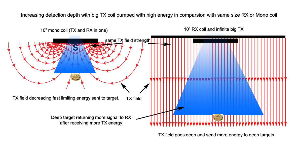

                      OK. Magnetic field is not spreading as a radio wave or laser beam. Probably even kids knowing it.
                      You know how fast magnetic field strength decreasing with distance from the coil.
                      That is why we have so small signal from target so we have to amplify it in millions times.
                      TX signal quickly decreasing on the way down than target signal drastically loosing power on its way back to coil.
                      But you can see that coils with bigger diameter has larger magnetic fields going deeper. You can not increase RX or MONO coil size without limits
                      because you need it do detect targets of particular size, also noises, ground effects and earth magnetic field will give you a lot of troubles.
                      Let say that RX or mono coil have to be near 10" for coin size targets.
                      But you can increase TX coil size with less difficulties. Only weakening magnetic field is a problem for bigger TX coils but you can pump it with Amperes.
                      If it becomes slow probably additional electronic can short coil in proper time to makes decay faster.
                      If you can imaging TX coil that has infinite size and create magnetic field same strength as a 10" MONO coil and that field is
                      uniform in shape you will see that field going down to any depth without decreasing (sure it is only theoretical step for the illustration)
                      So now we have only RX signal decreasing with distance not TX.
                      As result all the amplification, noise, e.t.c. are the same as for 10" monocoil but because deeper targets are excited by global TX field and returning stronger signals you can detect it on extra depth.
                      Illustration: Click image for larger version
                      It was theoretical because to create infinite uniform magnetic field same strength as 10" monocoil gives you you will need infinite energy source and have other technical difficulties.
                      But for practical realization you can just make TX coil some bigger than 10" RX and pump more current into it to keep same magnetic field strength deeper.
                      As result you will have deeper detection for particular target depending on size of TX coil you build and TX power you can use.
                      If you have good power source why not to use that idea to get several more inches in detection depth?

                        Hi Waikiki_Sweep,
                        yep, I have been saying the benefits of split TX/RX coil for long time now. You are one of the few, who has recognized the benefits. (All the others: keep sleeping, don't change things, keep sleeping... )
                        The latest EM numerical simulations even show, that a large mono coil (20") isn't performing better than a splitted TX (20")/RX(10") coil with equivalent EMI noise induction. The splitted TX/RX coil has additionally a better pin-pointing feature and will have less ground response too.
