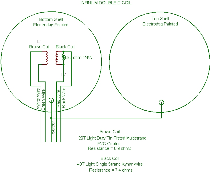

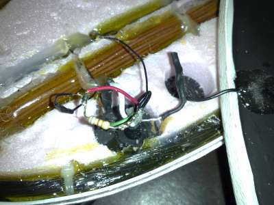

      Check what is inside Garrett Infinum LS coil because that detector is one of the best PI machines with separate TX and RX:
Name:	INFINIUM DOUBLE D.jpg
ID:	338883 26 turns is TX, 40 turns is RX
Name:	infinium closer an open.jpg
      Also Infinum coil looks balanced or adjusted very close to it. Such configuration gives a lot of benefits because RX receiving mostly targets (and ground) signals and less to nothing from TX decay signal.

                    Also you can see why separation of TX and RX gives you so many benefits. Without any problems you can make RX inductions higher than TX and have more turns in RX to receive stronger signal.
                    As example, one of DD coils for PI detector - Garrett Infinum LS has 26 turns for TX and 40 turns for RX when coils have same shape and size.
                    So RX has 1.5 times more inductance than TX and receiving 1.5 times stronger signal in comparison with monocoil.
