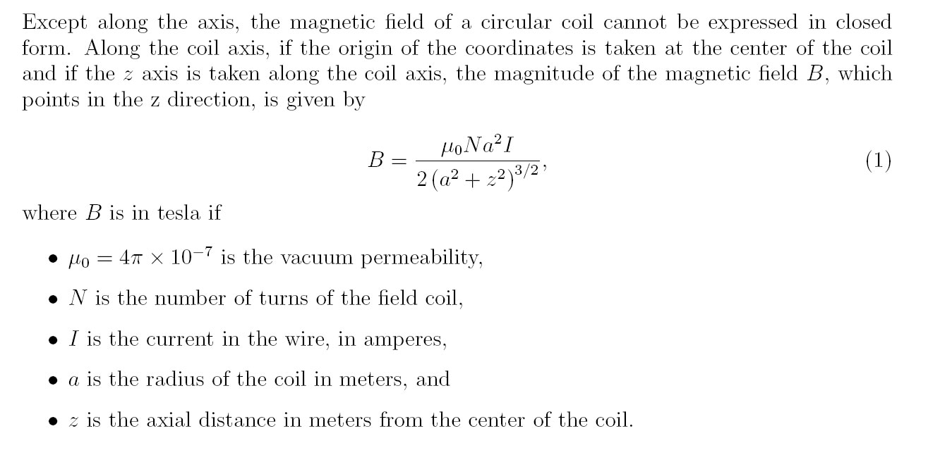

      • #48
        http://hyperphysics.phy-astr.gsu.edu/hbase/hframe.html
        Using the calculator above, I get the numbers to estimate the field strength at a distance from the coil. If we also factor in the surface area of the skin effect targets we might get some interesting numbers.
        Sorry I can't find that calculator by the link.
        At lease I have found a formula to calculate field strength with distance from the coil: Click image for larger version
        Graphic illustration of decreasing field with distance from coil for favorite Aziz coil sizes 10", 20", 40" would be very educational.
        • #49
          http://hyperphysics.phy-astr.gsu.edu...curloo.html#c1
          • #50
            Results are amazing !!!!!
            Comparison of two TX coils making same magnetic field strength: 0.628 Gauss.
            First coil 8" diameter (10 cm radius) 10 Amperes current.
            Second coil 16" diameter (20 cm radius) 20 Amperes current.
            You can see that to keep same magnetic field strength you need only twice more current to increase diameter of coil two times ( Linear !!!!! )
            depth 8"coil - 16"coil -- gain --- Graphic illustration of achieved gain
            (cm)
            0 ---- 0.628 --- 0.628 --- 1 : 1
            10 --- 0.222 --- 0.45 ---- 1 : 2 ------
            20 --- 0.056 --- 0.222 -- 1 : 4 -------
            30 --- 0.02 ---- 0.107 -- 1 : 5.4 ------
            40 --- 0.009 --- 0.056 -- 1 : 6.2 ------
            50 --- 0.0047 -- 0.032 -- 1 : 6.8 ------
            Can you see it !!!!!!!
            If you just rise TX diameter twice from 8" to 16" and increase current of impulse in TX two times from 10 Amperes to 20 Amperes
            buy longer impulse or thicker wire or higher power supply voltage you can create almost 7 times
            stronger magnetic field on the depth 50 cm.
            7 times gain for signals from your targets!!!
            A fantastic depth increase!!!
            It is hobbits "wrong way" only because respectful corporations will be avoiding anyway to build ridiculously looking huge coils with half meter TX even if it gives huge depth benefits.
            Goodbye monocoil

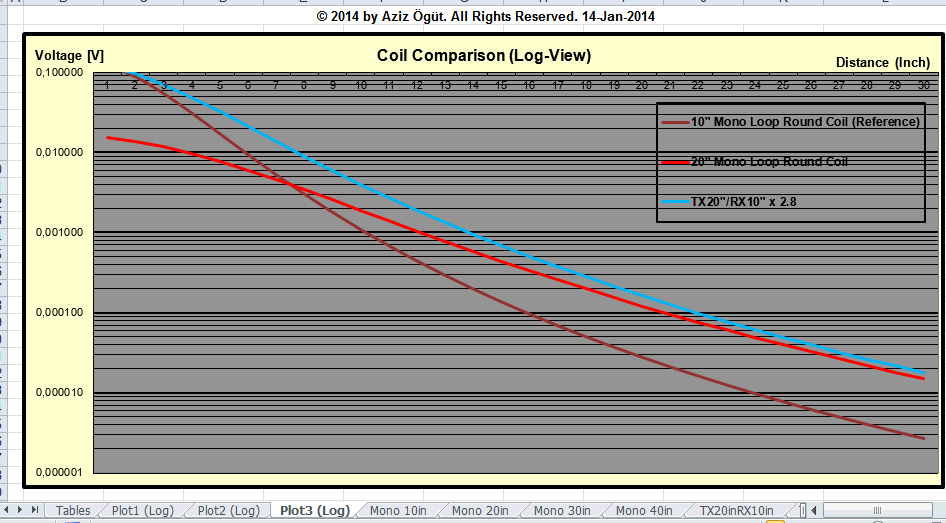

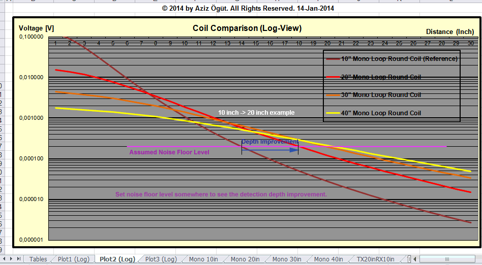

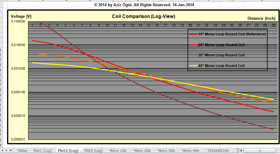

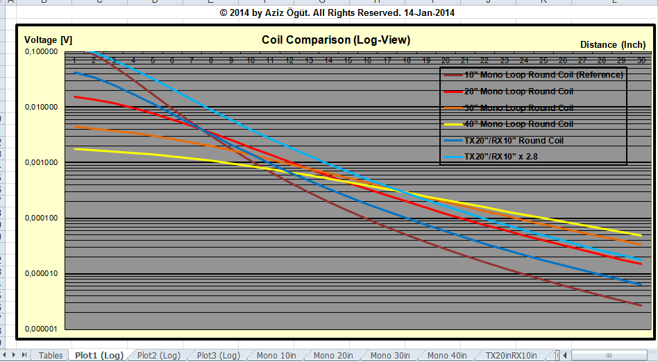

                  • #54
                    Results and Excel Table
                    Hi all,
                    this is the result of the EM simulation analysis.
                    Note:
                    Coil Current = 1A, Coil = 300 µH, Frequency = 1 MHz, Target = 20 mm diameter wire ring, target response along the coil center axis (Z-axis). I take the high frequency induction (1 MHz), because I don't want to see a lot of zeros in the response figures. Also notice, that large coils will have low target response along the center-axis. Small targets will be usually detected on the coil edge (not taken into account). We are focussing to the depth detection only.
                    The detection depth improvement is dependent on the noise floor level (SNR) of the front-end system. The higher the SNR or the lower the noise floor level, the higher the detection depth improvement. You usually have somewhere your noise floor level (where the targets can't be detected and the noise chatter begins). If you draw a horizontal line at this level, you can see the possible depth improvement for the coil and specified target (20 mm diameter wire ring).
                    The increased EMI noise and ground response hasn't been taken into account for the 10", 20", 30" and 40" mono coil comparison. So large coils will usually have a larger noise floor level and you will have lower detection depth improvement at the end.
                    Now to the plots:
                    When I make use of the 2.8 times benefit (low EMI/low ground response) I get better results with seperate TX/RX coil.
                    This is the Excel file for your convenience (zipped):
                    CoilComp6(CoilCMP3)-01.zip
                    Cheers,
                    Aziz
