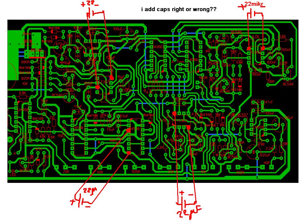

        remove all ICs and check your pcb then add D6 and check by multimeter you should have near 8v . if ok then put NE556 and see pin5 and pin9 should have wave ( can change by 220kohm pot ), and set it 80HZ or 100HZ or ...
        if ok then put 4538s and should have waves in pin 9 ,10 , 7 , 6 .
        if ok put lf and ....
        please check all parts .

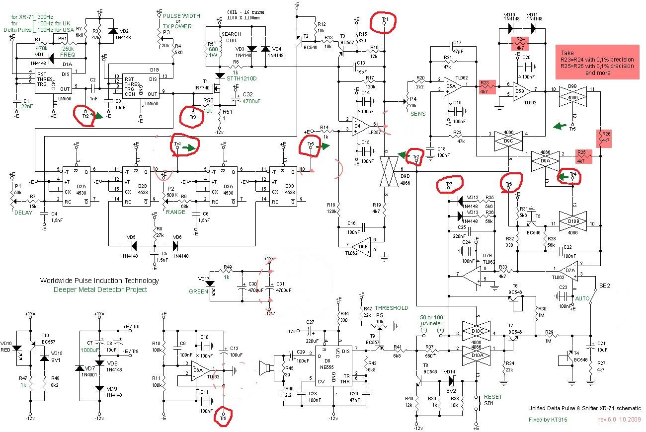

            i should learn more about the detectors. but i see your pics and have problem to add 22mikro tantalum to the board , please see and say me .
            i use this schematic and want add caps to my board.
