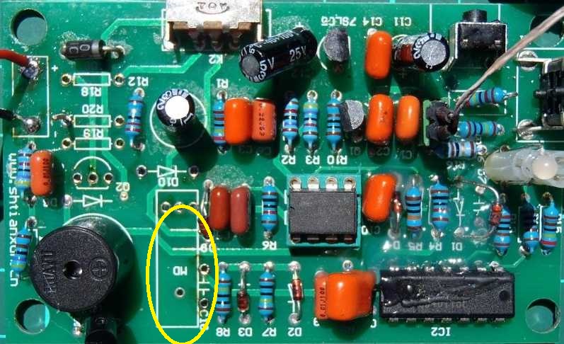

    As it was when first opened (prior to my first molestations).
    I added the green IC socket and the two pin header socket myself for easier bench testing.
    The brown ceramic SMD cap is my addition, but it's so trivial an 'improvement' I'd just ignore it.
    The manual says it's a 90kHz device but the CRO reads 20kHz unmodified, and 17kHz after I added a bit more C across the coil.

                      The real problem is here;
                      The MD is missing. Just plug in a metal detector there and you'll be all set!

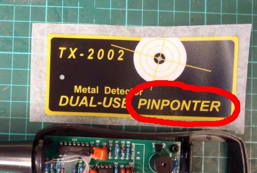

                        And it's surprising that no-one has noticed this -> Click image for larger version
Name:	Spelling mistake.jpg
                          That's how you can tell it's a Chinese knock off...
