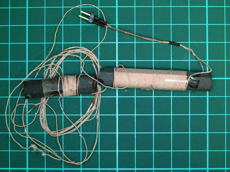

                        The OEM coil
                        I've done a bit of playing about with the TX-2002 this weekend (another very hot one here).
                        I removed the original ferrite coil from the pointer. It turns out that the coil was glued in with hot-melt, and putting the pointer in freshly boiled water for a minute or so loosened it up a bit. Pulling on the two wires slowly got it out, well sort of. Half came out, half stayed in To get the second stuck bit out I drilled a 3mm hole in the pointers tip and pushed it out with a stiff wire (heated it again in boiling water first).
                        So it is the end of that coil as I suspected it might be. The ferrite was broken just below the middle. I'm not sure when this might have been broken, when new, when I tried bumping the coil free, when I levered on it with a screwdriver, when aliens broke into my shed and tampered with it, I dunno.
                        One small bit of news though is that it was approximately 160 turns of wire on a 100mm ferrite.
                        Since then I've reloaded the components back on to the TX-2002 PCB (with all new resistors and diodes), and then tested it by rewinding the 62 turns of 0.5mm wire coil onto the OEM ferrite (the longer broken piece of it).
                        With the OEM ferrite it's not as sensitive as my first ferrite (the 180mm long one) perhaps about 60% as good. The OEM ferrite might be inferior or too short now. I need to buy some more 0.5mm wire to continue as the bit I have has been used too many times. I noticed on the CRO display that the new coil generates a higher frequency than the old test coil, and the coil voltage is only 4V P-P, so I'm going to measure the L value next week before making another coil/coils for testing.
                        Also need to rat out a vibrator from an old phone and fit the components for that option.

                            Last bits
                            Two more (last ?) images of the improvement project.
                            The unit is actually now a useful tool. I tried it out in the garden and found all sorts of childrens toys (like Matchbox cars) buried under the top inch or two. Also found small items clothes peg springs no problem. So it seems to be ready to try out on a beach or country ruin now.
                            On my table top $1 coin test with the final coil I get 60mm face-on and 40mm edge-on (to the probe tip). This is a massive improvement from the useless detection 'range' out of the box. I'm happy with that for now, and the unit is worth the $30 I paid for it (LOL, 10 hours of tuning later).
                            The final winding for anyone else interested is a 100mm ferrite with 60 turns of 0.5mm diameter wire, wound 8mm from the end. The main board circuit is unchanged from original.
                            My last bit of tinkering was to fit a Haptic device and load the driving components. I used a vibrator from an old Huawei mobile phone. The vibrator in that one is flat round device that looks like a coin cell but isn't.
                            I used a BC549 transistor (fitted backwards to the silkscreen outline), a 1k drive resistor (R18 ) and a 10k pull down (R19) and a 1N4148 across the motor (D10). There is also a load resistor (R20) to drop the 9V down to about 3V across the haptic (or it might burn out). I found 62 ohms worked for my device. The setup works quite well.
