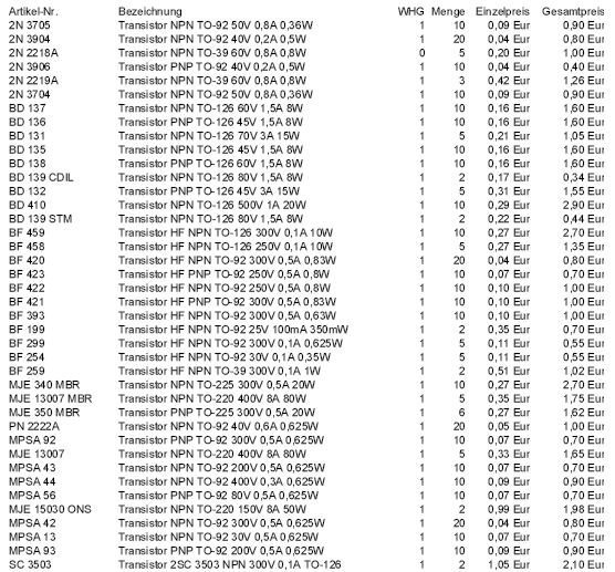

      My project budget is very limitted however. I have just ordered the following parts (see below).
      Still some interesting transistors for testing. I'll solder the PNP version soon.
      I'm looking forward to test them soon ... stay tuned...

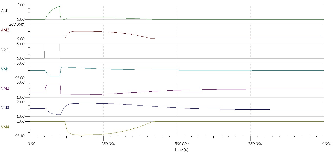

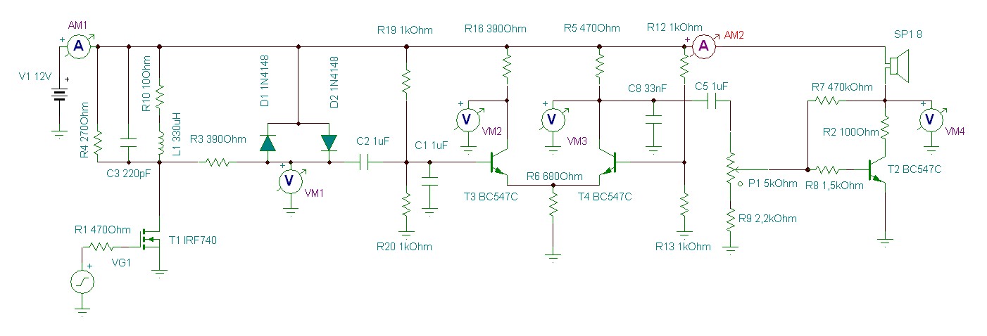

      • Hi everyone, i've been doing a simplified version of simpler pi, i hope it works i'm traying to attach the circuit and simulation.
        • hello pipolanar
          try to make a pcb board an see if it works in real life

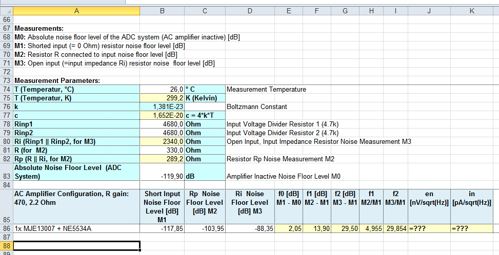

                            • Hi all,
                              I'll show you the used parameters to give you an initial idea of how to calculate the figures. One measurement data is supplied.
                              Solve the formulas for en (voltage noise density) and in (current noise density) and win the great prize.
                              Clue:
                              Noise calculation:
                              e = sqrt(en^2 + 4*k*T*Rs + (in*Rs)^2), where
                              e = Total voltage noise density of the amplifier system
                              en = Voltage noise density of the amplifier system
                              in = Current noise density of the amplifier system
                              Rs = Input source resistance
                              Note, that I'm using the relation factors f1 and f2 of the measurements (see below the picture).

                              PS: Come on guys!, solve the two equations for me please.
                              Someone has to bite the bullet this time!!!!!!
                              (Don't look at me!!!! . Where are the gurus out there?)
                              • Anyone got the two equations?
                                Nobody?
                                Ok, another trick:
                                No one can calculate it! No one!
                                Got motivated now?
                                Comeon guys, bite the bullet please.
                                ^sif
