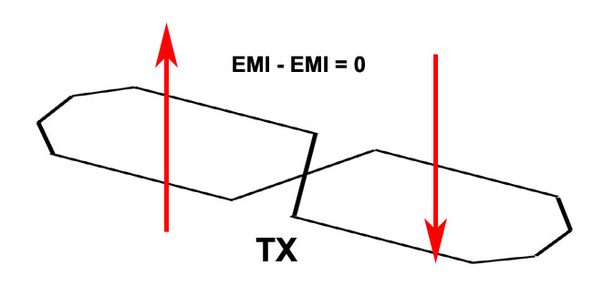

            If your main problem is EMI you can also to try a machine with "BIGFOOT" coil. Because in Bigfoot coil TX has a "8" shape it eliminates all EMI on 100%.
            Also you can try to build your own PI detector and put "8" shape coil on it. "8" coils may reduce a depth but it has absolute EMI protection.
            Also that Fisher CZ detectors I have learned schematic and can tell they have tons of filters in RX. I have never got any EMI problems with CZ.
              antistatic field protection in any coil, to be its PI or VLF design, does not serve against EMI influence. please read the book INSIDE THE METAL DETECTOR for first.
                "8" shaped RX coil is best protection from EMI. Any objections?

                        Chatters do come from old spark plugs as well, regardless of the shield and a terrain. For that reason a figure 8 coil configuration, or any other humbucker configuration would do good. But ... such configurations have + and - phase responses. Not a problem for PI and not a problem if both Rx and Tx are in figure 8 configuration.
                        I'm considering a 4 quadrant discrimination scheme where phase vs. counter-phase wouldn't make any difference. The only caveat for a figure 8 in that case is - depth loss.
                          Inverted phase for "8" coils sure is a problem. I can see a lot of detectorists using that 18 inches "Bigfoot" coils.
                          I have asked many of them and they are extremely happy with it. It gives huge area coverage, lightweight, great pinpointing and sure NO ANY EMI.
