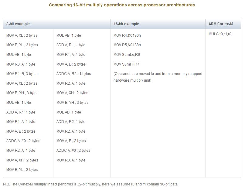

                Yeah, but the LPC810 is a 32 bit chip, has I2C and SPI ports built into the chip, and can be assigned to any pin via the switch matrix.
                It has a single cycle 32 bit multiply, and single cycle IO. Based on the chart, I'd rather have the LPC.
                In addition, it doesn't require any programmer, its cheaper (digikey $1.37 versus $1.53).
                In all fairness to the ATiny's, this chip is intended to replace those older chips and be faster/better/cheaper doing so.
