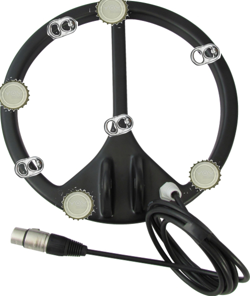

                  Maybe I found a solution!!!
                  I was thinking about the "anti-phase technology".
                  I take beer caps and pulltaps and glues on the coil, from that moment on I never detected a
                  beer caps or pulltaps with that coil.

                        In the past I have experimented with "mechanical phase shift". I'm not kidding.
                        You might be, with smale aluminum or copper plates, the coupling between the two coils TX and RX
                        influencing just a little, a small mechanical phase shift.
                        Perhaps the detector just make an accurate calculation for the beer cap.
                        The phase shift is for the entire range.
                        But you can try if the rest of the targets remains good.
