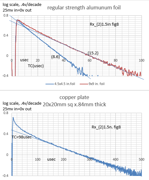

      • A couple tests yesterday.
        nugget simulation_6
        Top chart with foil larger than coil. Decay time increases with increase in target size when targets are larger than coil size, Eric's meter doesn't change, any thoughts why?
        Bottom chart with target thickness greater than skin thickness at 100kHz. Copper plate doesn't chart straight line decay until around 200usec. If calculate frequency for skin depth=target thickness, then 1/frequency is about 200usec. I'm wondering if to get straight line linear-log decay starting at 10usec, target thickness needs to be around or less than skin thickness at 100kHz.

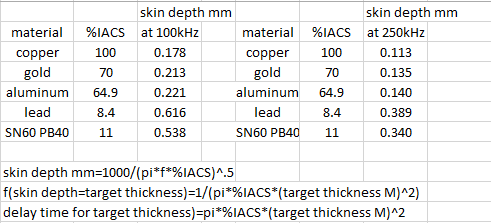

        nugget simulation_5
        Some formulas and calculations. Maybe someone could check if they are correct or should be written different.
        Thinking of trying some more tests. Maybe some targets .5, 1, 2 and 4times skin thickness at 100kHz. 2 or 3 different diameters. Any thoughts or suggestions?

          I calculate .14mm instead of .3mm skin depth for aluminum at 250kHz. Is either correct?
          • 0.164mm ?
              0.164mm ?
              What did you use for %IACS. I used 64.9 for .14mm skin depth that I searched. Tried searching again, 64.9 for pure aluminum foil. Found 1235 material used for kitchen foil, %IACS=57% calculates skin depth=.15mm if I'm calculating correctly, maybe not.

                          • Think my second guess for unstacked probably correct. First guess was based on reply#196 where reading was effected by thickness and I missed that correction was for thickness as much as 40% below minimum. I calculate .164mm(IASC=64) and .232mm(IASC=32)for minimum thickness for aluminum, Eric needed .3mm for the reading not to change. Could someone check my math?

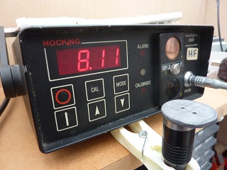

                            • I found what looks like a lead button, 30mm diameter x 2mm thick. According to my IACS chart lead should read 8.4% - 7.7%. I offset the button so that the holes were just outside the sense area of the probe.
Name:	Lead button.jpg

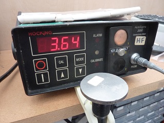

                              Next is a bronze disc 56% Cu and 43% Ni. 42mm diameter x 3.5mm thick. The nearest on my chart is 70% Cu and 30% Ni. and has an IACS of 4.5%.
                              My sample has a has a higher percentage of nickel which has resulted in the lower reading of 3.64%.

                              • Regarding that Cupro-nickel disc of Eric's, I came across this small graph showing how nickel percentage affects resistivity of Cu-Ni alloy:
                                ... from which you could take a reading of 0.475 for 43% Ni alloy. This translates to conductivity = 2.1 x 106 ; or 3.6% IACS, as Mr Hocking indicates.
