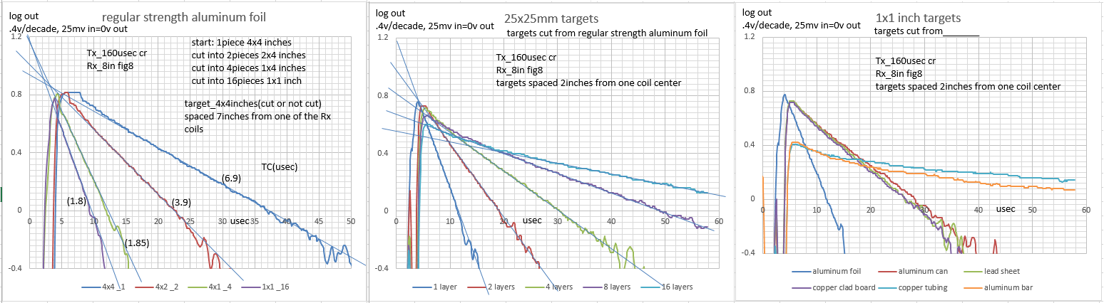

      http://www.geotech1.com/forums/attac...9&d=1543333008 Don't know if you saw this graph. At 9usec the 18grain nugget flat has 100 times the signal as the 4grain nugget on edge. At 9usec the 18grain nugget flat has 10 times the signal as the 18grain nugget on edge.
          Thanks green, I hadnt seen that. Nice work on charting all that..

              Chart I posted before, shows change in amplitude with constant area. TRT_28: left chart, total target area 4x4inches cut in pieces to change TC. Middle chart, each target 25x25mm layered to change TC. Right target: all targets 1x1inch(aluminum can side, lead sheet and copper clad board had similar TC and charted about the same decay curve). I have some charts with TC staying the same and target area changing, need to do a couple more to verify what happens. Could try something else?

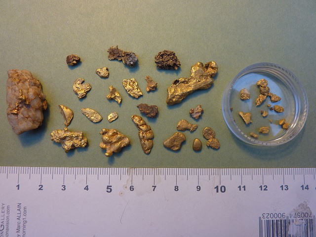

              • This is the picture that should have accompanied my post 238. It appears not to have come out, according to one of my computers.

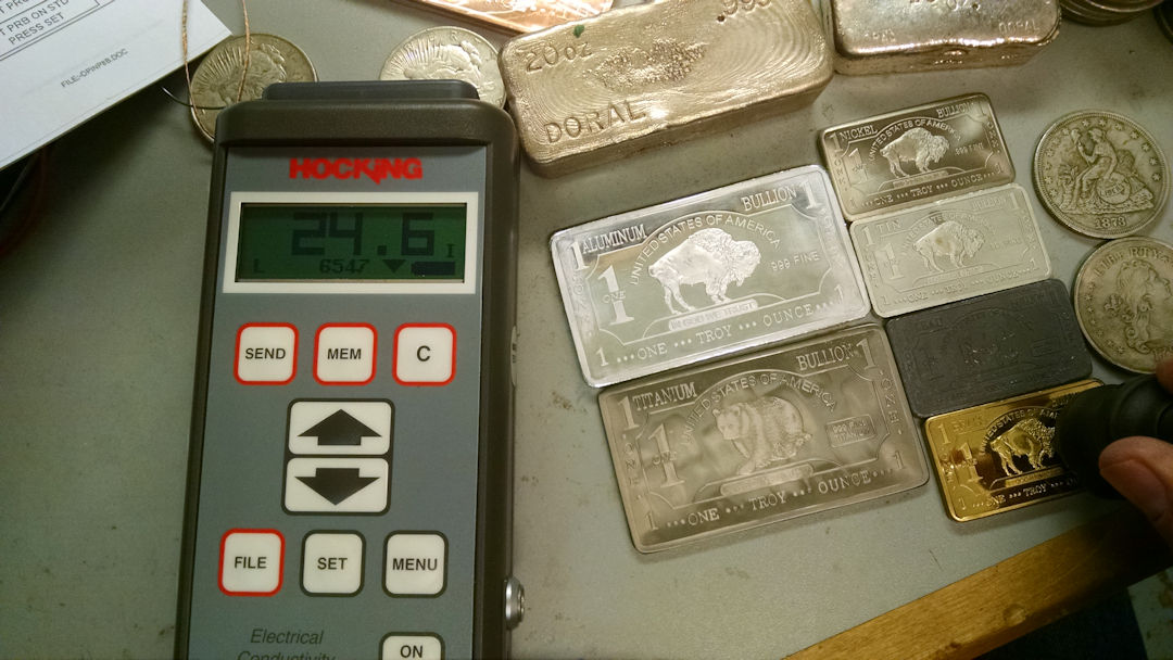

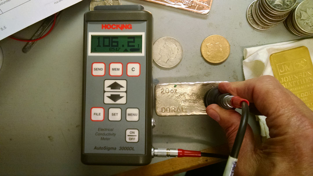

                          • I found my Hocking AutoSigma, it's a 3000 handheld model. It is dual frequency, 60kHz & 200kHz, but the 200kHz doesn't seem to work. I get an overload error even when trying to calibrate.
                            Tried a whole bunch of metals:
                            .999 10-oz copper bar = 76.4
                            .999 20-oz silver bar = 106.2
                            .999 10-oz gold bar = 75.1
                            .999 1-oz aluminum bar = 60.1
                            .999 1-oz titanium bar = 3.74
                            .999 1-oz nickel bar = error
                            .999 1-oz tin bar = 15.2
                            .999 1-oz lead bar = 8.30
                            .999 1-oz brass bar = 24.6
                            $20 gold piece = 15.8
                            1922 Peace dollar = 77.1
                            1928 Peace dollar = 81.8
                            Fake Trade dollar = 25.1
                            Fake Bust dollar = 26.8
                            Tried several silver dollars, the 2 examples above were indicative of the skews I was seeing. The fake dollars are easy to distinguish. The copper bar was curious, I expected higher. The nickel bar, I dunno what was going on there. But I have doubts about these "0.999-fine" bars anyway... after all, what is a 0.999-fine brass bar?

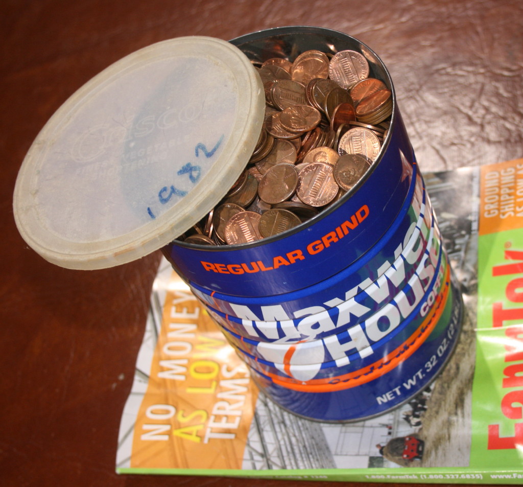

                              Only US 0ne cent minted AFTER 1982 are copper clad zinc, 2.5% Cu, 97.5% Zn.
                              Any minted 1982 and earlier are 95% copper, 5% Sn/Zn.
                              1982 was a year of transition between the two, and I have not been able to find any info on what percentages of each was minted. I have here about 14 pounds of unsorted and ungraded 1982 pennies from change. They can readily be sorted by alloy with a good VLF detector. Out of a random hand full (was 95 pennies) my F75 LTD identified 16 as plated and 79 as solid.

                              • "The nickel bar, I dunno what was going on there."
                                As nickel is ferromagnetic, I guess it's something to do with skin depth, the metals permeability having a dominant effect.
                                From wikipedia 'Skin effect' page:
                                Skin depth also varies as the inverse square root of the permeability of the conductor.
                                In the case of iron, its conductivity is about 1/7 that of copper. However being ferromagnetic its permeability is about 10,000 times greater. This reduces the skin depth for iron to about 1/38 that of copper, about 220 micrometres at 60 Hz.
                                Iron wire is thus useless for AC power lines (except to add mechanical strength by serving as a core to a non ferromagnetic conductor like aluminum). The skin effect also reduces the effective thickness of laminations in power transformers, increasing their losses.
                                So at 60kHz, your nickel sample is appearing too thin to register.
