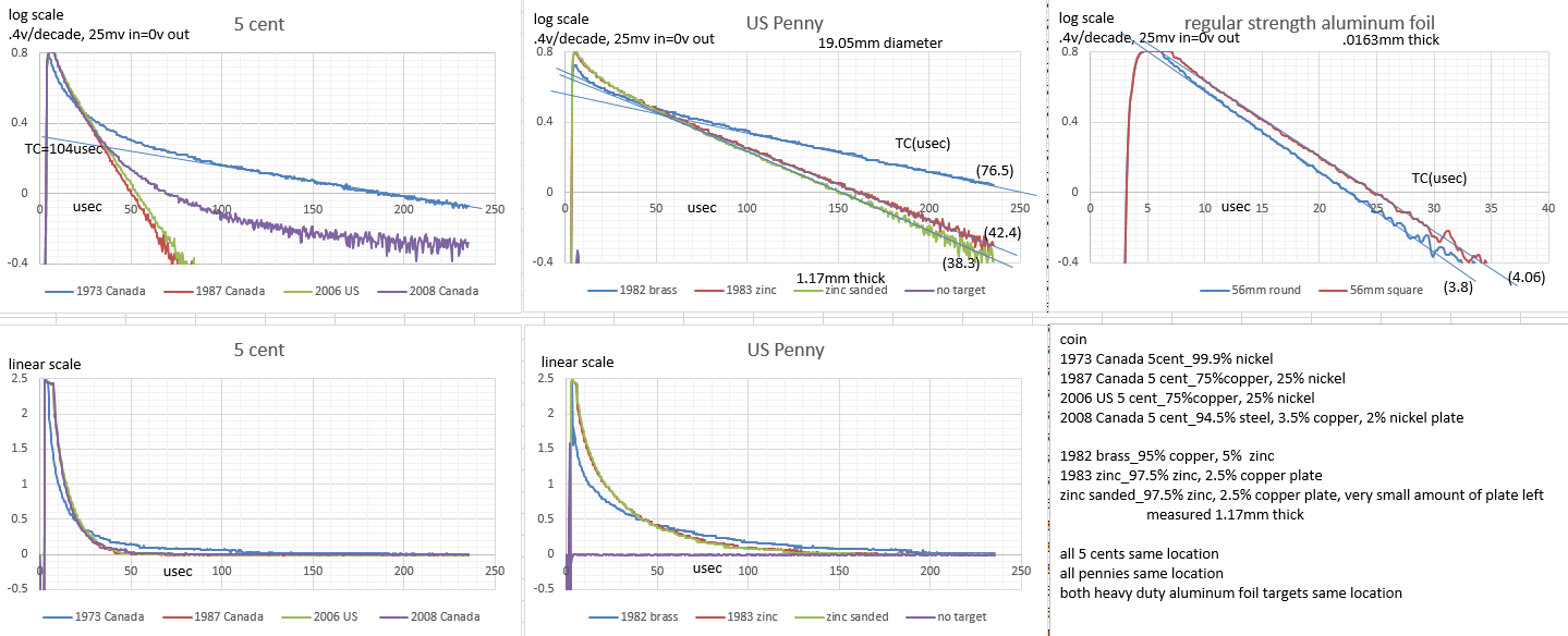

            I had round and square closer the last time I tried, tried again today with a larger target. Like .061 for round and .065 for square. Tried a zinc cent, plain and sanded to see if it made a difference(about the same). The sanded thickness measurement works better when calculating TC. Carl had a 99.9% nickel test target, did a test with some 5 cent targets including one with a 99.9% nickel Canada 5 cent.
            Included linear-linear charts to show difference in charting. Looks like straight line decay linear-log after one to two times target TC. Don't know if the 2008 Canada 5 cent ever straightens(steel). Didn't know if the 99.9% nickel would?
            Sanded penny. No copper on outer diameter, couple small spots towards middle.
            Used Tx_4msec constant rate.

                  • Quote:"Tried a 'zinc' cent, plain and sanded ..... The sanded thickness measurement works better when calculating TC."
                    That was one of the problems I had when trying out the TC formula on coins - determining the thickness. You can't use the 'official' figure, because it's the maximum thickness. And if you use a micrometer on the face, you get a variety of readings, of course. So I ended up using the weight, the density, and the diameter to calculate the mean thickness of any given coin. It seemed to work well. Sanding down the coin makes thickness much easier, as well as removing the thin copper layer. I haven't tried it, but I assume ferric chloride ( PCB etchant) would remove the copper without affecting the zinc ? ... should this be of any scientific use.
                    I was just looking at your foil decay chart ( round and square shape) and the figures don't seem to match up with the 'TC formula' . As you're fond of foil, I assume you've measured its %IACS figure ? It should be fairly easy, as cooking foil comes in large sheets. I haven't done it yet, only for the thicker foil used in food trays ( 55 / 56% ).

                        Measurement today: Aluminum foil. (Wiki) regular .016mm thick, heavy duty .024mm thick. My micrometer has .001mm resolution, need at least a reading of 100 so I folded a piece 3times for 8 layers. Regular strength 138/8=17.3mm. Heavy duty 195/8=24.4mm.Is there a more accurate way to measure foil thickness? Haven't measured foil DC resistance. My multimeter, .01mv resolution .06%reading+-2 count. .01ohm resolution .3%reading +9 digits. Thinking at least 5mv reading across foil sample. If math is correct, regular foil 1cm wide, 1m long about .166 ohms. Need 30ma. 400ohm resistor in series with foil across 12v. R=E/I, R=V across 1m foil/(V across resistor/resistor ohms). Aluminum resistance increases 1% every 2.3deg C. Should I correct for temperature? Haven't been with most of the charts. How to cut foil 1cm width to +-.1mm? Need to measure across 1m length, how much longer does foil need to be to connect to circuit. I've made a lot of measurements strain, torque, temperature, speed, force are some of them. Just guessing the best procedure to use for these measurements. Any thoughts or suggestions?
                        Didn't measure foil thickness in reply #260. Cut targets from a piece I thought was heavy duty, the charted data matched regular strength so I used Reynolds aluminum foil thickness.
                        Haven't been listing ambient temperature on charts. Probably should since my ambient in the garage can change some. A few % change in target TC would make a difference when calculating multiplier or %IACS. Probably not to important for detecting, just when trying to understand why.

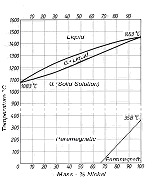

                                ... Interesting thing about nickel being ferromagnetic. A US nickel is 75%Cu and 25%Ni and yet has no magnetic susceptibility as measured on the Bartington MS2. I read somewhere that there has to be more than 56% nickel in an alloy for ferromagnetic properties to appear. I don't have any more details on this at present.
                                Eric.
                                Thought this might be of interest to you regarding CuNi alloys.
