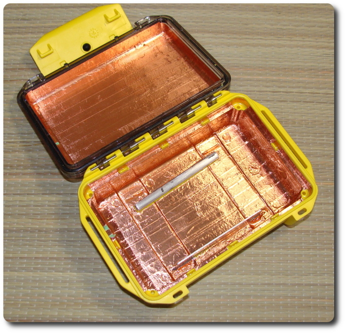

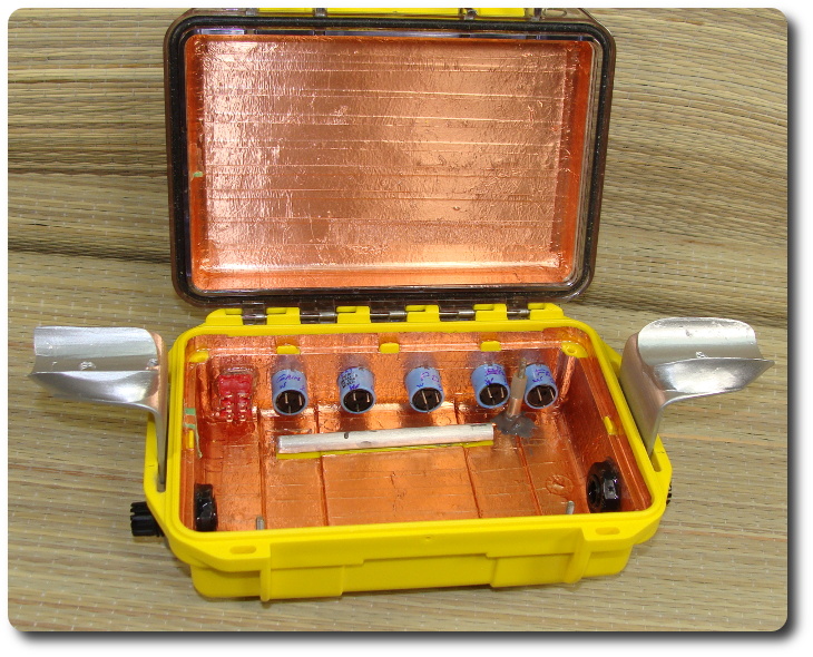

    My surf pi is very stable on most beaches but when im on my local beach where there are amusement arcades nearby...my detector becomes very chattery....what can i do to get rid of this problem ???? would screening the pcb stop this ?????

        Try a simple fix first put your PCB in a metal box.

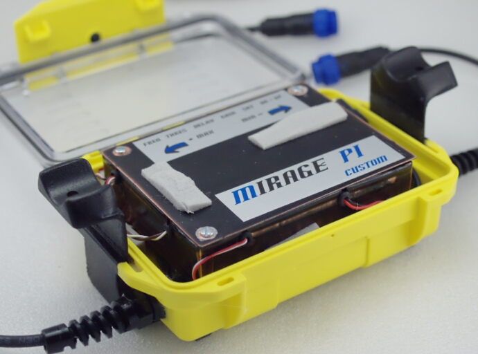

            Originally both my land and water PI units were housed in plastic boxes, no shielding.
            Then decided to try something different after seeing an Eric Foster water machine. Inside the plastic box was a metal box that enclosed the PCB.
            Gave me and idea to line my box with copper foil tape with conductive adhesive, the two coats of epoxy, solder a wire to the lid and inner box and ground the wires to the PCB.
            It definitly has helped.
            My latest build I built an internal copper box, using copper clad PCB boards.

              i will try and use aluminium foil and hopefully this will reduce the chatter....do you think having a frequency offset control helps ???? i very much like your yellow box !!!! ive never seen these boxes in the uk....im thinking of using metal box in my next project...its only a certain part of the beach that i have this problem which is close to amusement arcades....other parts of the beach very stable threshold.
                My land units all have a metal box.
