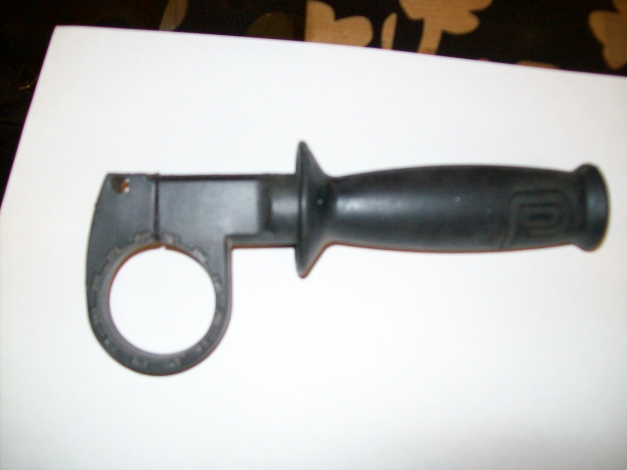

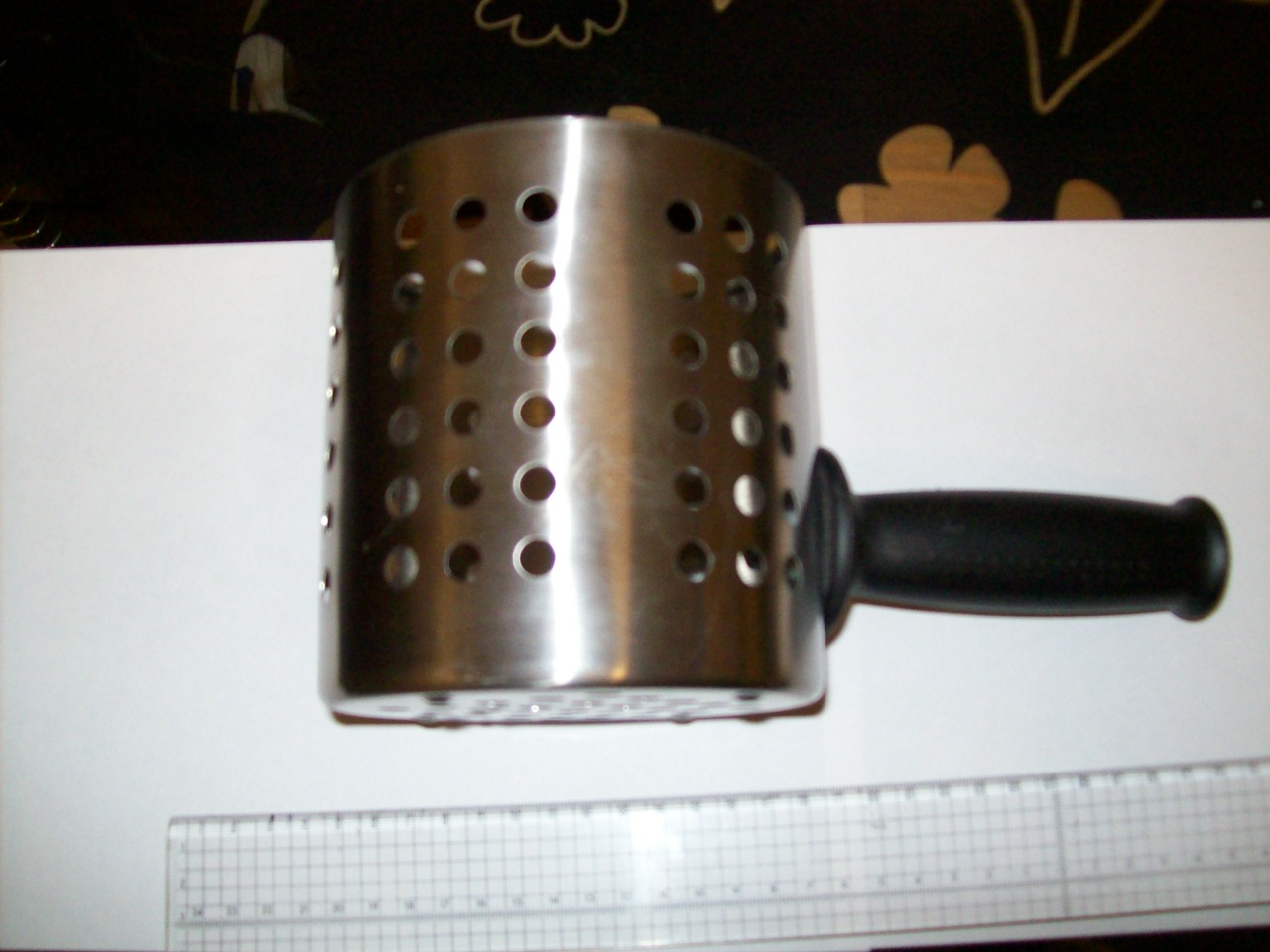

              dave go to asda and buy a utensil strainer for 3 pounds(stainless steel), raid an old drill for a screw on handle,like this, then remove this part,just unscrew the bolt in the handle,

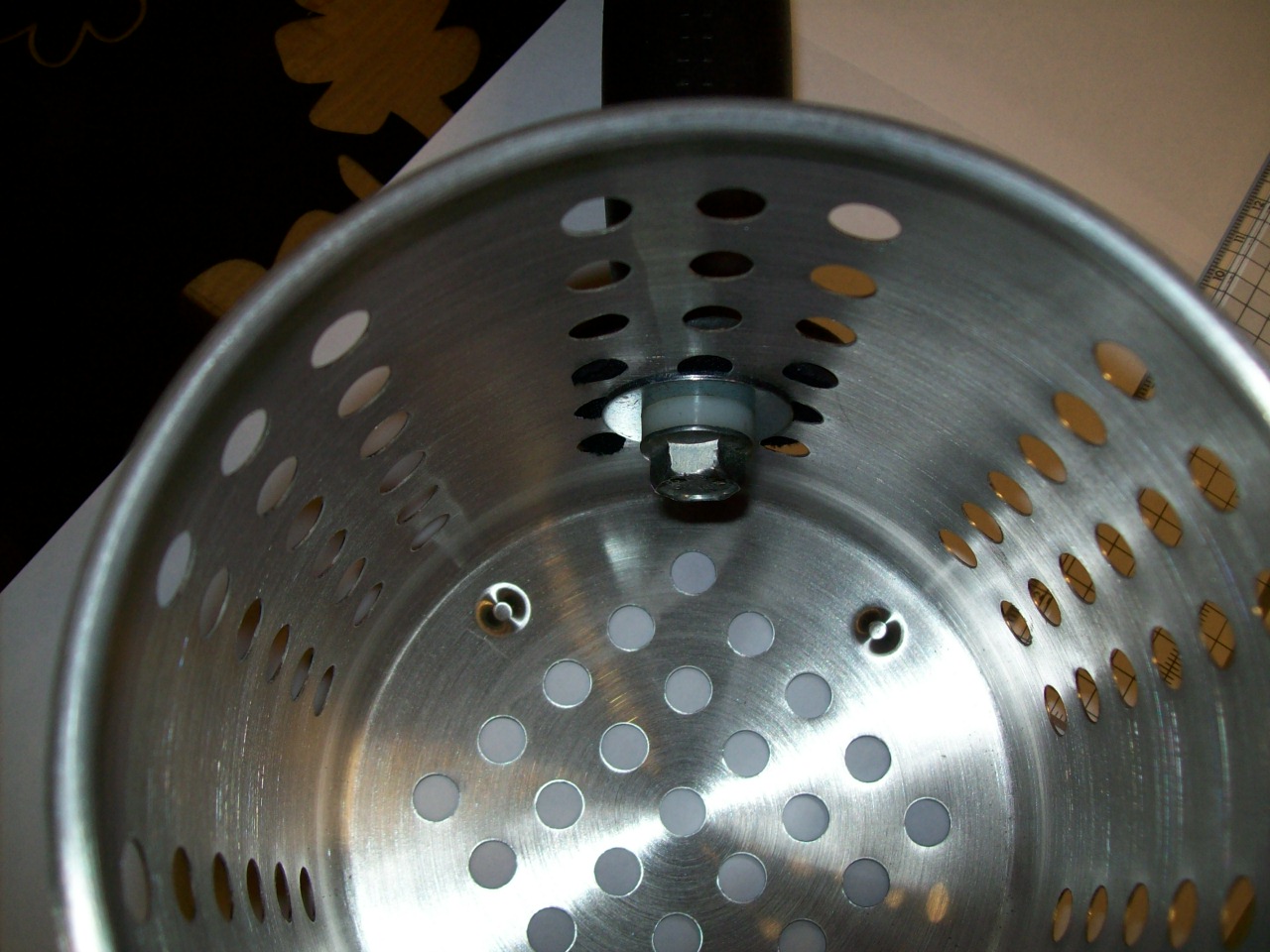

              add a large washer inside the strainer, and insert the bolt through this washer and one of the holes in the strainer,like this, put another washer on the outside of the strainer, then screw back on the handle nice and tight, like this, and you should have this.
              this is completeClick image for larger version

                  dave go to asda and buy a utensil strainer for 3 pounds(stainless steel), raid an old drill for a screw on handle,like this[ATTACH]29813[/ATTACH], then remove this part,just unscrew the bolt in the handle[ATTACH]29814[/ATTACH],
                  add a large washer inside the strainer, and insert the bolt through this washer and one of the holes in the strainer,[ATTACH]29815[/ATTACH]like this, put another washer on the outside of the strainer, then screw back on the handle nice and tight,[ATTACH]29816[/ATTACH] like this, and you should have this[ATTACH]29817[/ATTACH].
                  this is complete[ATTACH]29818[/ATTACH], you may have to buy a bolt the right thread, as some are not threaded all the way down, but it works, you can use it as a hand scoop, or put a long handle inside the drill handle to save your back, total cost 5 quid.[ATTACH]29819[/ATTACH]
                  dont know why the last pic is the only one that worked, but you get the idea[ATTACH]29820[/ATTACH]
                  thats a very good idea but i would need a long handle as i want to use with my foot....looks good in your photo
                          the centre of the drill handle is hollow i made a strong stick that slots in, but i use it as a hand scoop most, though its plenty strong enough with the long handle.
