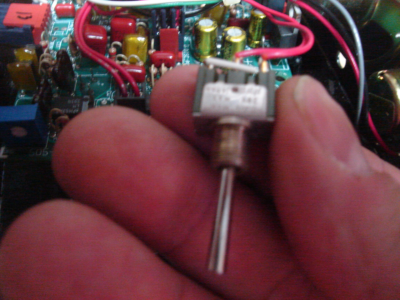

    Not sure how old this unit is but I have two quick questions for any of you whites coinmaster classic II owners/gurus, On the control box is a 3 way switch, it has "reset", "all metal mode" and "lock".
    Is this switch an On/Off/On Momentary type of switch?

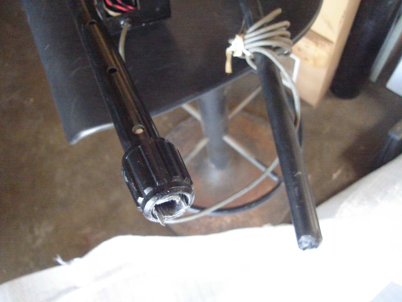

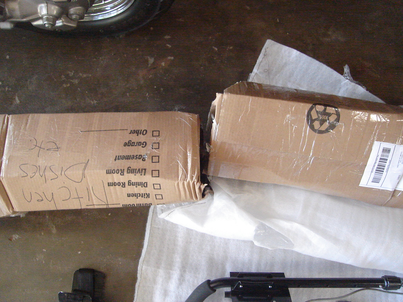

    Well, it doesnt work and I know for a fact now it didnt when he shipped it either... The lame arse took and pieced together boxes to ship it and it came apart during shipment. He left the lower shaft with coil installed and in the upper shaft and shipped it in an operating type position, so the shaft was broken in half when the mailman and I pulled it out to check it.... Some people amaze me with there stupidity and their tenacity to lie and try to cheat others.....sorry for the mini rant, just a little pissed at the moment...
    Anyhow, the 3 way switch is broken and I am thinking when clicking over to use the "reset" it would be a momentary type of switching.

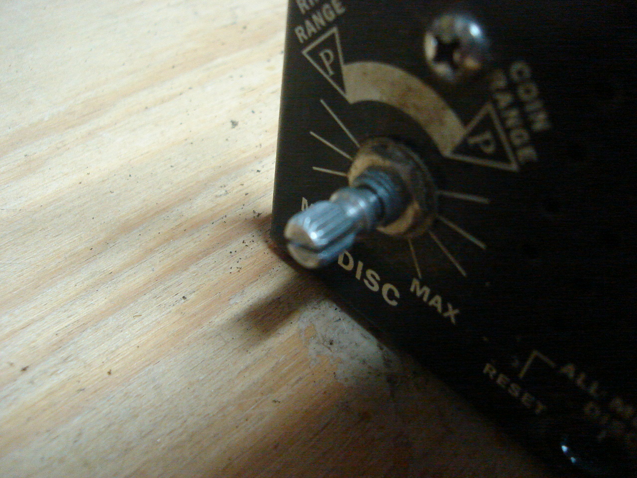

    Also on the discrimination pot, it doesnt feel right at all to me, lumpy and rough to turn so I am going to replace it as well, it is a 10k pot but the one on this unit seems to pull up (or out) to lock and push in to turn. Anyone know what type of pot that is or what its called so I can find one to replace it with or will a standard 10k pot work ok?

      "Is this switch an On/Off/On Momentary type of switch?"
      Yes
      Two end contacts wire together and the connected to the board the center pin to the other connector on the board.
      Switches from Disc to All metal one way and quick retune the other
        "Also on the discrimination pot, it doesnt feel right at all to me, lumpy and rough to turn so I am going to replace it as well, it is a 10k pot but the one on this unit seems to pull up (or out) to lock and push in to turn. Anyone know what type of pot that is or what its called so I can find one to replace it with or will a standard 10k pot work ok?"
        Most whites classic have the on off switch on the disc pot. Should be 5 wires. If so any switched pot of the right value should work.

          I figured the 3 way switch had one side as momentary so thanks for reaffirming for me.
          As far as the disc pot, it isn't the on off type, the other knob is on this particular unit. This pot has only the 3 wires so I'll swap it for another 10k since it is trashed.
