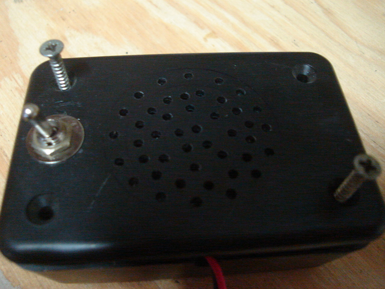

    As you have probably already figured out I am always having a hard time hearing so have been looking
    for a simple way to amplify the sound on my detectors (surf pi and barracuda).
    I like to have a good volume from the speaker mostly because of rattlesnakes where I hunt, dont like having my ears covered just in case but sometimes there is enough of a breeze also that the faint sound from the audio just isnt enough for me to hear since I'm half deaf...lol

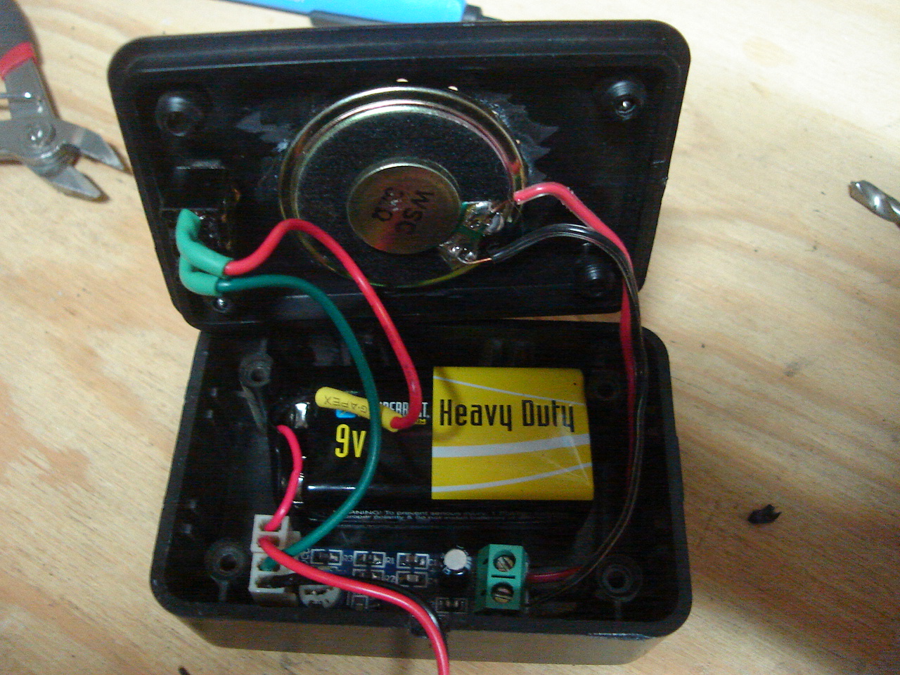

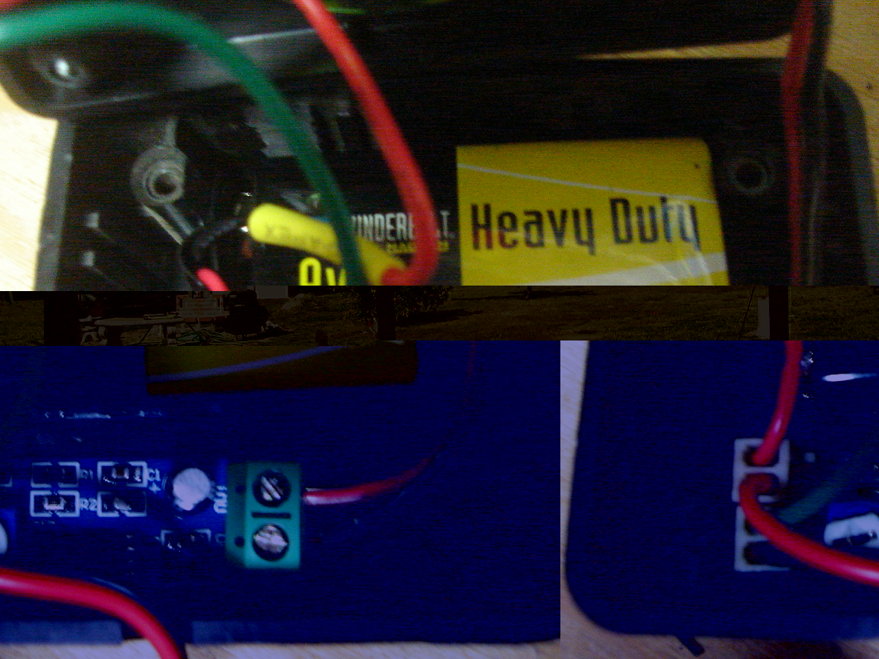

    I have made a few amps from circuits I have found online and have also bought a few off ebay from china, Finally found one that works like a real amplifier and definitively increases the speaker volume 10 fold, it will even over amp them. It has an on board resistance trimmer, which I set at 50% or half way which is good for me. The board is small, 1/2"W x1-5/8 L" and will work from 4.5 to 12 v so a 9v batt works perfect.

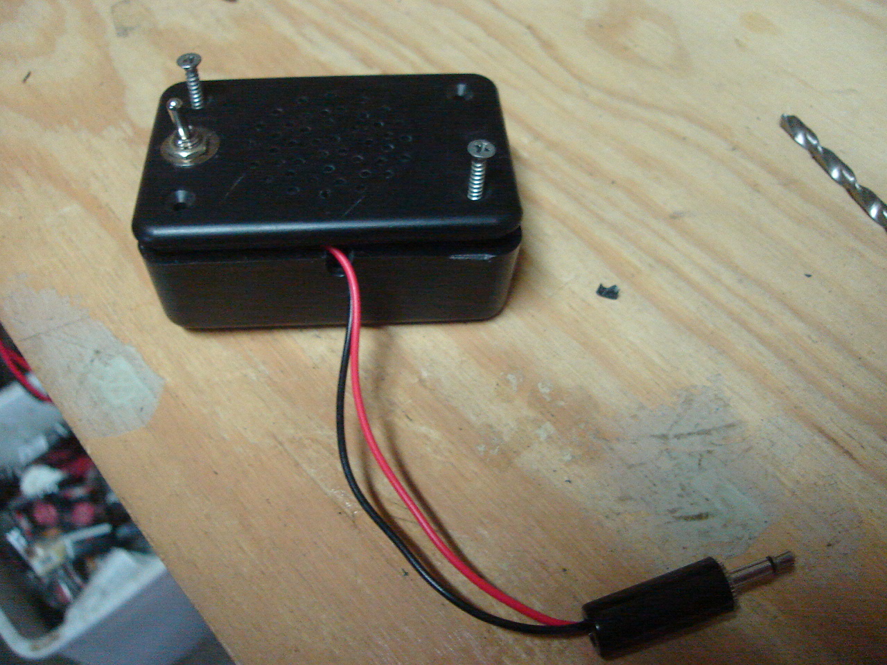

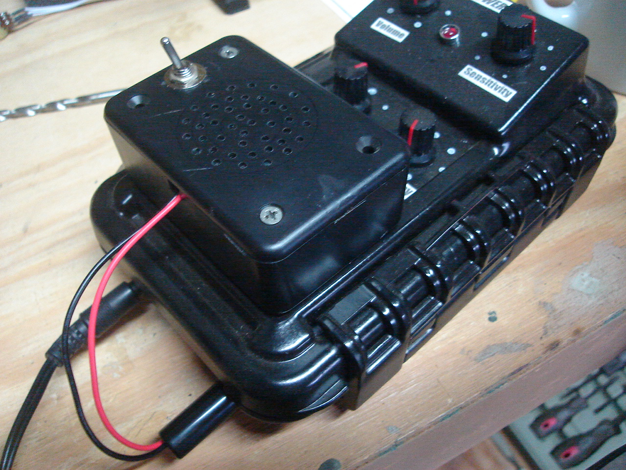

    I built them using a small radio shack box, one for 32 ohm speaker and one for an 8 ohm speaker, that way I have one that will work with different types of metal detectors, like the barracuda with the 32 ohm and my surf pi which has an 8 ohm. Its small enough to fit in a shirt pocket and light enough you wont even know it.
    Anyhow, below are some pics of the 32 ohm unit, which will attach quickly using velcro to the top of whatever detector I'm using at the time.. I thought I'd share because I'm sure there are others that would like a bit more volume when using just a speaker instead of phones. Also added the link for the amps from ebay.
    Link to the amplifiers - http://www.ebay.com/itm/LM386-Audio-...item20cdfddaa0
