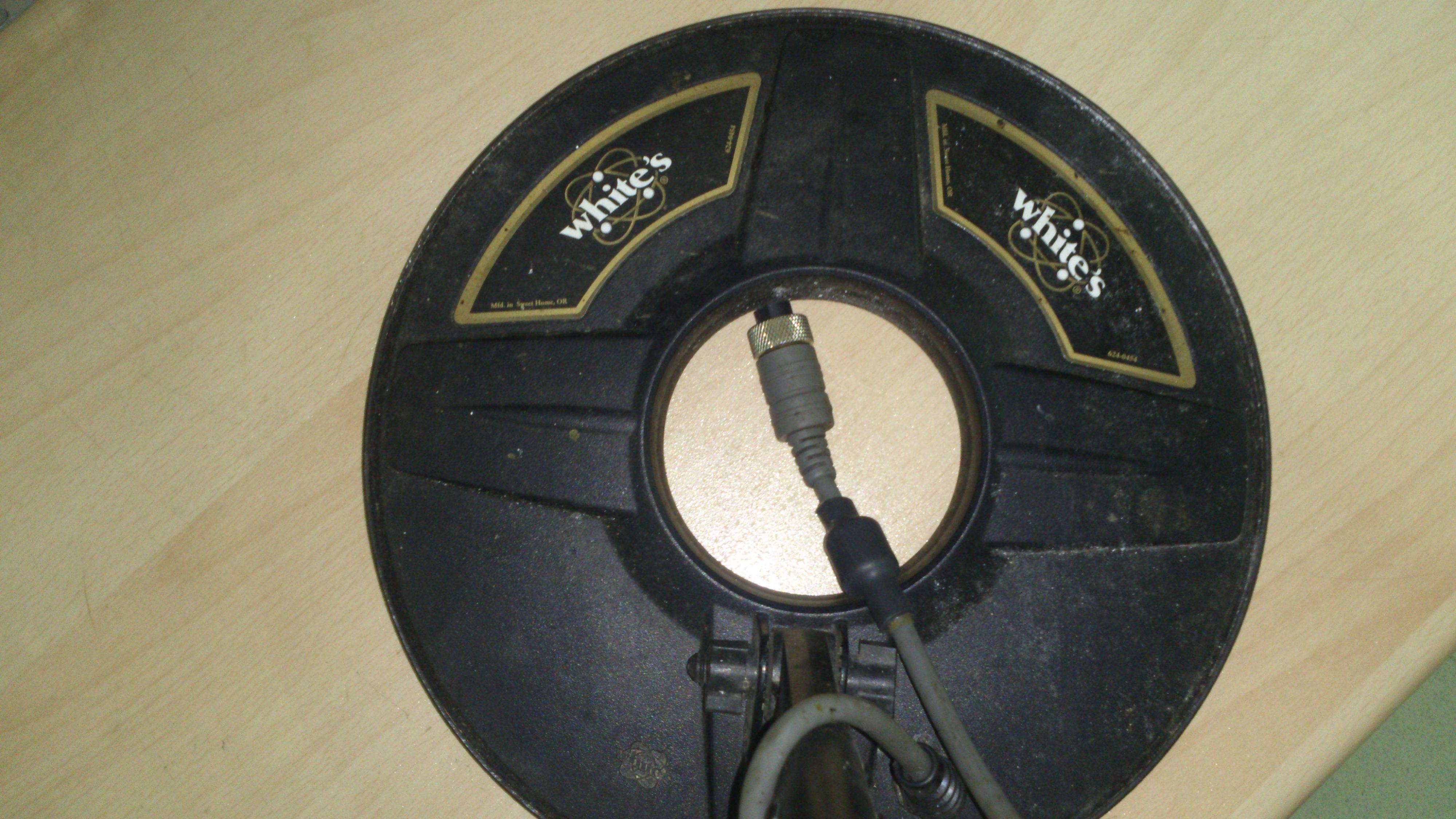

                    Before starting to dissassembly anything, I made some mesurements on the coil pinout.

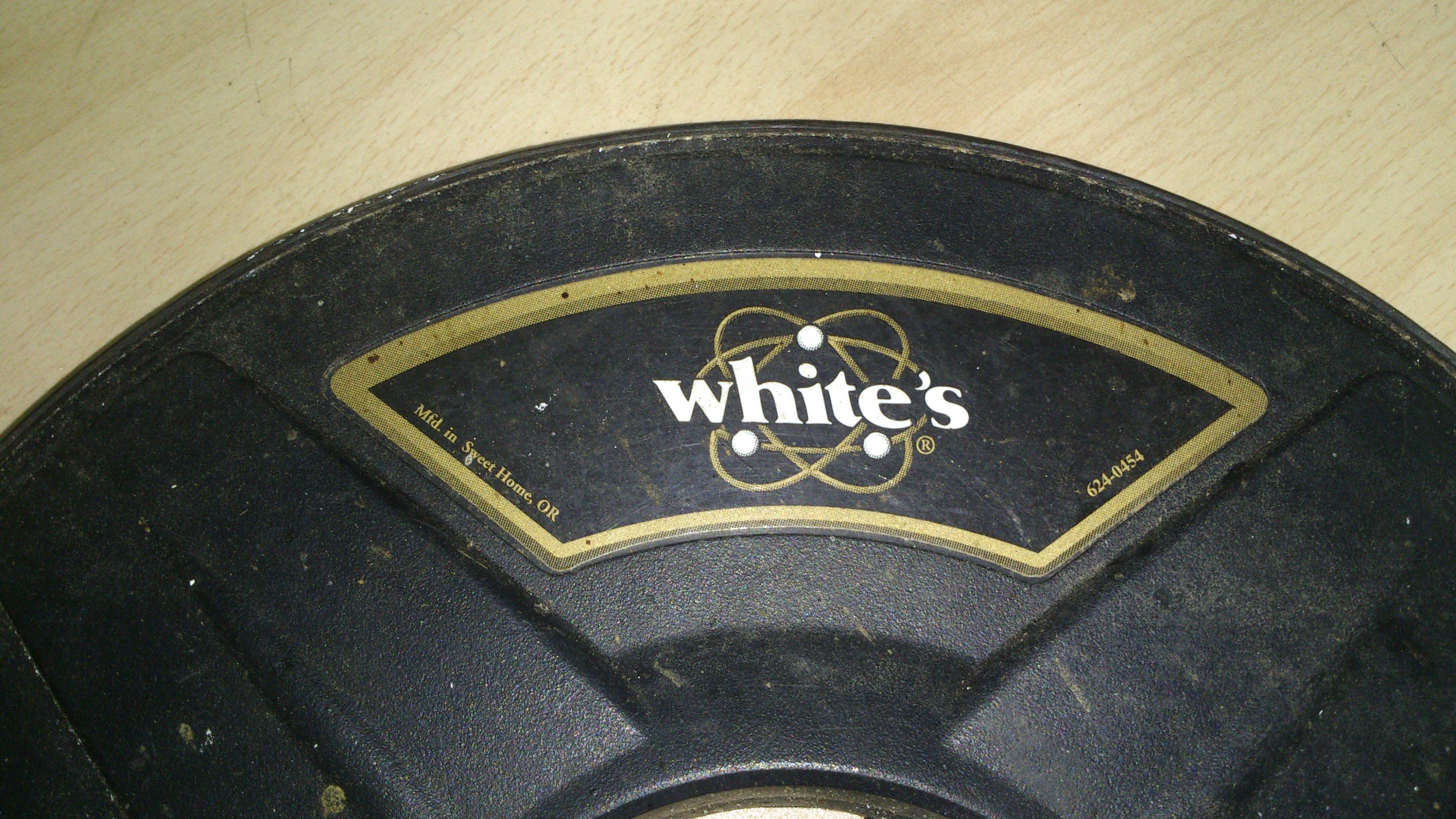

                    Is this the right coil for this detector...??? I leave some photos of the coil
                    Coil:
                    1-2 93.90 homs
                    1-3 0 homs
                    1-4 6.9 Mhoms
                    1-5 6.9 Mhoms
                    2-3 0 homs
                    2-4 6.9 Mhoms
                    2-5 6.9 Mhoms
                    3-4 0 homs
                    3-5 0 homs
                    4-5 1.67 homs

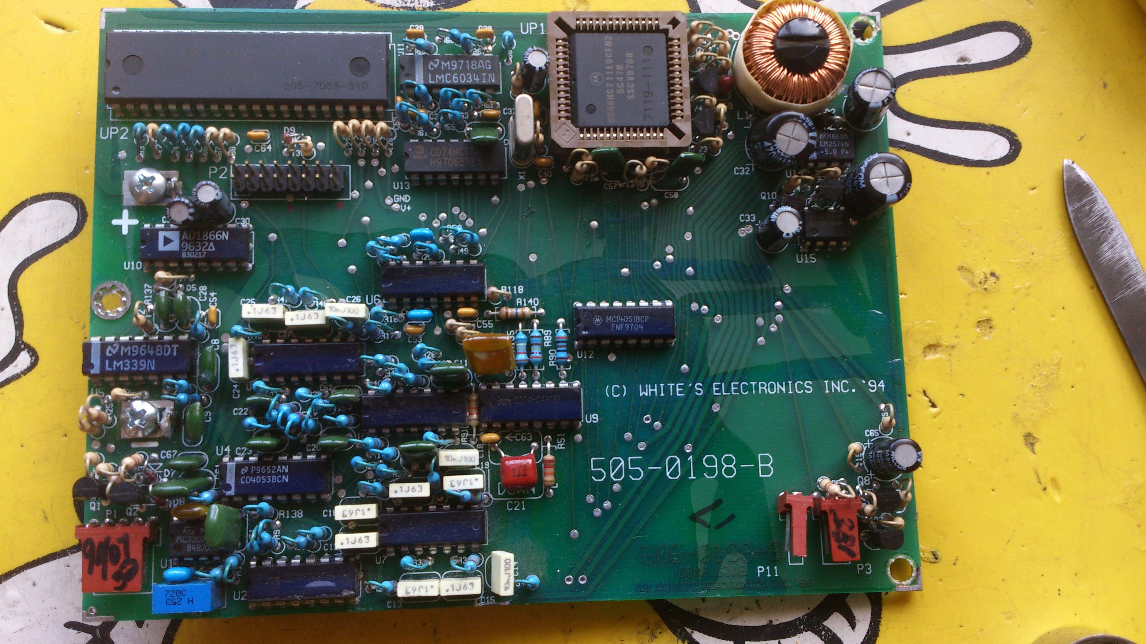

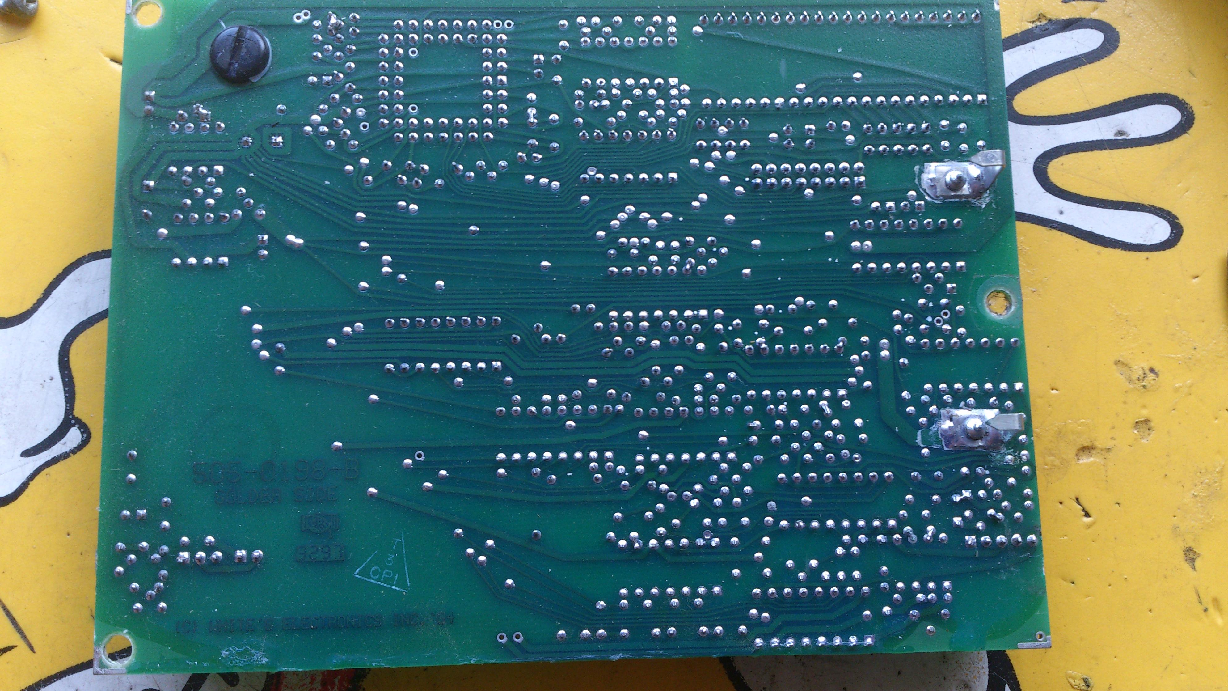

                    I will wait for some ideas, before starting to check bad solder joints broken tracks and high ESR caps
                    Best regards
                      I have checked all cap´s and solder joints and nothing.
                      Looking to it´s average power consumption of 80mA.... it should last for 30 hours of detecting with a battery pack of 2400mA
                      Also some photos of the inner part´s

                        Sounds okay to me
                        Maybe an intermittent fault.
                          just a thought have you tested the volts in side the metal detector are there 12 volts to the board on the battery connections ?
                            Perhaps the detector has a problem measuring the correct battery voltage and is falsely indicating that the batteries are flat.
