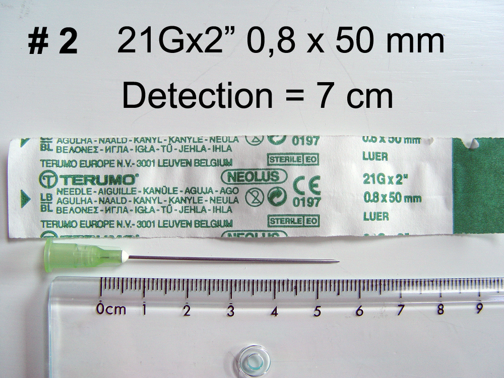

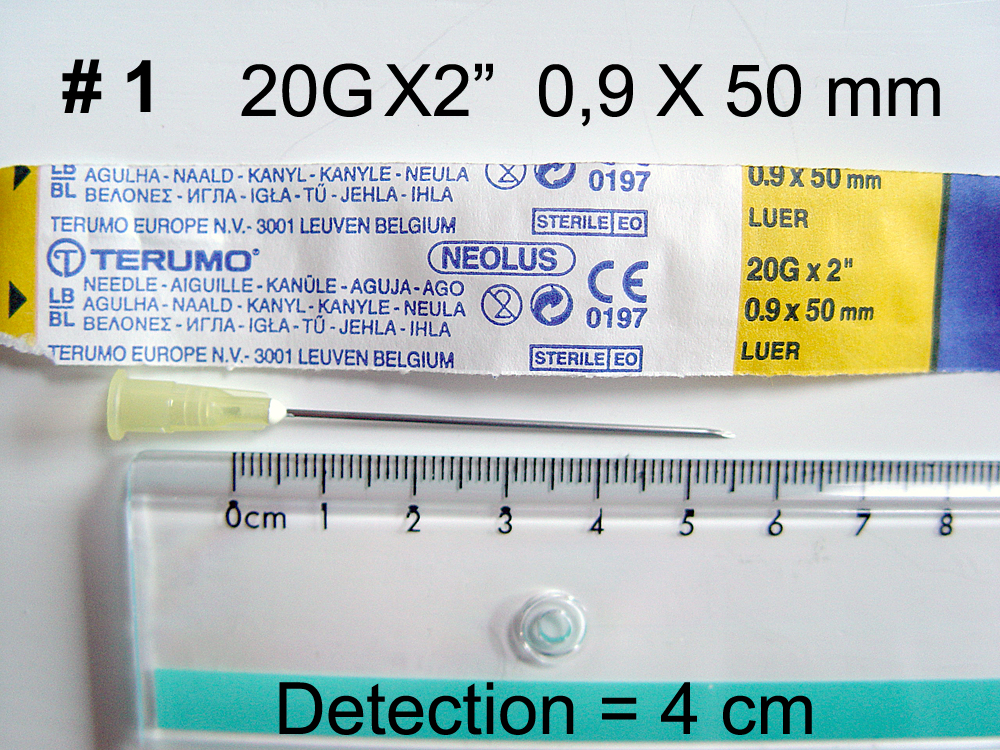

        I could not find the big hypodermic needle. But I have found two other hypodermic needles,
        Which are also interesting #1 and #2.
        The thickness of #1 is larger than that of # 2 but the detection distance is smaller!!!
        So I think the alloy are different.

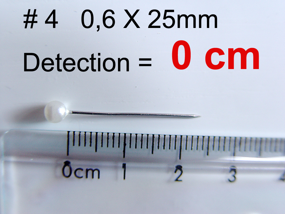

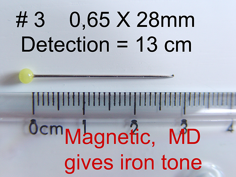

        The most interesting needles are #3 and #4
        as this is the first time that I have a needle that the MD can NOT detect #4. It is not a hypodermic needle but a
        needle that I found in the sewing box from my wife.
          Yes, it depend a lot of alloy used (your comparison between sewing pins #3 and #4 is very significant). Saying only stainless steel is not enough.

              Is your tested sewing pin #3 magnetic ( attracted by magnet)?
                Yes, and the MD detected with a low tone. (iron tone detection)

                  The magnetic needle is shown in the picture # 3.

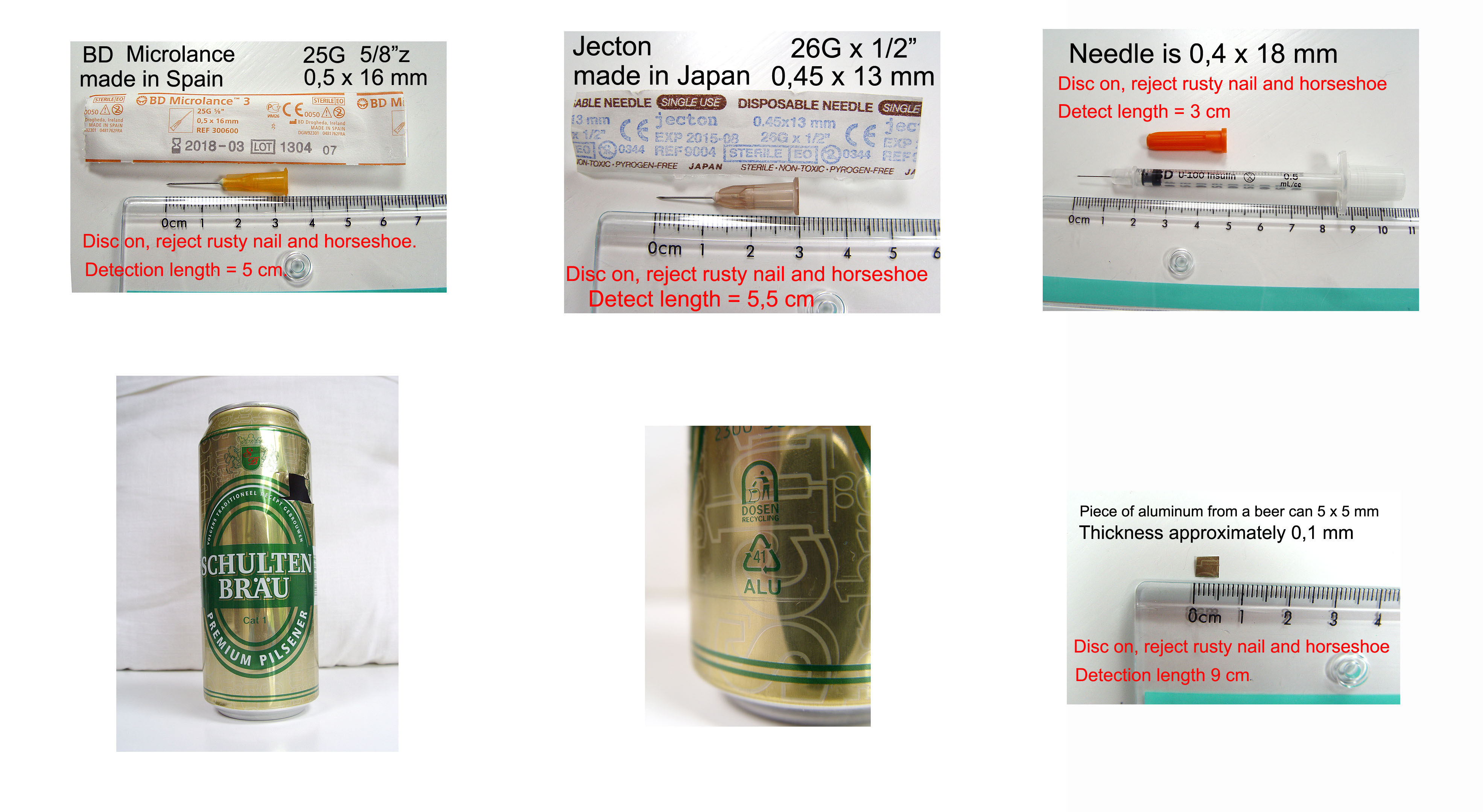

                                Today I bought two new brands hypodermic needles.
                                And have a test done with hypodermic needles and with a piece of aluminum from a beer cans, 5 x 5 mm.
