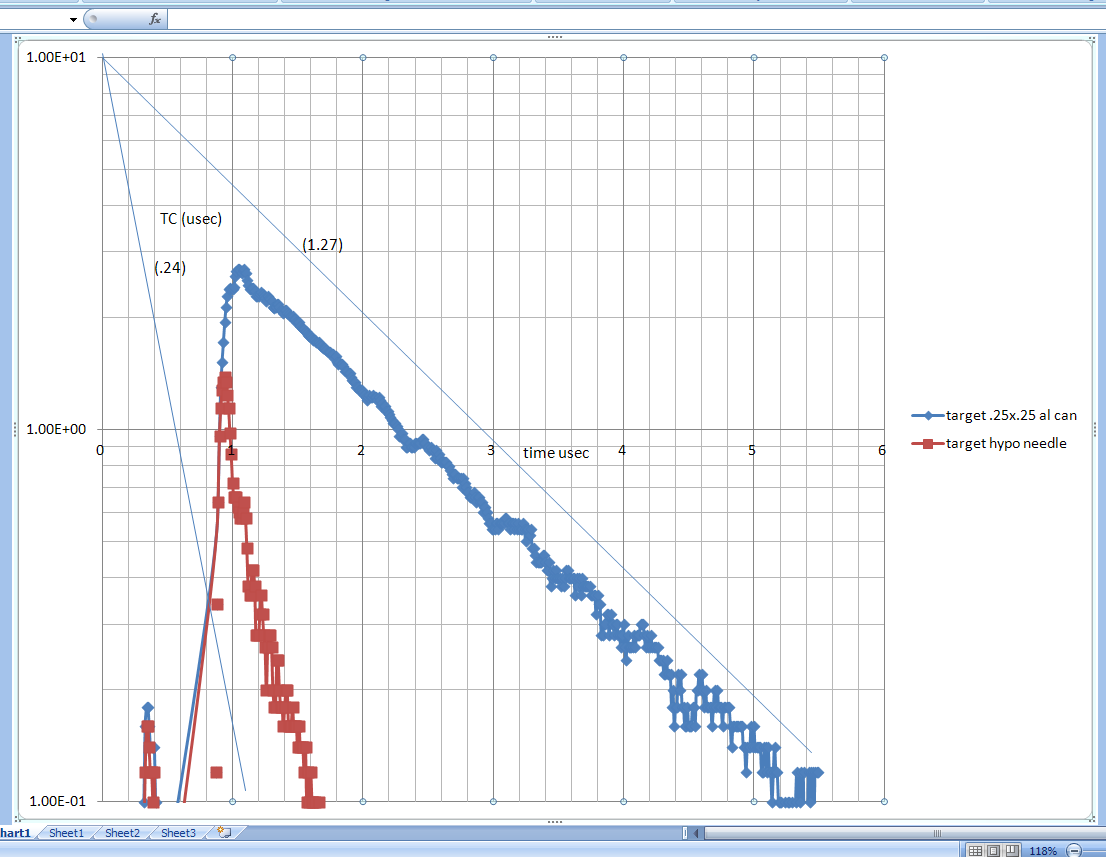

                  I tried plotting the time constant for a hypo needle a while back without success. I made another coil,(single layer,awg 34 magnet wire, 9/16 inch O.D., about one inch long). Got some data this time, .24 usec time constant( .76 mm x 42 mm needle) Don't have any information on it, need to get one of the test needles. Data is a plot of target recording - reference recording. Had to poke needle inside coil. Sure would like to know how Nupi detects the needles.
