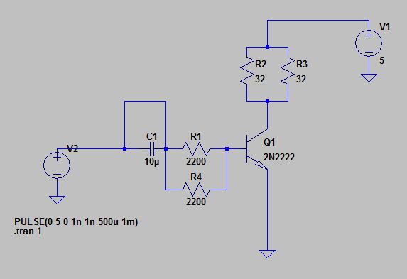

                  Given that the pin is configured as a digital output, a single BJT can be used to make a zero quiescent current, 0.25W amplifier for headphones that will be loud enough for anyone:
Name:	0.25W digital amp.JPG
                  R2 and R3 are the headphones themselves. R1 and R4 are onboard. C1 should be removed / bypassed. And any small signal NPN transistor will do.
                  Use headphones with a built in volume control or insert a 100 Ohm variable resistor between the headphones and the transistor's collector.

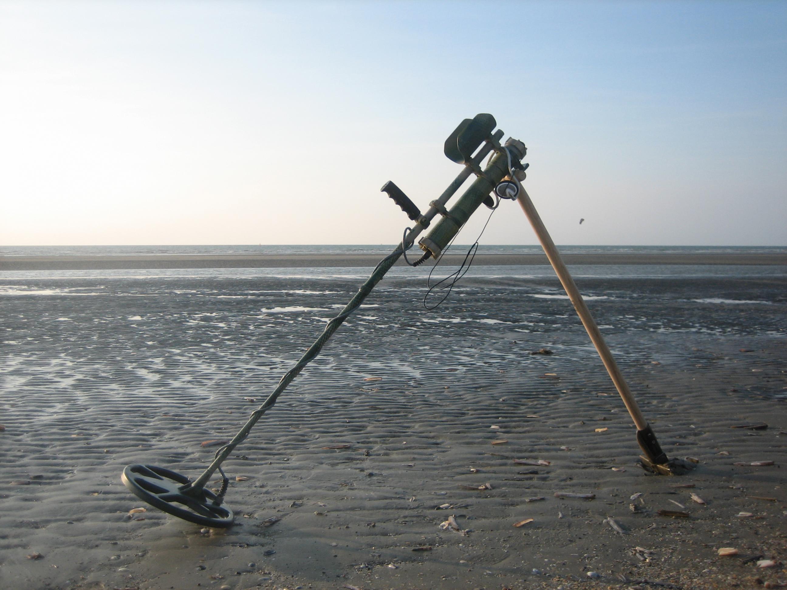

                                I have been searching this weekend at the Belgian beach with this version:
                                Finds: - no pictures - but pretty much always the same things here:
                                - a lot of alu / steel tent / wind shelter pegs
                                - beer caps --- lots of different kinds here in Belgium !
                                - small euro coins 1/2/5 cent -- these are made of iron with a thin copper layer and are discriminated by VLF detectors
                                - fishing gear
                                - WW2 cases and bullets
                                - hair pins
                                - ear rings
                                - and fortunately: some new 1 and 2 euro coins left behind after a sunny weekend at the beach: enough to buy a beer / ice cream
                                So, the beach/dunes are clean once again - I dump all the trash in the bins.
                                Someone else with experiences / photos ?
