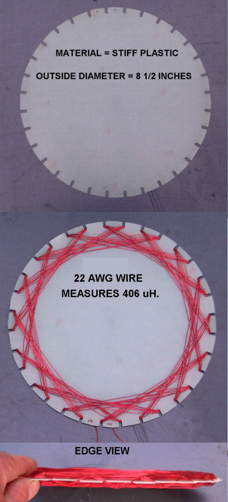

                          Well enameled copper is part of the problem. You want low capacitance via spacing
                          between wires and the enamel allows them to be close. Teflon covered wire is better
                          but you could make a basket type coil with the mag wire;

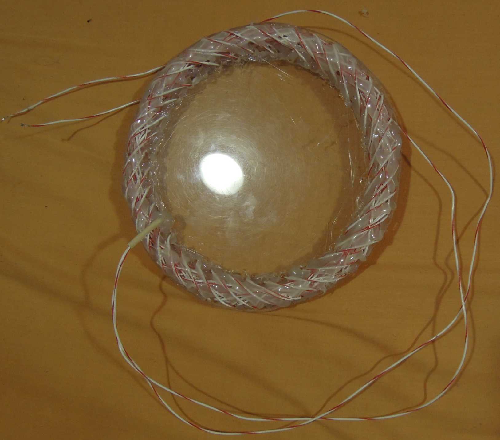

                            Hello again,
                            I've followed Tepco's post and tried a PVC insulated cable coil. I wanted to do a 30 turn coil but i quickly ran out of cable and only made it to 25 turns.
                            Here is the second coil i've made: http://i.imgur.com/eIrzsbQ.jpg
                            And here are it's specs: 0.9 ohm, 25 turns, ID 125 mm, OD 205 mm, double 0.25 mm copper (wired in parallel).
                            Damping resistor gets warm and i can now use the full trimmer range of the delay with the best results close to the full clockwise regulation.
                            [ATTACH]30937[/ATTACH]
                            Thank you for your reply.
                            It looks very interesting but a search for "basket coil" in the forum brings only indirect threads and it's hard to find a thread dedicated to the subject.
                            Do you know where i can go and read on the subject? I need some guide lines. How do i calculate it's inductance? Do i make an aproximation on it's diameter? Has anyone made a successful basket coil for this project? If so, what kind of specs should i go for?

                              Here's some info I have found in various places;
                              I wound a teflon mono coil then reused the wire to make a basket (same length ~ 65 feet for 300 uh).
