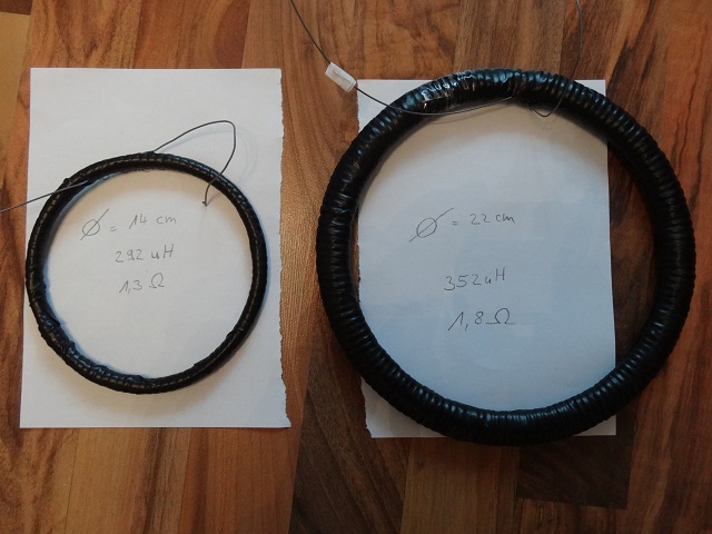

    I wound a teflon mono coil then reused the wire to make a basket (same length ~ 65 feet for 300 uh).

    Quick update, I made one of those coils. 205 mm OD, 195 mm ID, 30 turns, 0.5 mm enameled copper wire, 1.9 ohm. I believe the pdf says 317 uH, which sounds appropriate.
    Here is a pic: http://i.imgur.com/J7zPsl1.jpg
    I'll be testing it tomorrow

      Nice coil wasp. How did you made your winding patern? And what is the material?

        Just tested the latest basket coil, after tuning it i can get a faint signal on the very thin gold ring and copper block at about 20 cm with the threshold a bit high. Can easily pick it up at 15 cm even with the threshold in the minimum. I also tested a soda can (a steel one) with a clear signal over 40 cm.
        I think for a smaller diameter coil, it's a pretty good result and very close to Nezocas results. Hopefully with a shielded cable (from coil to board) i can get an even more stable signal and/or better result.
        Thank you!

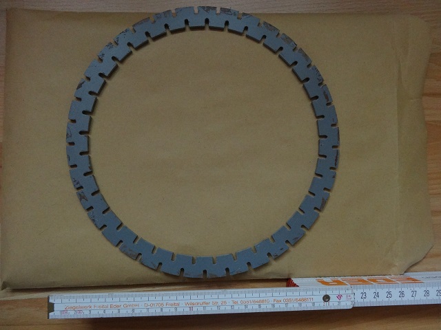

        I followed the instructions that Silver Dollar gave me in his last post (Coil howto.pdf). It was pretty simple, i printed the pattern linked in the pdf file, cut it and glued it to a paint bucket lid (it's plastic, feels like PP). Cut the plastic until i had the ring, made the notches with a dremel and a thin cutting disc, removed the glued paper pattern and started coiling like in the instructions.
        Have some pics:
        Plastic ring http://i.imgur.com/k6Nz1SN.jpg
        The other side had the pattern glued: http://i.imgur.com/nTUxeFd.jpg
        After cutting the notches: http://i.imgur.com/XysUCZC.jpg
        Pattern removed and coiled: http://i.imgur.com/J7zPsl1.jpg
        Cheers,
        Wasp
          Nice pictures. I got my last pattern from a friend. He milled it with cnc milling cutter.
          But your idea is much cheaper and easier to handle.

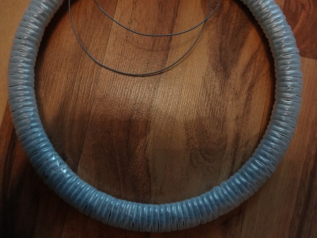

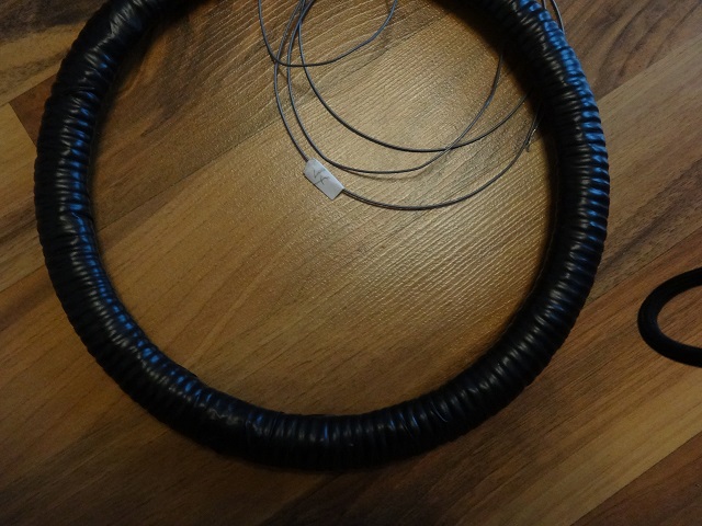

            I've followed Tepco's post and tried a PVC insulated cable coil. I wanted to do a 30 turn coil but i quickly ran out of cable and only made it to 25 turns.
            Here is the second coil i've made: http://i.imgur.com/eIrzsbQ.jpg
            And here are it's specs: 0.9 ohm, 25 turns, ID 125 mm, OD 205 mm, double 0.25 mm copper (wired in parallel).
            Damping resistor gets warm and i can now use the full trimmer range of the delay with the best results close to the full clockwise regulation.
            I'm using a thin gold ring as my smallest detection target and a 150 grams copper block as my biggest detection target (i'm assuming anything in between in size/volume can also be detected). It can detect them both at around 15 cm max which i think is an improvement from the first coil.

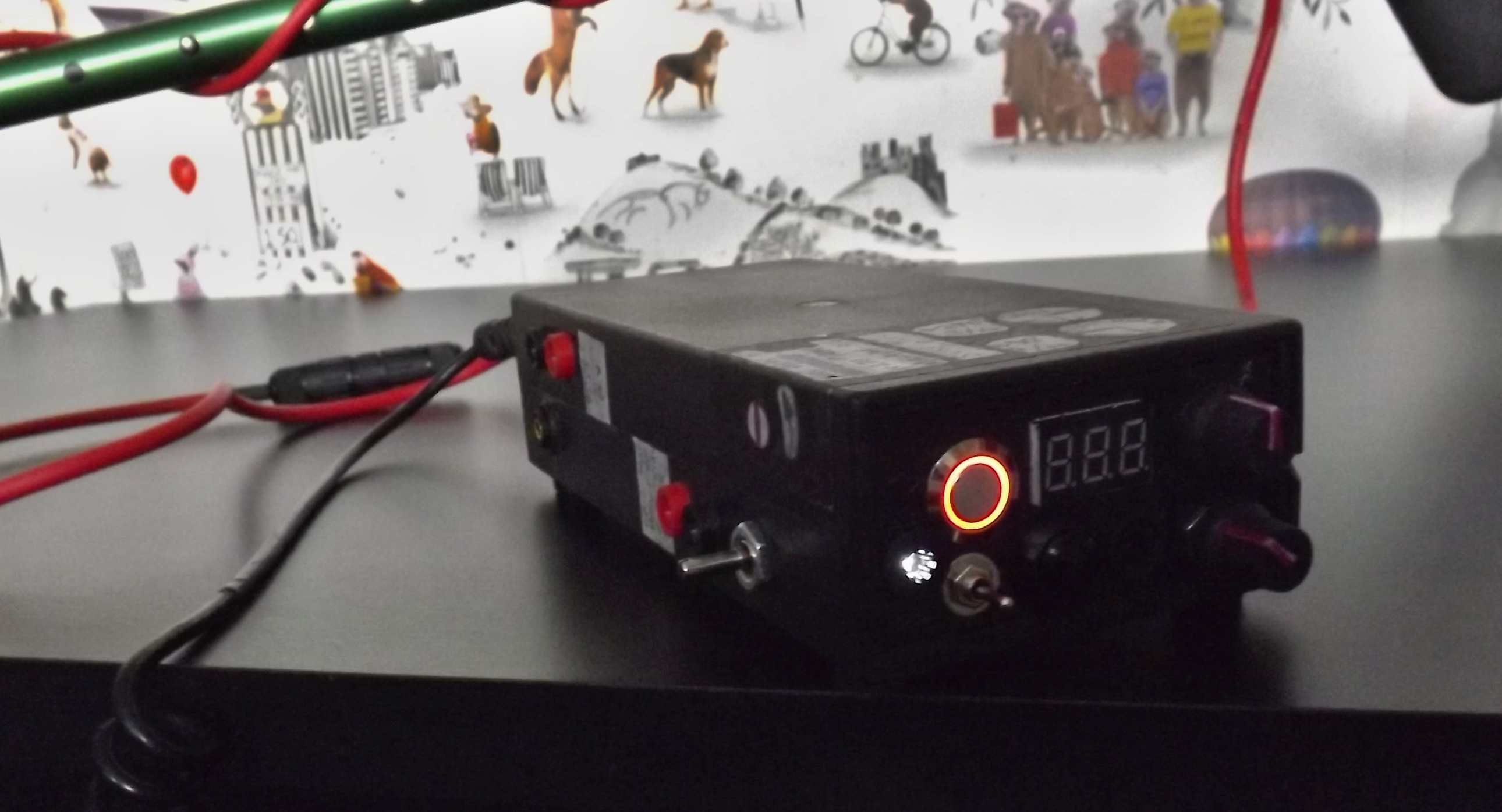

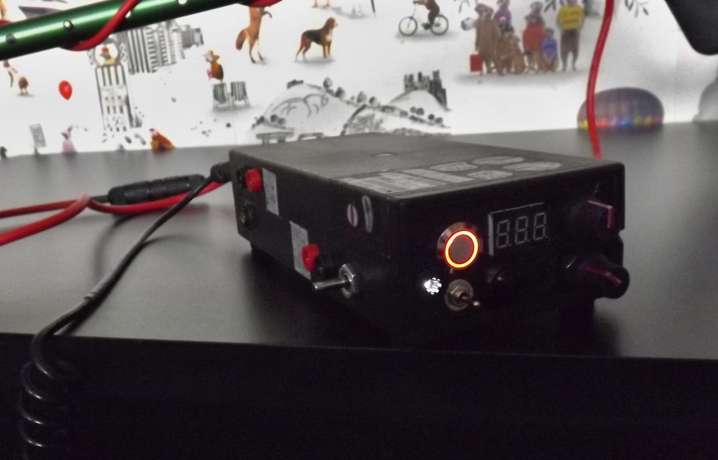

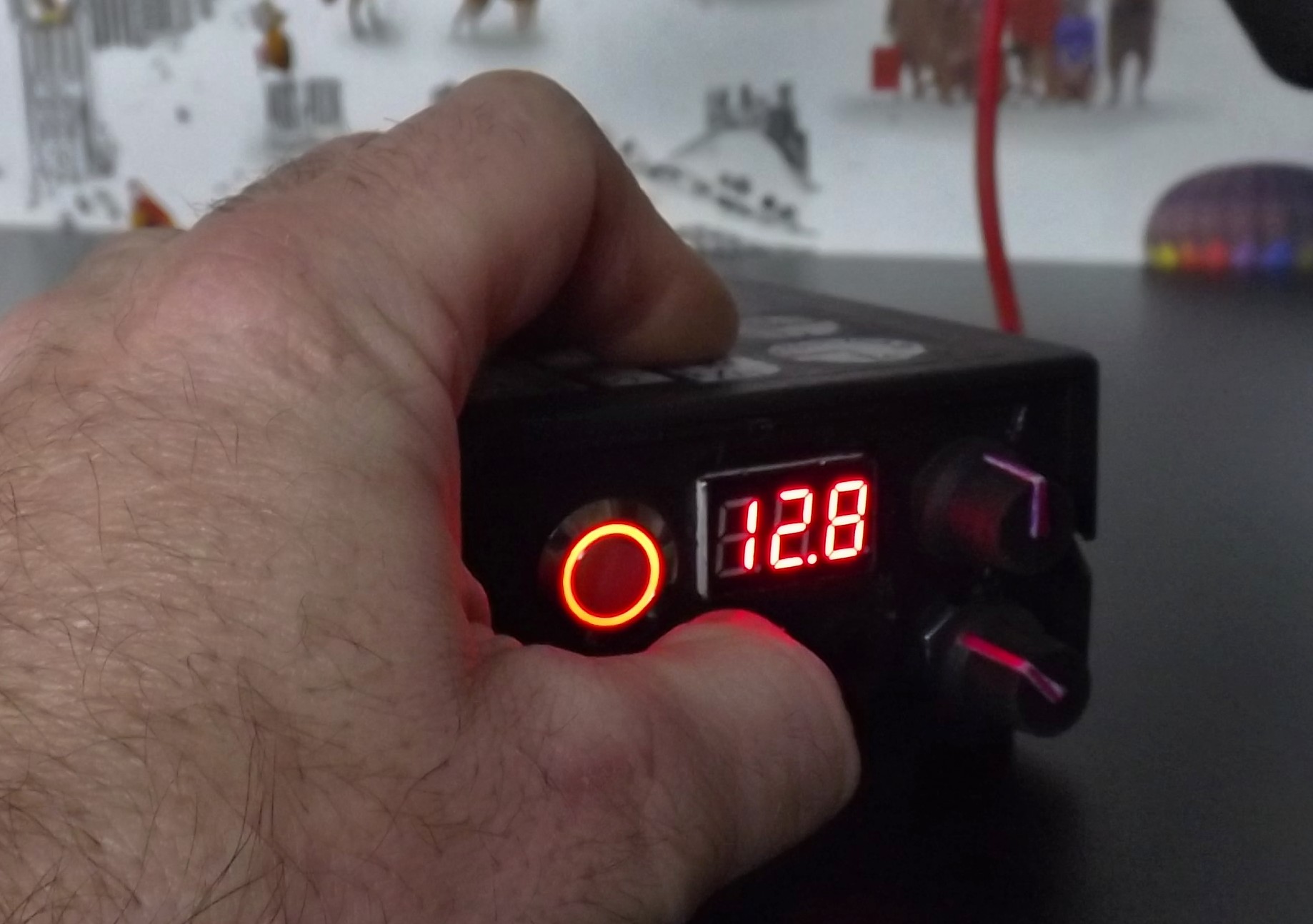

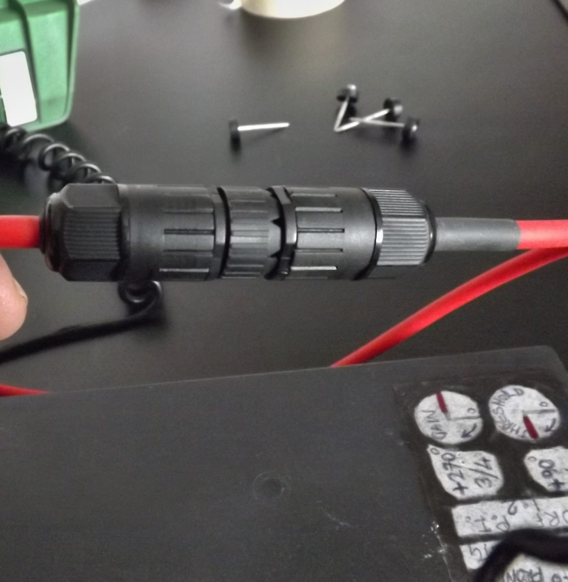

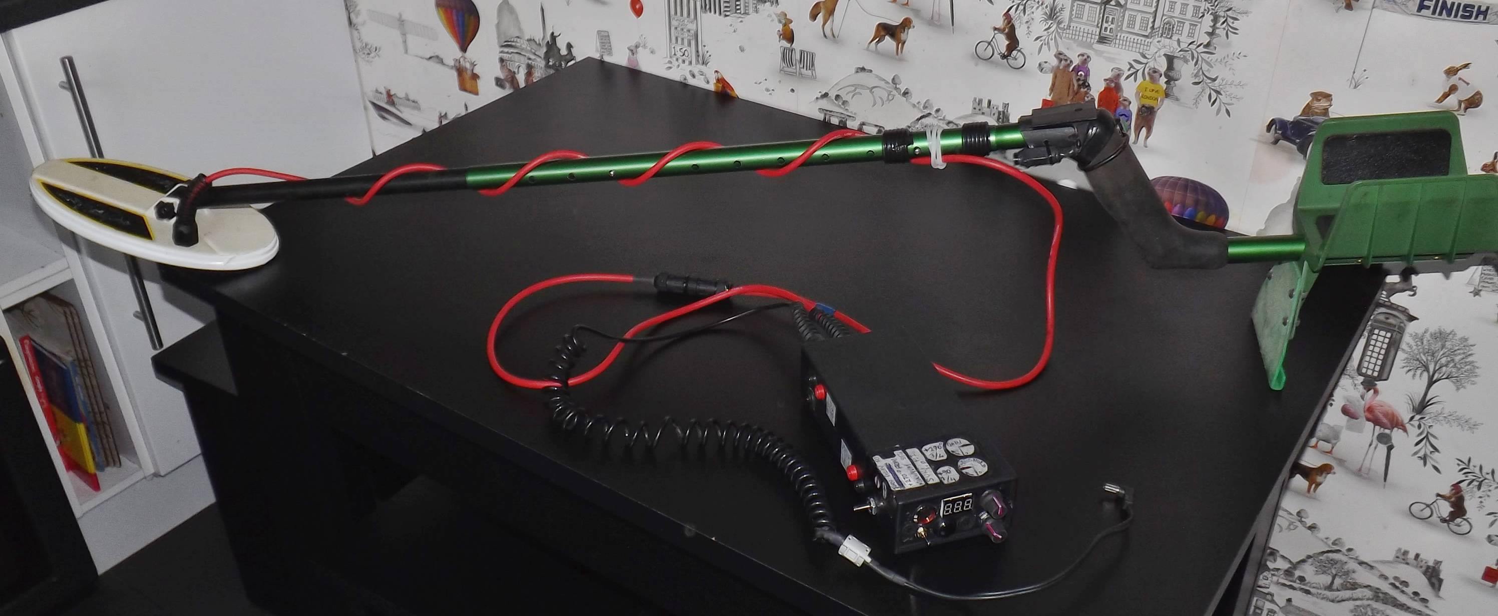

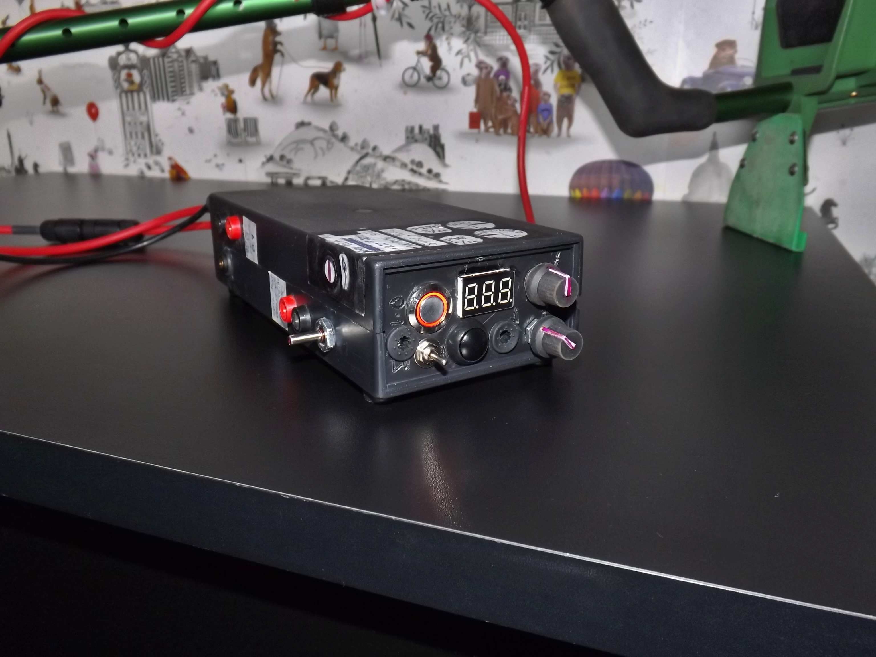

                Finally almost finished my first ever build - the Surf PI 1.2 silverdog kit.
                Finished building my Surf PI 1.2 using silverdog kit as the core.

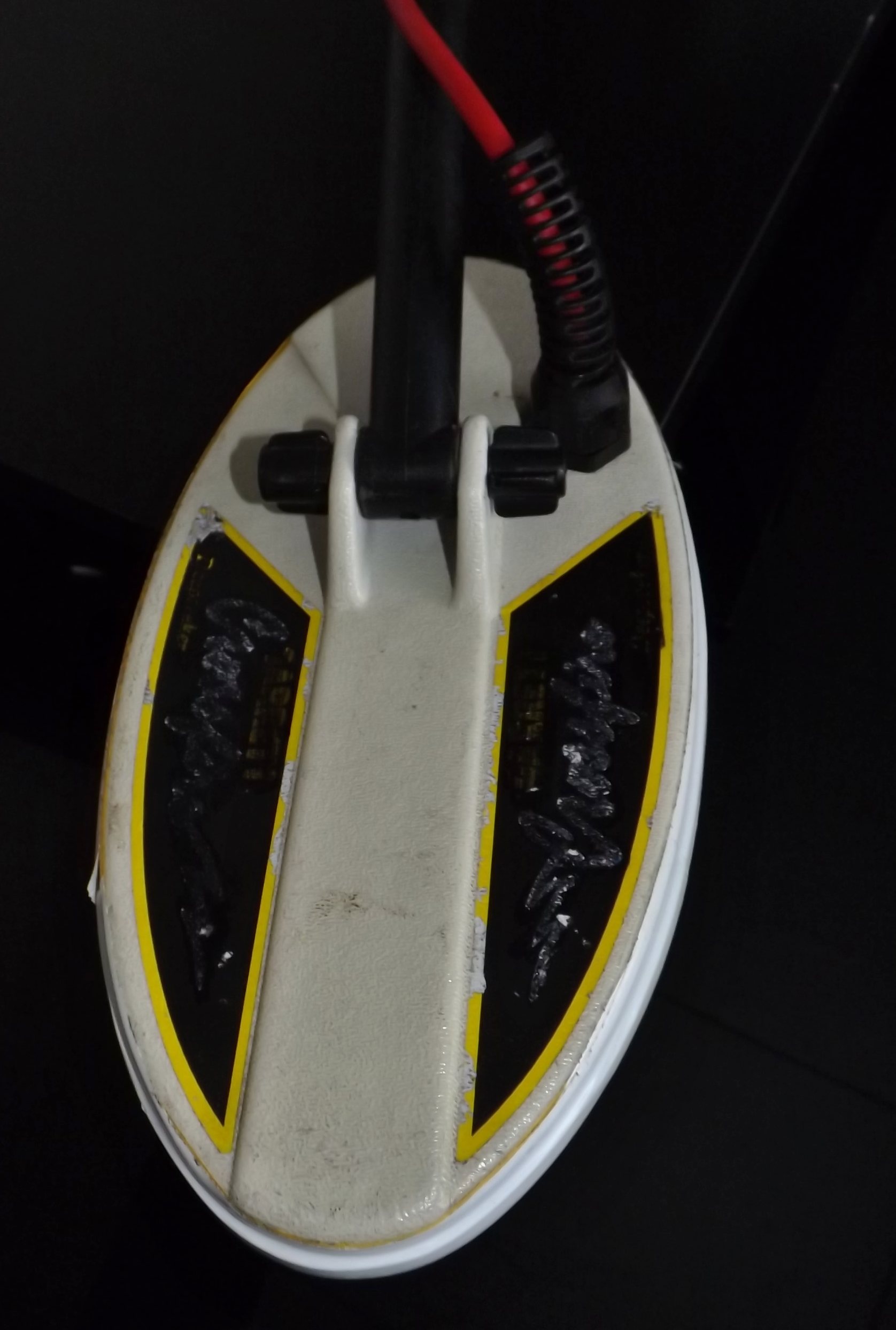

                Coil is a gutted Garret crossfire DD shell I had lying around - used 25 turns of braided (litz?) wire from a computer monitor - have left unsheilded for the time being until I figure out if needed...using the stem etc from my GTAX550 (which it is modded so control box slides on or off)Dont currently know inductance of coil - LCR meter in the post as is an oscilloscope (can't wait to get these)...I have put the delay pot on side of box along with some testpoints which will allow me to tweak & learn (I hope) once I have scope...I've got plenty more to learn.......I have posted a few photos & a video showing build overview (youtube link) I'll also post another video with air tests - the detection distance is at least as good as or exceeds that of the GTAX 550 by 1 - 2" on most items. It also seems to ignore small balls of foil. Any feedback on increasing detection range? currently 9 - 10 " on a victorian penny....is this ballpark for the kit I've used? See additional video for air tests in next post below.

                  Surf PI 1.2 build - Finally almost finished my first ever build - This is 2nd of two posts & is showing only the air tests on an oval mono coil with 26 turns of braided (litz?) wire taken from a computer monitor....seems to perform OK for a first attempt... See video & photos in last post above which show build overview using the Surf PI 1.2 silverdog kit & additional outsourced parts.
                  See video & photos in last post above which show build overview - internal wiring etc...etc...this is an additional video showing only air tests....with mainly old pre-decimal UK coinage - some rings & a small solid gold pendant....Dont yet know coil inductance...waiting on an LCR meter & a scope.......then will post more info...I've purchased a copy of 'Inside the Metal detector' & I've got the bug for building these so once I finish this build, I will likely do the barracuda then the minipulse ........
