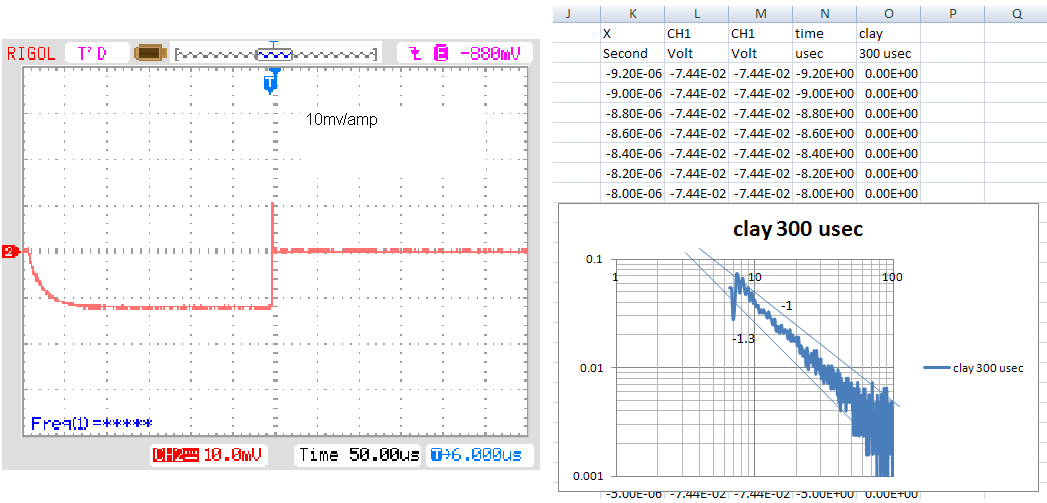

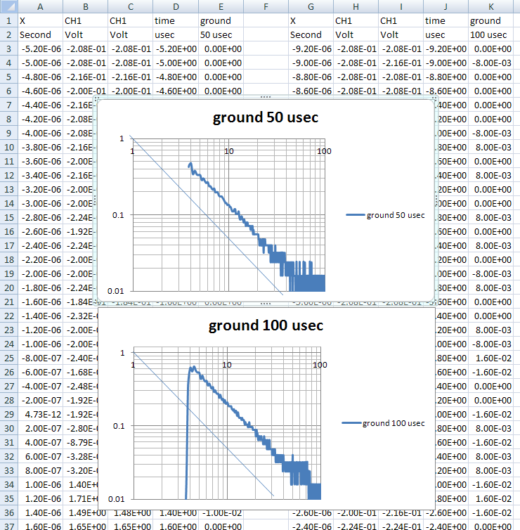

            I've plotted ground response in the past. I think most of the time the slope has been around -1.28. I plotted some clay from the yard today with 50 usec and 100 usec on times. Record no target, record target(ground), subtract no target signal from target signal and chart with Excel. Got a -1.3 slope each time. Any suggestions why I get -1.3 instead of -1 for the slope or what I might try next? I tried the ferrite core that is easy to see with a IB coil during on time, but couldn't see a change today plotting the decay. The x axis is usec with external trigger, fet gate off (time zero).

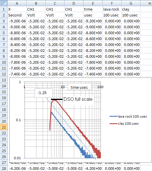

              Another chart. Landscaping lava rock and a rerun of the clay at a lower scope full scale. Not quite the same slope, but still not near a slope of -1.
                You may try limiting coil current with a resistor to any current you are comfortable with, and extend the charging period as the sampling period, and see what effective slope you get. I expect 1/t.
                  The data has more noise than I would like. The slope looks close to -1.3, same as the other runs, not-1. Things get hot and there is time between the two recordings. I think causing some of the problem.

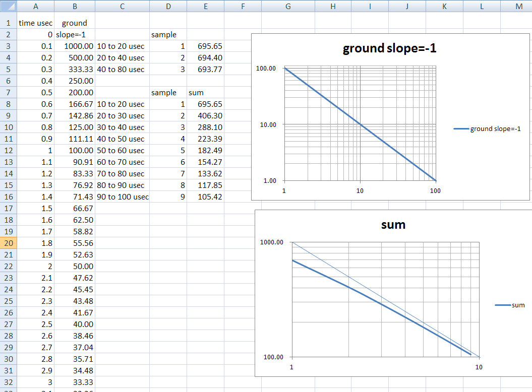

                    Generated a ground simulation with a slope of -1. Time scale zero to 100 usec (.1 usec resolution). The sum of the samples 10 to 20 usec, 20 to 40 usec and 40 to 80 usec add up to the same value which they should. Summing the values in 10 usec steps and plotting don't plot a -1 slope. If I change the generated slope to -1.28 and sum they plot closer to a -1 slope. My math is rusty, maybe someone could check my results. Maybe how the data is sampled effects the result.
                      If there is any memory effect in a process, e.g. integration, yes, you'll experience that. Point is that integration when done in linear time affects more the initial samples.

                        My math isn't what it needs to be. I measured soil response at 50, 100 and 300 usec coil on times. What does the formula predict for those coil on times?
                        • #42
                          According to the final report "UX-1355-FR-01", the magnetic soil model is 1/t (see page 18 ). But this is a theoretical soil model for homogeneous magnetic soil. Therefore, to reduce the number of geologic anomalies in non-homogeneous soil, they performed a fit of the median-filtered data set to the theoretical soil model and recorded the misfit results. This enabled them to ignore many of the magnetic anomalies while still allowing detection (and even sometimes enhancing) any metallic targets. In some cases the reverse was true, and certain metallic targets were less evident from the results. The equation in your quote is a modified magnetic soil model. This is a partial differential equation that quantifies the rate-of-change of the magnetic field response [H] with time, assuming all other variables remain constant. The constant A is an empirically defined fudge factor which allows the data measured for 4 different TX on-times to match the predicted response.
                          Basically, I don't think this equation is going to help you that much. Magnetic soil is supposed to have a response of 1/t; so [I suspect] either you have a measurement error, or your test soil too aggressive for the model.
