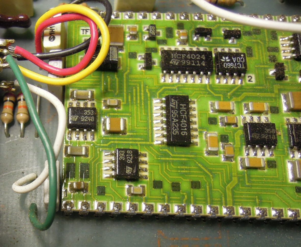

    I found this picture of the Tesoro Stingray II detector pcb.
    It is the same board as the Bandito and others. I noticed
    a jumper going to the GEB/Disc LM393. This could be a mod
    to allow the GEB to reach salt. Hmm it looks like it just shorts
    out a resistor.

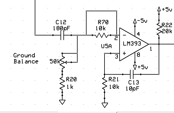

    Maybe shorting out R70?
    I'm afraid it would not do much to increase phase change, but will only shift the comparator offset a bit.

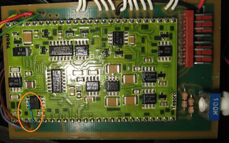

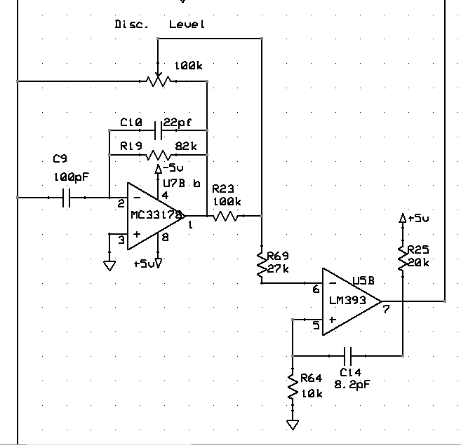

      Well I checked a picture I have of my Bandito and it's not pin 2 it's pin 6 so
      is in the disc circuit and it's jumped to a cap. I'll have to check my notes to
      see what that cap does...
