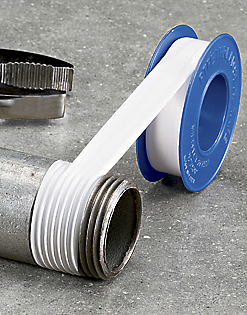

                porkluvr, what about this stuff?Click image for larger version
ID:	341560, It's really inexpensive here, 6 rolls for a dollar at the dollarstore.
                  Originally posted by Thomas View Post
                  porkluvr, what about this stuff?[ATTACH]30987[/ATTACH], It's really inexpensive here, 6 rolls for a dollar at the dollarstore.
                  Good ol' thread sealing tape is made of PTFE and is dandy but I am afraid it is way too thin unless you are willing to wrap many, many layers.
                  I have not made any measurements but I'm thinking that 0.125" separation might be acceptable, but then 0.25" separation would be much better so far as minimizing capacitance between the coil and shield and reducing flyback decay time. What works depends on how low you are trying to go.
                    Ya, I was thinking the same, but at such a low price I could use a lot. Polyethylene would be quicker and it's not bad for the price, can you see that I'm a price sensitive nut?. Hahaha

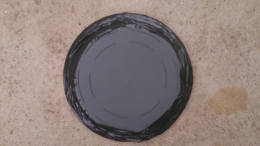

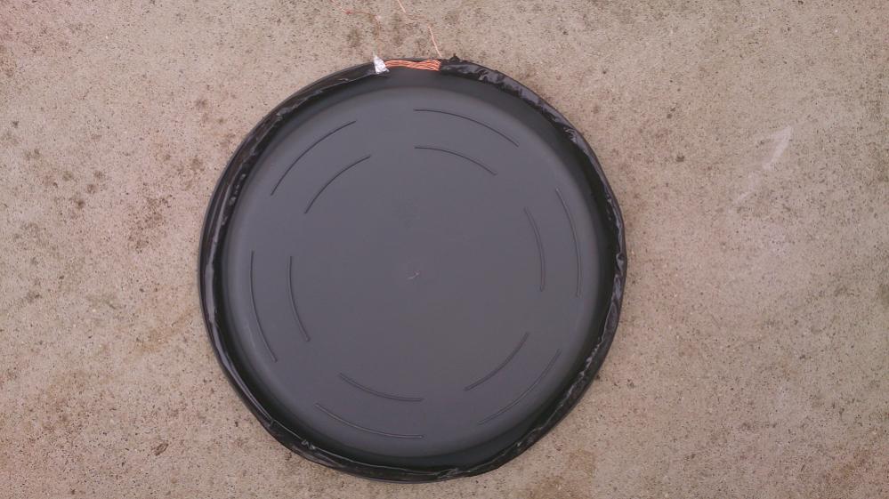

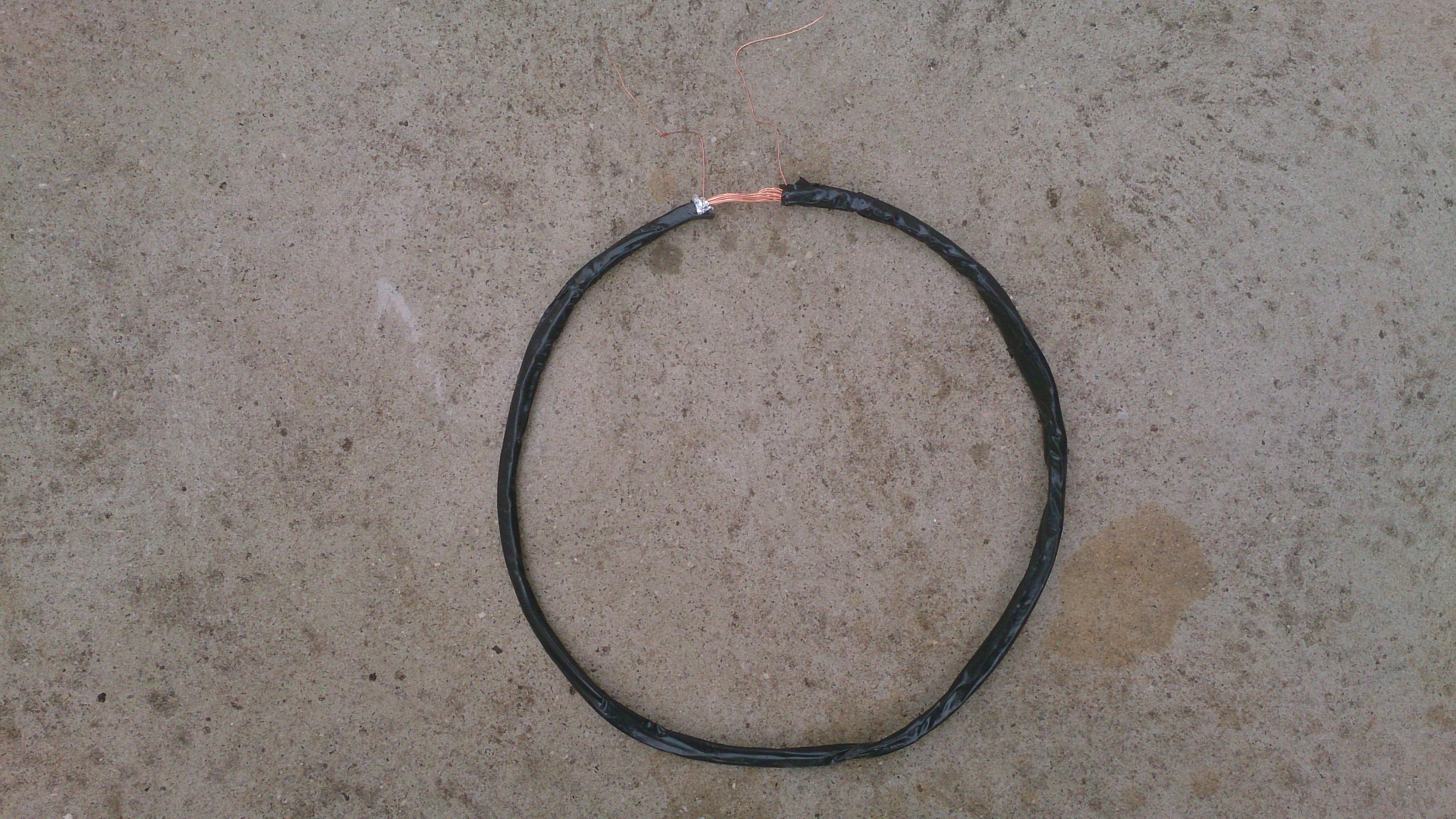

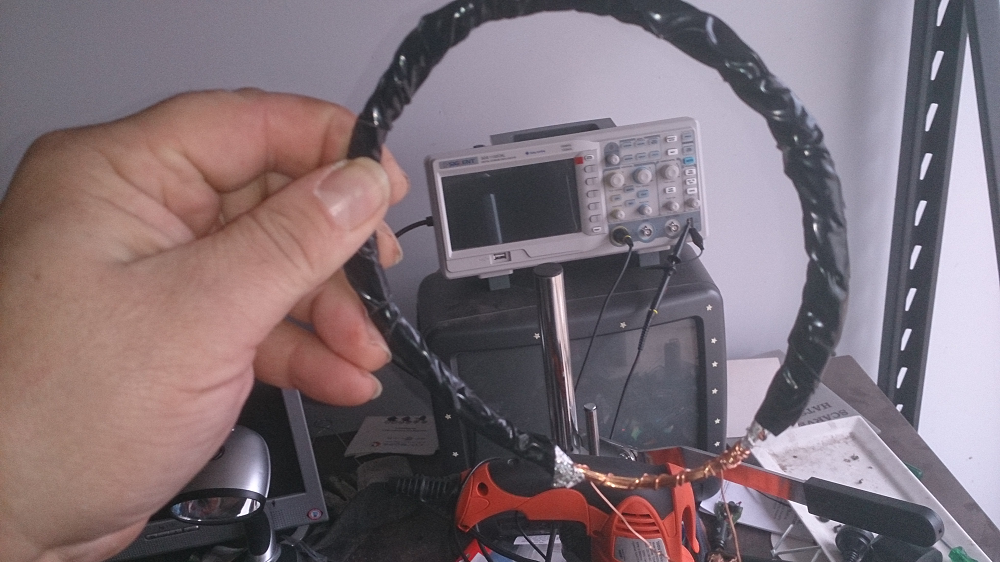

                      here is a pic of my DIY coils one 25cm and the other 10cm wide
                      i also am playing around with 2 coils, outer ring and inner, one large and small, both are wired together.
                      https://www.youtube.com/watch?v=ejLnN3aB5vg
                        If you intend to hunt for gold or other short tc targets you should not make coils with enameled wire because excess inter-winding capacitance might not allow your transmitter flyback to end quickly enough for those targets to be detected.
                        edit: Eric Foster is repute to have used PVC insulated TIN plated stranded wire in his coils. Stranded Teflon insulated TIN plated wire would probably be superior except for the fact that there is practically no such thing because of manufacturing costs tradeoffs, making silver plating a less expensive alternative in the manufacture of stranded Teflon insulated wire, rather than tin plating.
