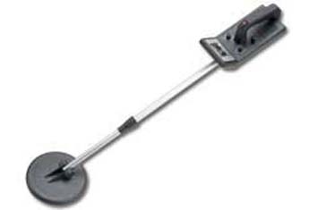

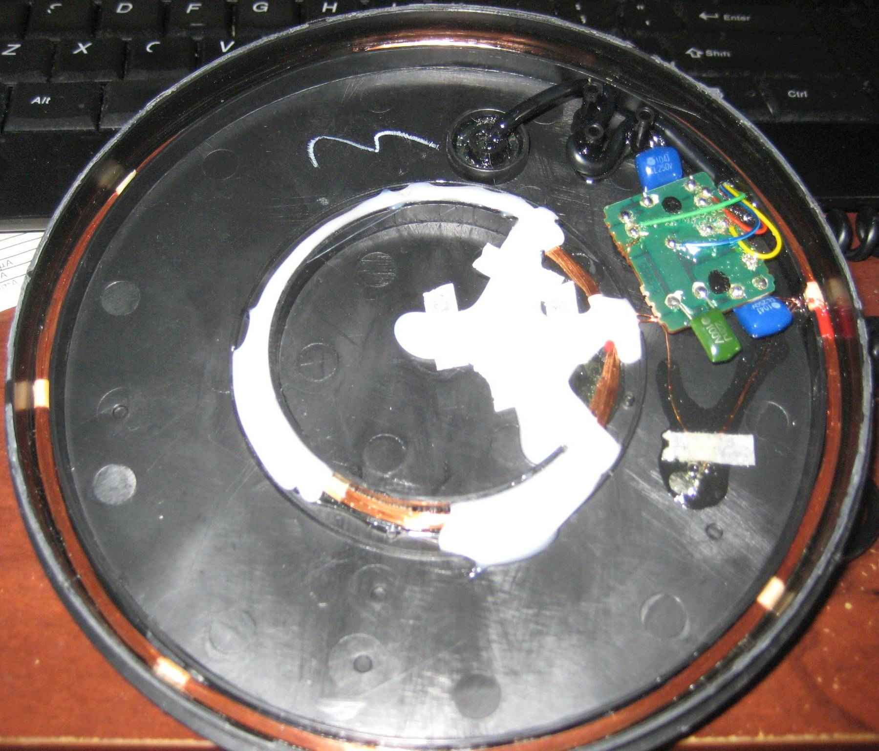

    I bought an older Radio Shack metal detector at a yard sale for $5!
    It didn't work but I figures oh well I can use the coil. Wrong! It had some funky
    inductance values. So I decided to open it up and modify it to work with my
    TGSL SMT board. So that means winding some new coils.
    It looks like this;
    The coil looks like this;

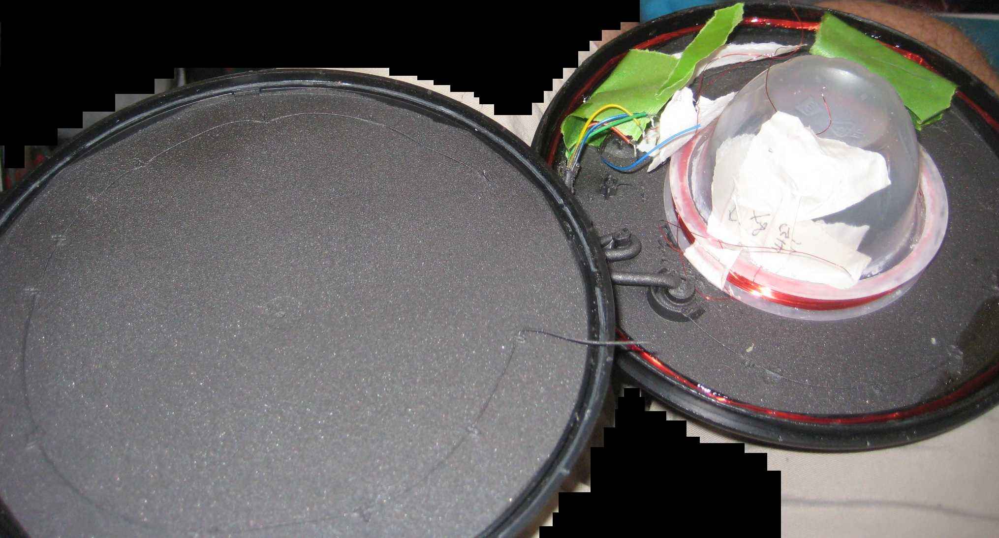

    I pried it open and found this;

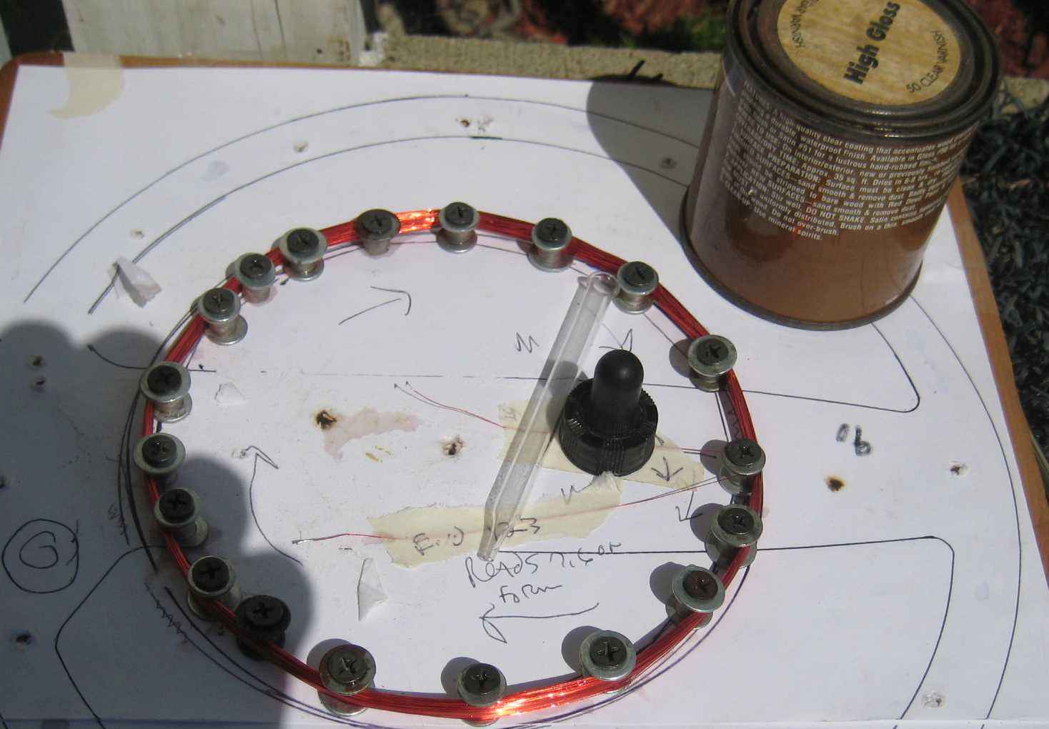

    I wound up a 6.2mh 6" coil for it and varnished it
    (the first one I saturated with super glue and it shorted out to 3mh)!

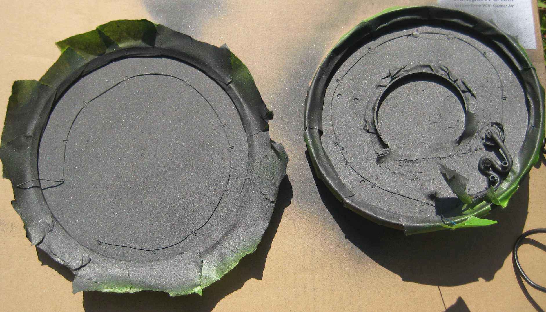

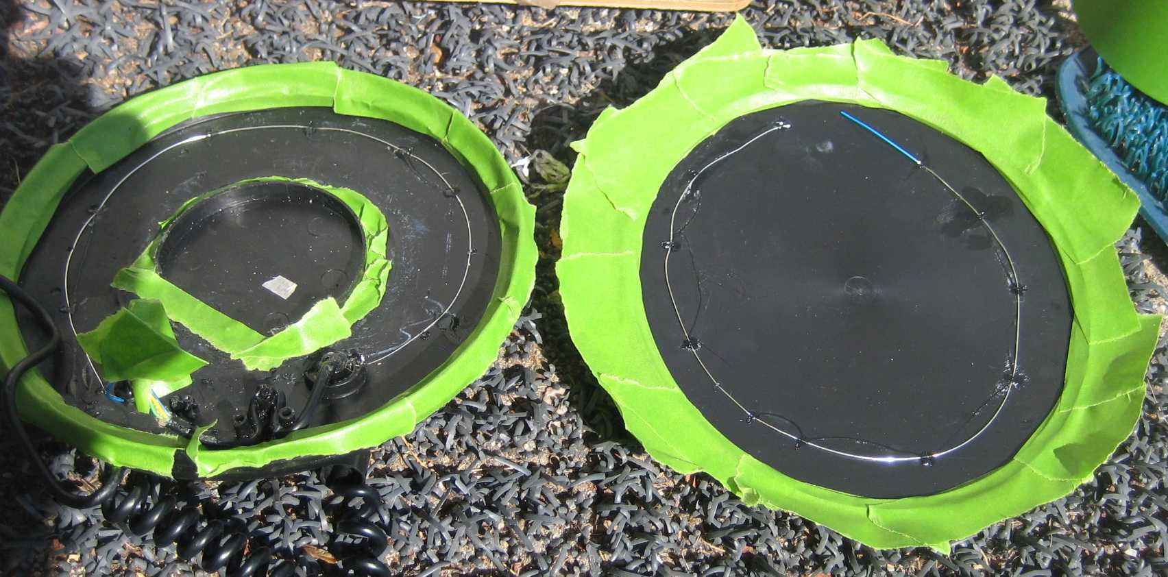

    I attached a drain wire then painted the inside of the shells with graphite
    for shielding;
    Painted the Graphite;
    And wound a RX and Bucking coil on a bobbin made from 2 discarded fruit cups! (RX 6.5mh buck 0.12mh);
    So I just need to null it and put the TGSL board in the case and Voila!
