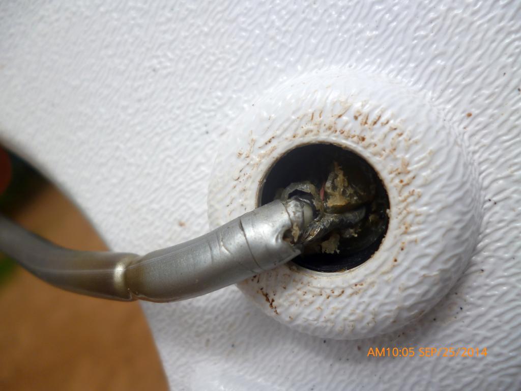

              Sounds like the coil shielding may have broken loose. If you take the PCB out of the control box, try disconnecting the coil and see if the problem goes away.
                Ok. I unclipped the coil wires and the sound has stopped. It was still some erratic sound when I first took off the black wire, then all quiet when the positive came off. There was some corrosion on the solder where the coil wire attached to the pcb, but nothing too nasty, kt315 has an image of it.
                My feeling was it may have something to do with the joining at the coil itself, wiggling it around before I unclipped it seemed to make it cry worse, though it could have been coincidence.
                  Joe, thank you for pic you sent. I have to give warning you - do not power on without the coil. anotherway you may use small selfmade coil, with ferrous corn, L=300-400 uH.
                  you can cut some lendth from the cable, 4-6 cm enought, from housing side, then cut it along. you'll see cable state and shielding wires' state.

                      Ok, I removed a few inches of the coil wire, looks to be in pristine condition, shiny with no frays.

                          Kt, did you receive the photos? I took off the (waterproof?)plug at the coil itself and stuck my tongue in there-tastes like a pretzel, very salty. Could that affect the functionality? And if so, can I cut the coil along where it looks like they they sealed it to get into the insides to do whatever it is I might have to do to fix it?
