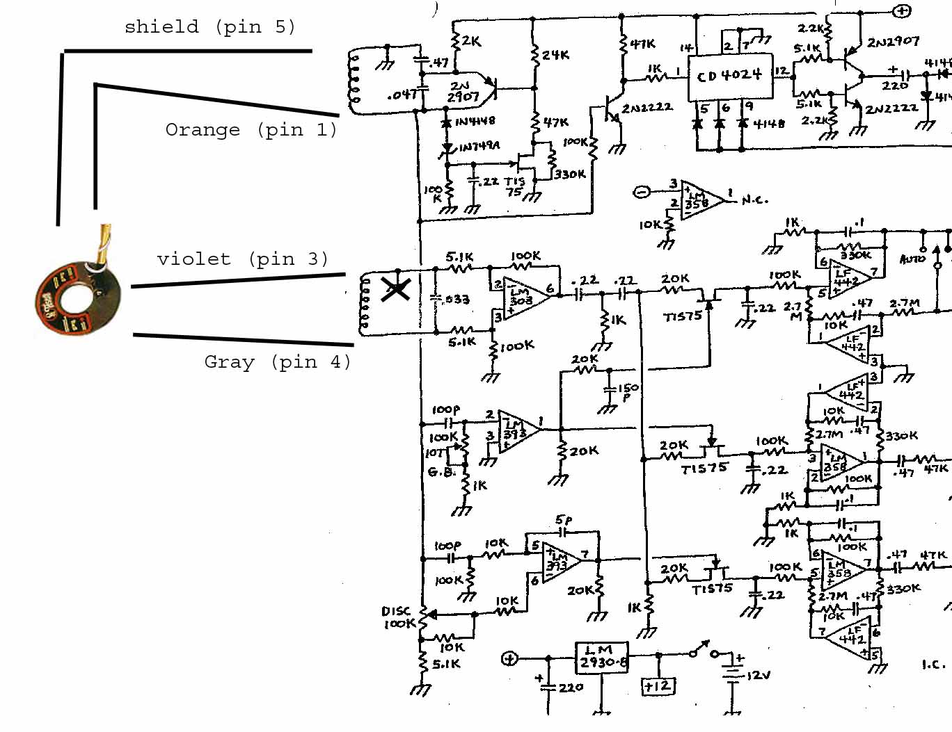

    I have constructed the tesoro eldorado and have bought the head tesoro original them (that concentric brown with center them). I have following wire: viola, gray, orange and ground. between ground and gray I have 22 ohm between ground orange I have 22,3 ohm between viola and ground I have 0,2 ohm, but even if turn out in short it are not! why if I connect on the coil rx or an other I have marks them tx-rx fase of 180°. Someone could help me to understand as they go connects to you correct tx and rx? Thanks!

    Orange (pin 1) & shield (pin 5) are the transmit coil. Shield is ground, orange goes to the Colpitts circuit.
    Gray (pin 4) & violet (pin 3) are receive. Gray goes to the non-inverting side of the preamp, green to the inverting side.

      Hi Carl if I have well understands the search head you must be connected as in photo.
      In this way I have a bewilderment tx-rx of around 20-30°.
      If I also connect the same shield of tx for rx I get bewilderment tx-rx of 180° in comparison to before.
      I know that the original head of the tesoro eldorado introduces a bewilderment tx-rx of 180°.
      Do you think that can be compatible?
      I with the wire on threads as from your indications have the followings results:
      To succeed in balancing the GB I have had to put in parallel to rx a capacitor of around 40nF instead of 33nF and in this way I get bewilderment tx-rx of around 30°.
      The maximum depth in air in disc is of around 26cm.
      Thanks in advance!

            Yes, your drawing is correct. Do not ground the violet wire. In my previous reply, I said green, but meant violet... was looking at the header wire, not the cable wire.
            Where are you measuring the phases?

              the phase I measure with oscilloscope double track, one on tx and the other on pin 6 of LM308.
