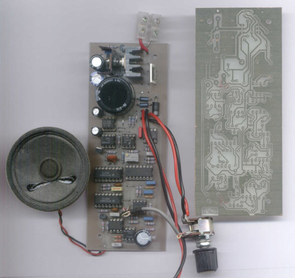

    Does anybody build a german PI called Tiny (www.pulsdetektor.de) ? I am very interested in hearing how this detector works on differents grounds (beach...)
    Is there a better method to wind wires (mono-coil) to optimised the sensivity on small targets ?

    I don't know whether you read the coil construction for the standard search coil used in all Pulsdetektor projects. The Tiny is designed for a mono coil but actually it works with two coils in series. The big coil (round) is for large objects and the small one (star) is for small objects. The coil construction is under "Projekte" (projects), "Spulen" (coils) and than look for "Basisspule" (basic coil). Any design/shape/diameter is possible but the overall DC coil resistance should be below 3 Ohms. Note: The Tiny works only if there is a coil connected to the electronic!

        ya i read the Basisspule and i know about the two coils in series.
        i was just asking myself if there was not a special method to wind wires in the coil or a special shape/design of the coil to increase the sensibility on small targets as monney... (detecting big targets don't interest me...)

          You can take any other 2 to 2k2 metal film resistor (3..5Watt). Or you can check out Farnell (www.farnell.com). I bought my one there.

            In general you can say that a small coil (dia 4..6 inch) is more sensitive to smal targets than a big coil (dia 8..12inch). If your desired targets are small you should go for a smaller coil but you will lose on depth. The "Basisspule" is a

              In general you can say that a small coil (dia 4..6 inch) is more sensitive to smal targets than a big coil (dia 8..12inch). If your desired targets are small you should go for a smaller coil but you will lose on depth. The "Basisspule" is a good mix of both (big and small targets). I finished the Tiny project and it works so far. But I tested the Tiny only on my workbench with a test coil. Because I had not much time to work on it in the past month.

                        Just another question, as i saw you built tiny... (post 22 october 2002)... For R2 to R35, what did you take ? 1/2Watt ?

                          all 1/4 Watt as you can see from the image.
