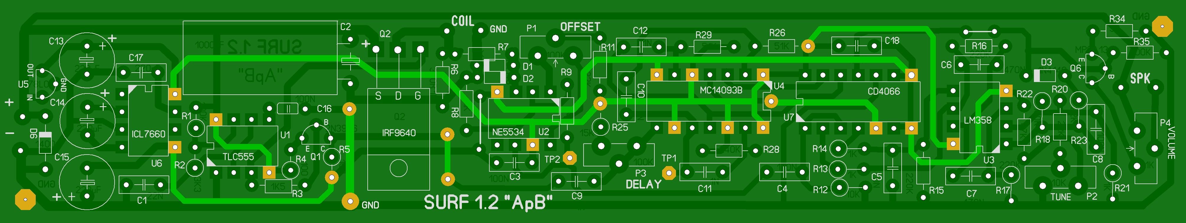

                            I want to etch my own pcb. Is the surf pi double sided? How long is the longboard?
                            My copper clad boards are only 160mm long.
                            • Surt Long is two sided. I have nothing that only shows traks Click image for larger version
