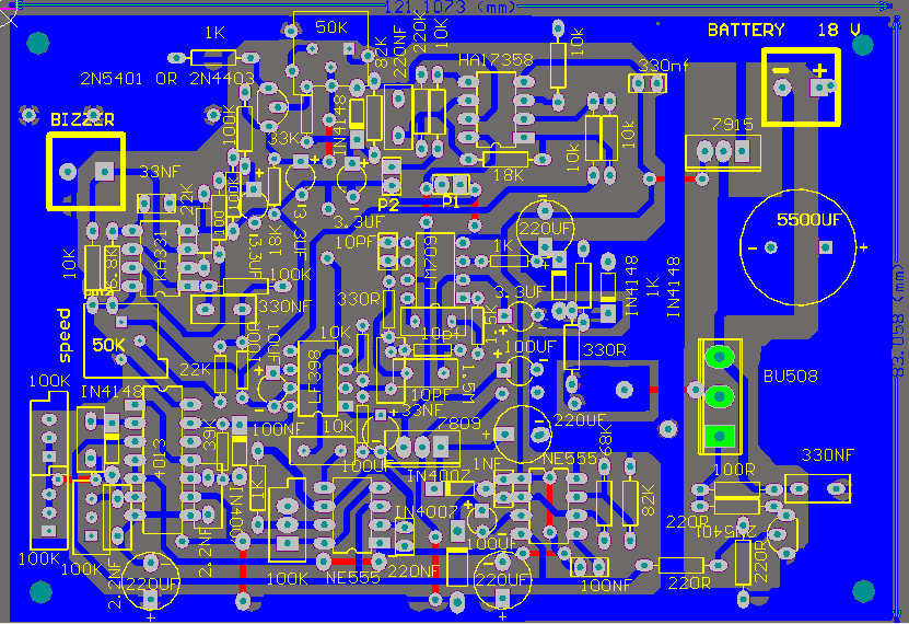

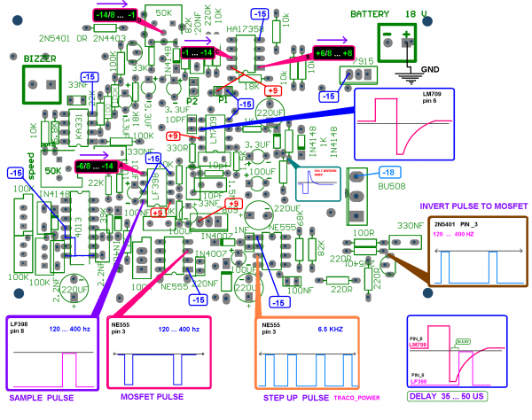

    hi
    this is another detector.if good , i start to work/see pics

    this is not like mini pulse right
      i think it is not.
      so any one have more information?
        some kinda a try to release PI detector up in a bad economical situation. imho not so big advantage vs delta pulse you ll get.
          THANKS.kt315
          we are waiting your new deeper detector . put it here to start it
