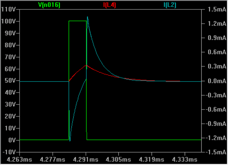

                            • #59
                              Originally posted by greylourie View Post
                              Hi green,
                              The device has some operating modes. High Yield/General/Extra Deep. The scope shots show frequency and duration of tx.
                              By Tx do you mean the current in the coil (magnetic field) or the voltage across the coil?
                              If it's the former then long tau targets (big, deep nuggets) are visible right after the initiation transient of the pulse and short tau targets after the end transient.
                              This is so because from the target's point of view there are two pulse widths: a wide pulse (time lapse between the short pulses) and the short pulses themselves.
                              The receive signals would be something like this:
                              • #60
                                Green trace = TX pulse
                                Red trace = long tau target response
                                Blue trace = short tau target response
