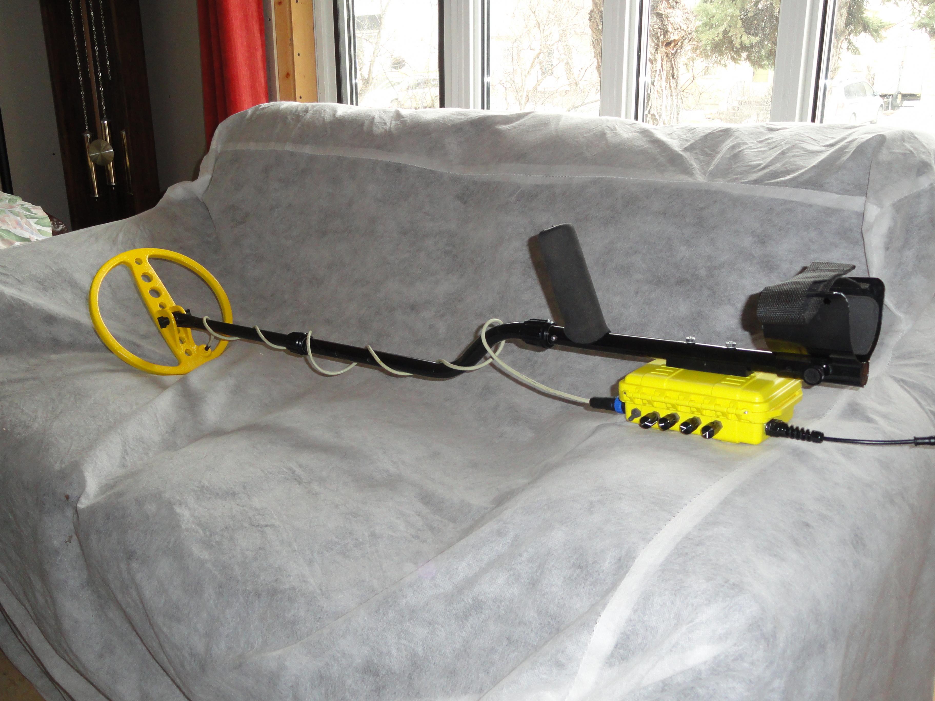

    Here is my finished Surfmaster PI Click image for larger version
    nice one mate, it looks fantastic.
      Nice build, are those pots waterproof ?
        Yes they are ,all connectors are waterproof and shut off switch too .Detector weights 2lbs and 14 ounces w/batteries and coil .
          Nice job. Looks very professional.
            which type of connectors did you use how did you seal the pots?
              You can find connectors , pots and waterproof nuts at digikey
                Looks amazing man! I can only hope mine finishes up as nice.
                  How do they list them? When I search digikey for waterproof pots nothing comes up.
                    They do not list them as waterproof pots but you buy waterproof nut to go on the outside of your case (instead of using regular nut to secure pot to the case) I will post some parts # tomorrow
                      Thanks for the help eagle52.
                        This is the pot type I used- 392JA103-ND and waterproof nut/seal 335-1020-ND . Waterproof case #206 from underwater kinetics .

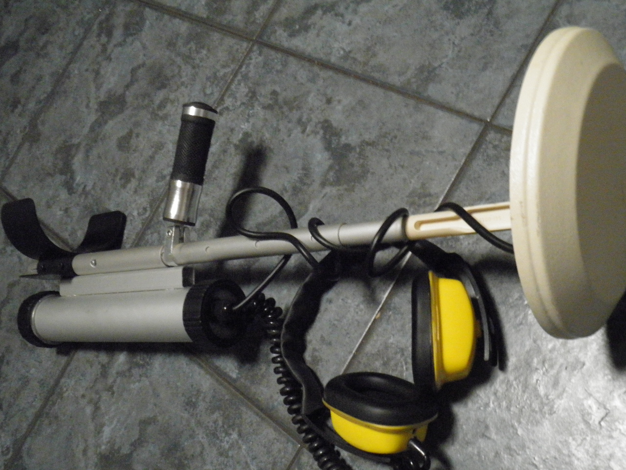

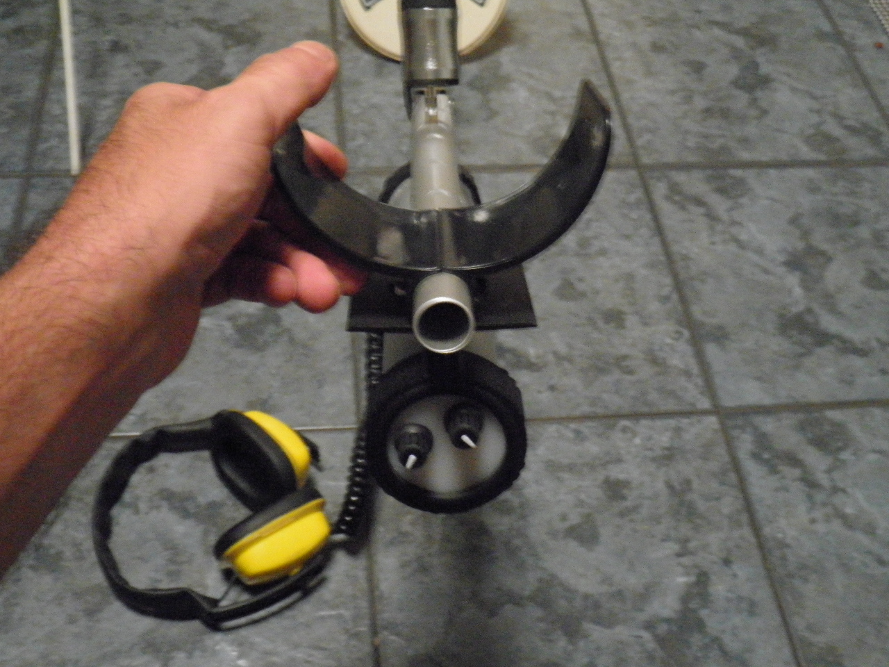

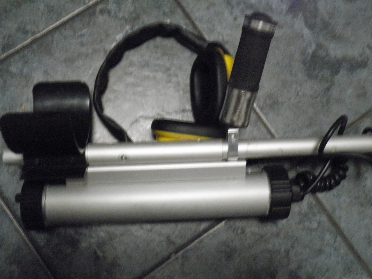

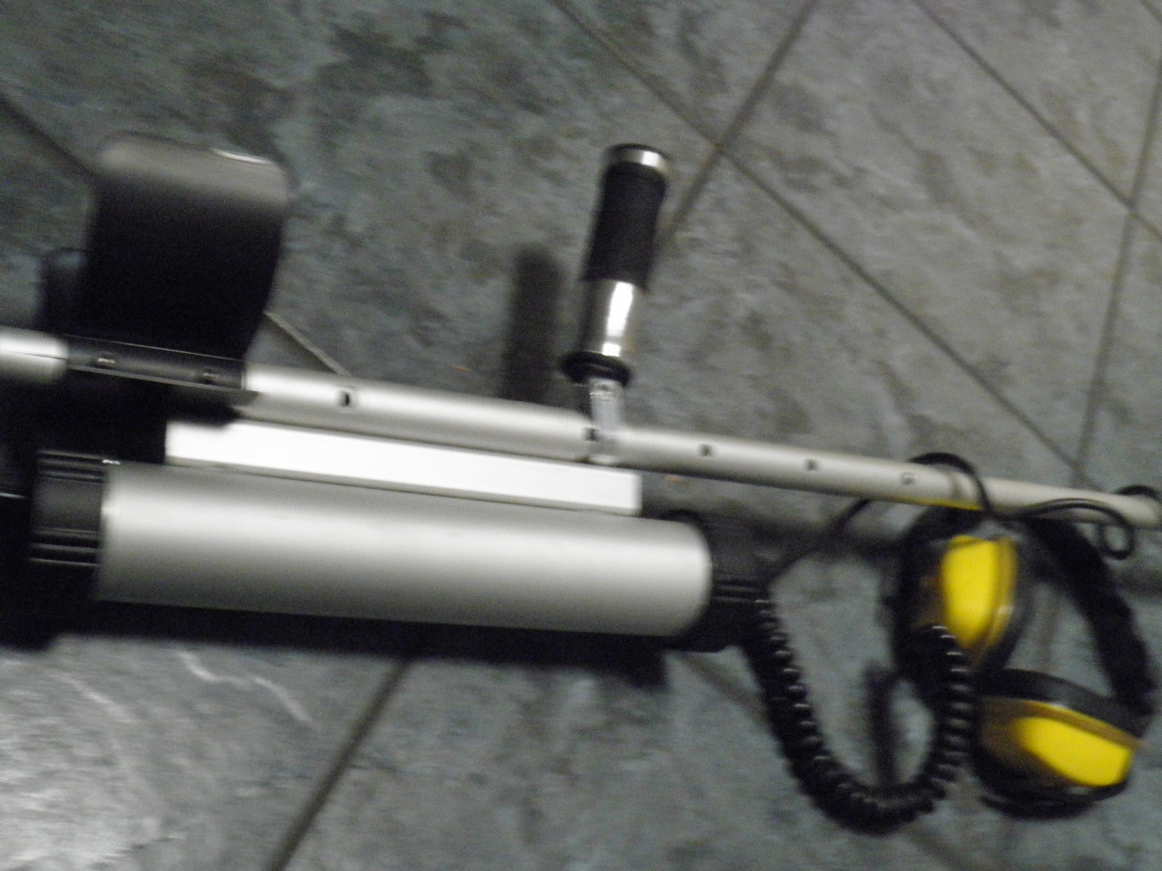

ID:	342788Click image for larger version
ID:	342789Click image for larger version
ID:	342790Click image for larger version
                          My surf pi 1.2 kit home made compact
