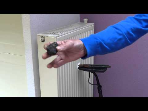

    .............. I suspect if you were to place the coil on top of a metal drain cover, you wouldn't be able to detect the moving coin.
    An interesting experiment. We've never tried it because it seemed to us to be impossible. We don't have a metal drain cover but we have a 90 x 60 cm (35"x 24") triple central heating radiator.
    We have tried it out and we are very surprised with the results of this extreme overload experiment.

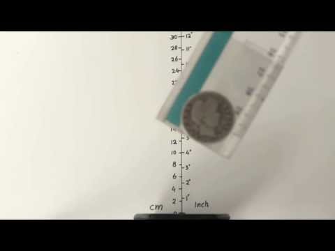

      The detection depth difference between different positions of the targets 2

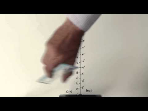

        Dynamic range experiment 5

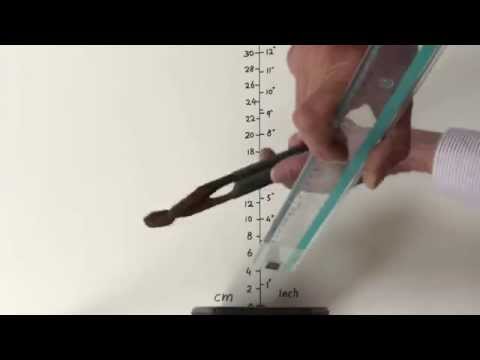

              if it work like this https://www.youtube.com/watch?v=12YLaiUnEhc I might make it but so far the videos show nothing new compared to other projects on here. The problem with large iron is only there if the coil is in motion. I rested my IDX against a radiator and placed a large rusty spanner diagonal across the coil and it still works fine.
              Testing a detector on a bench is very difficult to get meaningful results. I have just made a coil that works fine inside works fine on my flat lawn even over wet grass but fails on normal pasture fields because the surface is not as flat

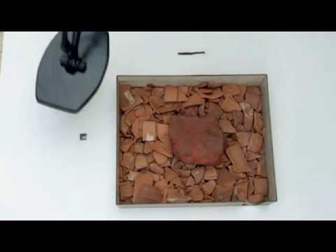

                          Highly mineralized.
                            Originally posted by M.D. prototypes View Post
                            Highly mineralized.
                            So, what's in the plastic container ? broken tiles, pottery and bricks ?
                              Only, broken pottery.
                              It is important to adjust precisely the ground balance because of different and uneven surfaces.

                                Bricks and pottery are only mildly mineralized, true mineralized ground is highly mineralized and highly magnetic. Picture below is of a small sample of highly mineralized ground I use to test my PI circuits.
