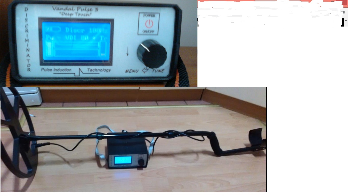

              Do you have used/experience with VANDAL PULSE 3 and PIRAT MD
                Vandal Pulse 3
                is it any similarity with Delta Pulse 3
