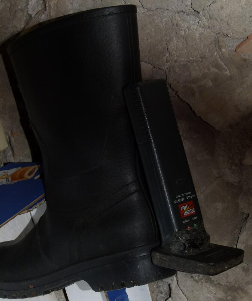

        Attached the pic of a pretty simple prototype possibility - 100kHz motion style.
        Depth is not very good with such mini-coil - a horseshoe ca. 10cm.
        Usually its a pinpointer with narrowed (overlayed) original coil in a smaller housing.
        But it works already while walking over coins directly on the floor.
        Using some gaffer tape and gum-boots is the simplest solution.
        This way also some other pinpointer could be attached.

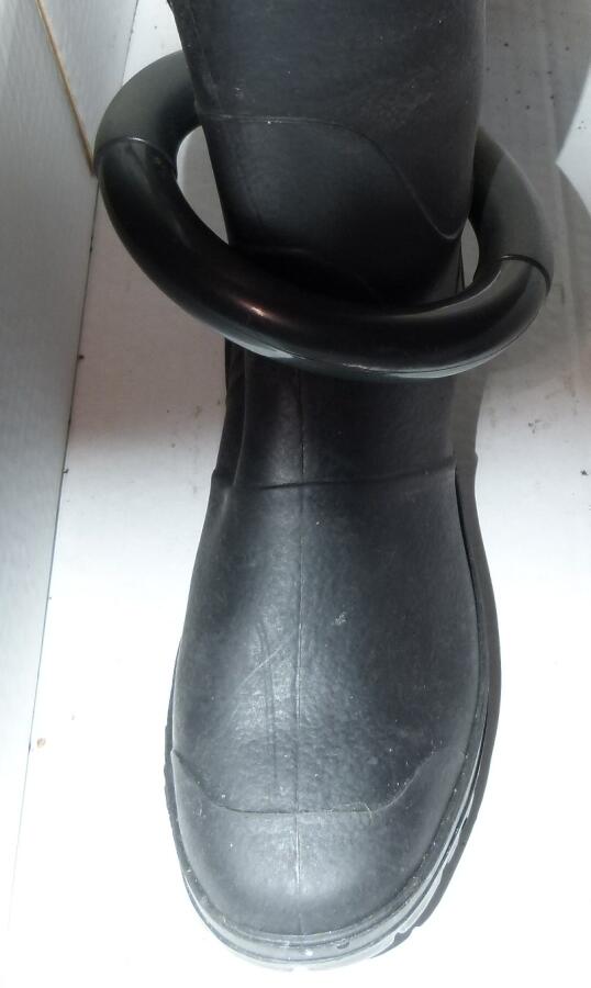

        The usual ca. 15cm diameter plastic coil of such cheap security detectors
        could be melted a little bit over heat and bended 90° and made more
        eliptical so it fits directly over the shoes with larger coil inside a stable plastic housing.
        But the standard coil is a little bit too small for that, it should have ca. 18-20cm instead of just 13cm diameter.
