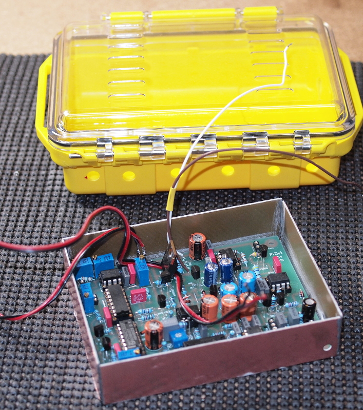

im still to purchase a box...im thinking of a ultra box if i can get everything in including batteries.
If you get the Ultrabox, just make sure you don't mount it to your handle set-up via the box lid. I feel the total weight of the finished unit would put too much stress on the lid. You want to mount the box portion to the handle set-up, so it supports all the weight. This way you know your playing it safe so it won't leak. Especially after you put all the work into building the water unit.
Just want to give you a heads up, warning you of some of the pitfalls in box mounting. If you could acquire a White's Surfmaster box and pots, with its strong lid and latching system you can mount from the lid.
I am always looking for a better waterproof box......short of having a custom one made....
I use the 206, very tight, took me about 40 hours figuring out how to make everything fit correctly and order of assembly. Make sure you check you battery size, PCB size etc and compare the inside of the 206 dimensions.
The 406 has tons of room a bit too much, I used one on one of my first builds.
Had another supplier of boxes, just can't find the link. They had some nicer sizes, they were considered waterproof, not submersible. Which translates you can drop the box into the water, it will float and keep the contents dry.
When submerged, water pressure is greater than air pressure, given a short amount of time depending upon depth it will leak water in. Watch the suppliers descriptions.
Please remember I am a perfectionist, so I go the extra mile to get everything just right the first time. Then I find a way to improve it the next time and this carries on. Hard to be satisfied.......always looking for a better way.

i wondered if it would be better to enclose the pcb into a smaller waterproof box and seal any wires coming out with silicon and wrap it with aluminium foil for screening then mount the smaller box inside the ultra box...this would save the pcb if any water should enter main box....only an idea ???
Still have to worry about air water temp changes causing any condensation within another sealed box.
In one of my versions I built a copper box to hold the PCB for shielding but, it was not sealed. Again a very very tight fit even when using the very small RV6 pots and providing clearance for coil, headphone connectors and wiring.
I have also lined the insides of the plastic box with copper foil tape with a layer of epoxy over it to seal it, after grounding wires were soldered to the copper on the lid and box and attached to the PCB.

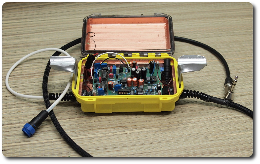

You can eliminate the connectors by hardwiring the search coil and headphones using Heyco cable glands with strain reliefs like Fisher does with the CZ20, 21, 1280x. I have used this method in the past and used in-line waterproof connectors.
Here's some pictures
i see what you mean about the temperature changes of a smaller sealed box...im not sure whether to hard wire or use waterproof plug and socket for coil and headphones...how did you make those control box mountings as a very good idea instead of putting a bracket onto lid of control box...ive never made a waterproof detector before but will be a good challenge !!!
The silver ones pictured above on the yellow box was very time consuming. basically made a jig and laminated fiberglass cloth and epoxy over the jig in two parts. Once they were slipped into the box slots, they were laminated together on the bottom so they were joined into a 1 pc. mount. Then epoxy putty was used to form the curved pcs. for mounting onto a round shaft.
Current black ones ones that look like end blocks.I first made up a mock up out of balsa wood to fit exactly.
Sanded, sealed and spray painted them.
Then made a mold out of silicone since I had some kicking around.
Mixed up some epoxy, poured some in, added some fiber glass matt in multiple layers until the mold was topped off with epoxy.
Once cured, popped them out of the mold, did a final sanding. Drilled all the holes, Finished off spray painting them with Truck Bed Liner spray paint.
If your a machinist you can actually machine some nice ones out of Delrin plastic. Since I sold my machining equipment 15 years ago, I can still mold and cast.
