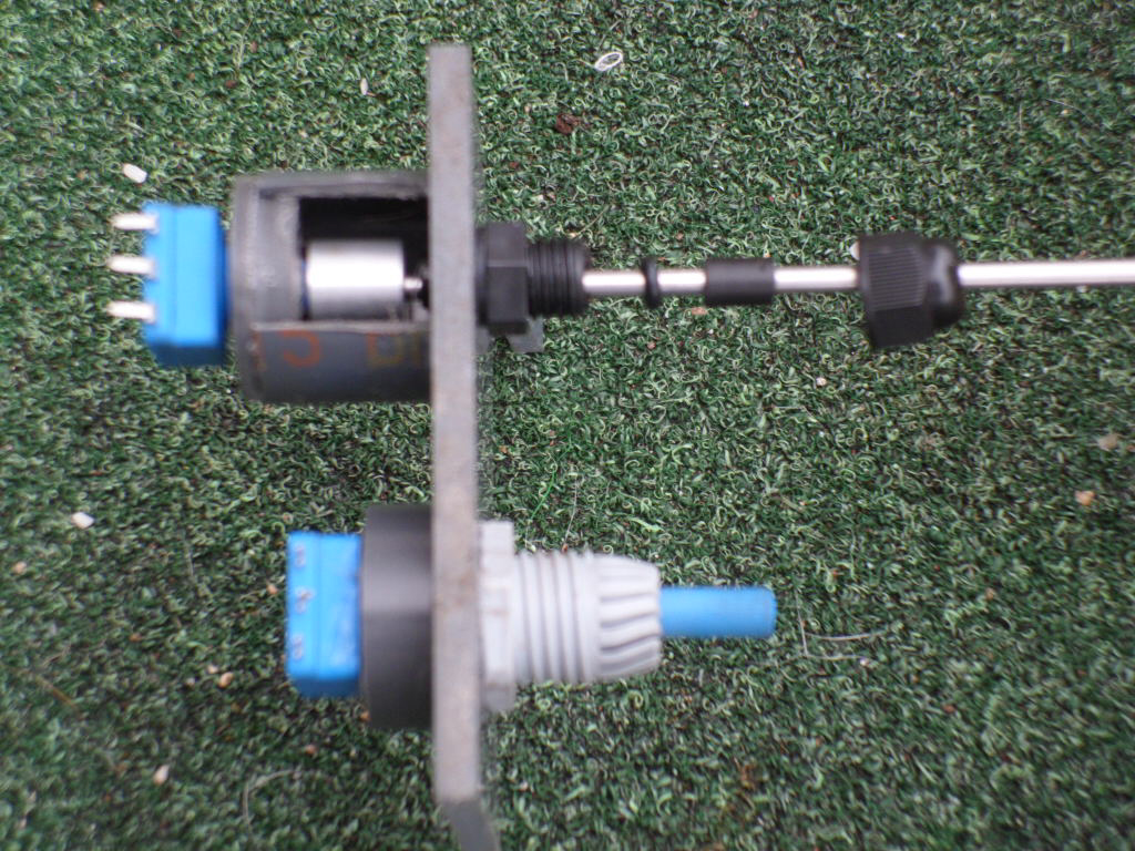

        Glands have arrived good news is that it's quite easy to machine them down fit a small sleeve and "O"ring now when I tighten down the top nut that normally squeezes the rubber seal and locking "fingers" together it squeezes down on the "O" ring. will try and get a photo in the next day or so.
        Tube is 40mm inside dia thick walled PVC marked up as high pressure can fit 4 glands on end cap but now need to sort out pots, could make and bond a saddle to tube but that will cause other problems such as access.
        Plan is that pots and end cap will be as one unit what may be a problem is size of fingers as knobs are small and close together.
        Now if we can reduce no of pots it will make it much easier ideal would be to have 2 cables exiting bottom one to coil other to headphones and battery pack could then have on/off and volume with batteries with just single control on top cap that would be simple. housing would then be fine for diving?? any thoughts on type / size of batteries
        hope you can see what I mean but until I get a bit further its hard to describe what does not exist but coming along fine these are the problems I like and enjoy. Bob

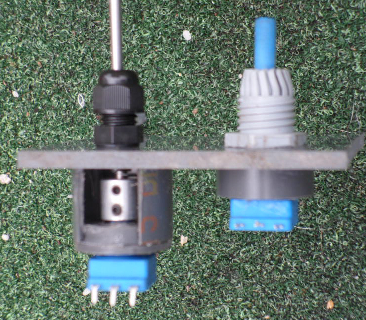

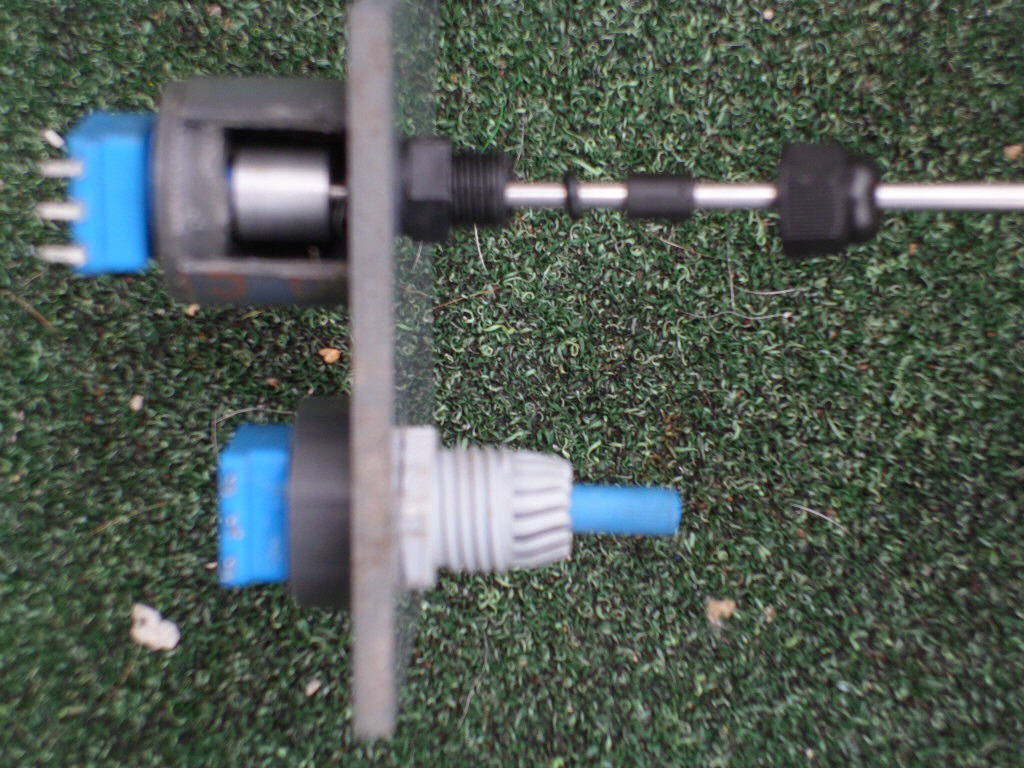

                          Have made a couple of ideas using parts I have in stock, one is much too complex to make with small s/s shaft and coupler but the "O" ring seal seems to work well black gland was simply machined back and drilled out to suit o ring. Second one is much simpler pot screws into spacer, gland also screws in plus some solvent to bond and seal it, pot shaft has to be smooth but splines could be sanded down and the rubber seal supplied would be ample for non immersion, could be fitted with o rind one or more and a packing sleeve would then reduce height. Will be ordering some more glands to make up a final version.

                            Hi Bob
                            Thanks for the photos....ive decided to make a dectector that can be put onto wet sand surf and weather proof...ive ordered a box and a 6mm slotted pot and some control knobs and will do some experimenting before ordering more....i found some hex seals on the internet but need to get the correct size...all these things have been very vague to me as never done this before.

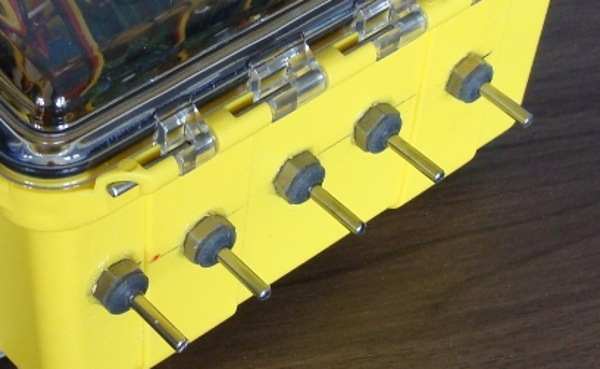

                              Easiest and safest way is still using the hex seals.
                              Just drill the pot mounting holes in the case. Put some sealant adhesive on the base of the pot. Slide pot into hole, screw on hex seal. Attach knob and your done.
                              If you want to get more critical. tap the holes for the pot threads, apply sealant to pot base and some on the threads before screwing pots into place. You won't have to worry about leaks.
                              Below are pictures of an earlier box
