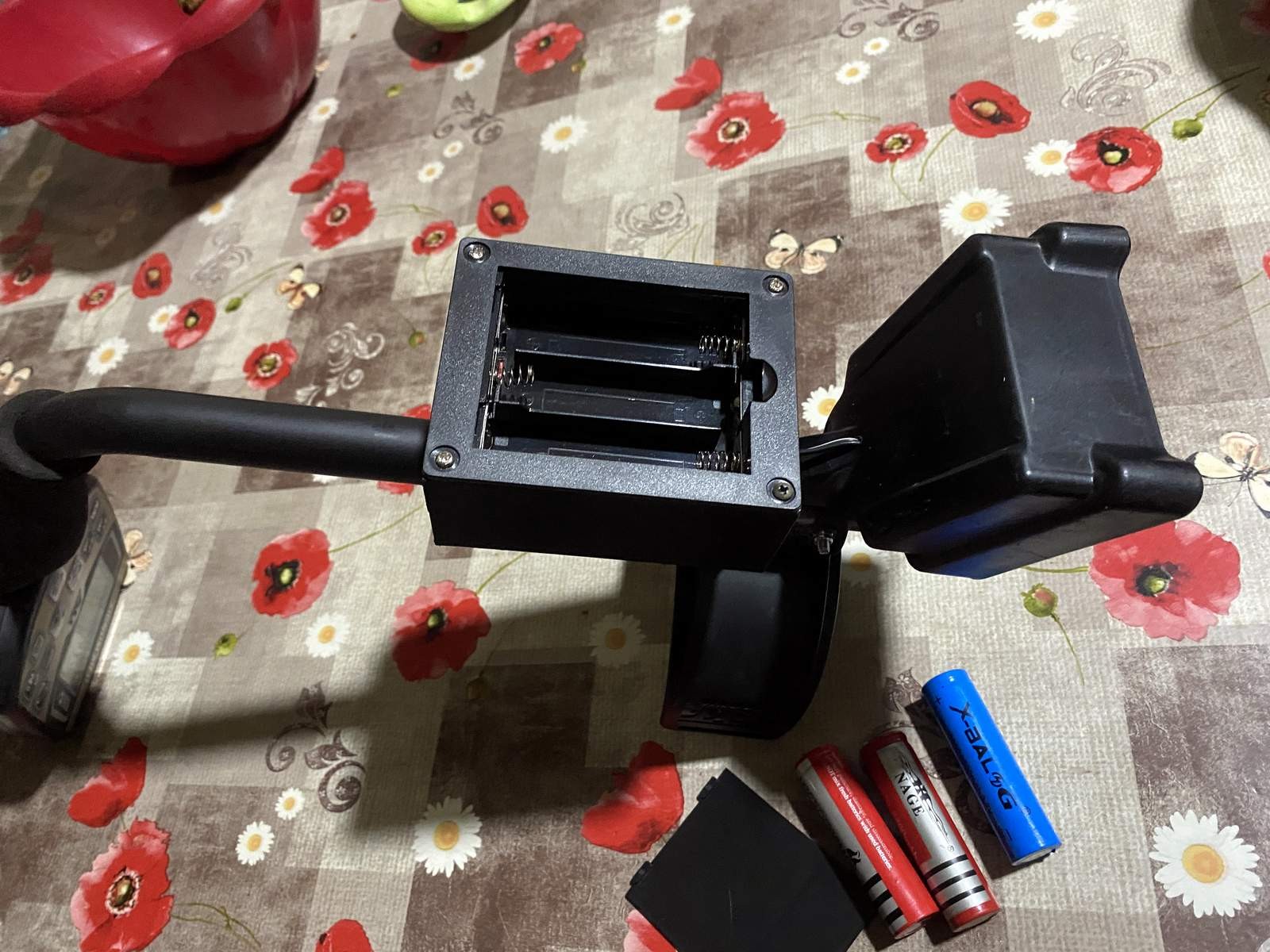

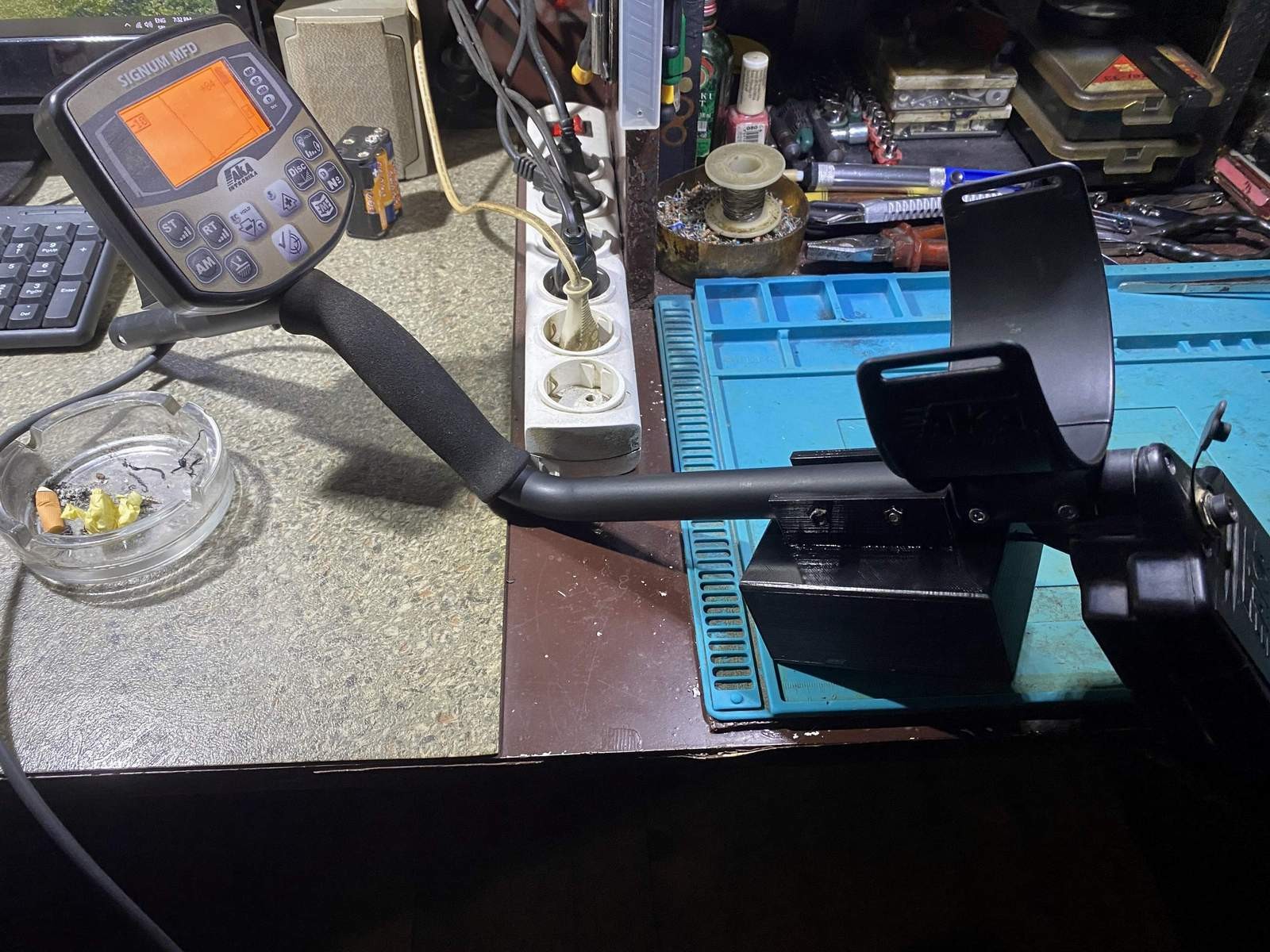

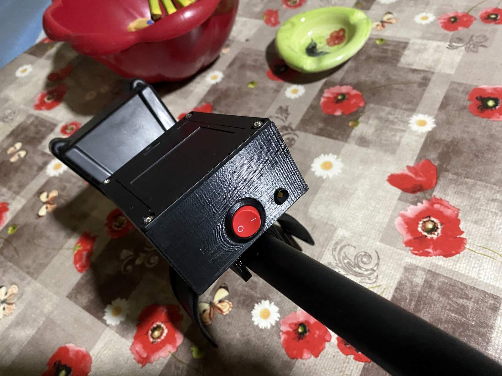

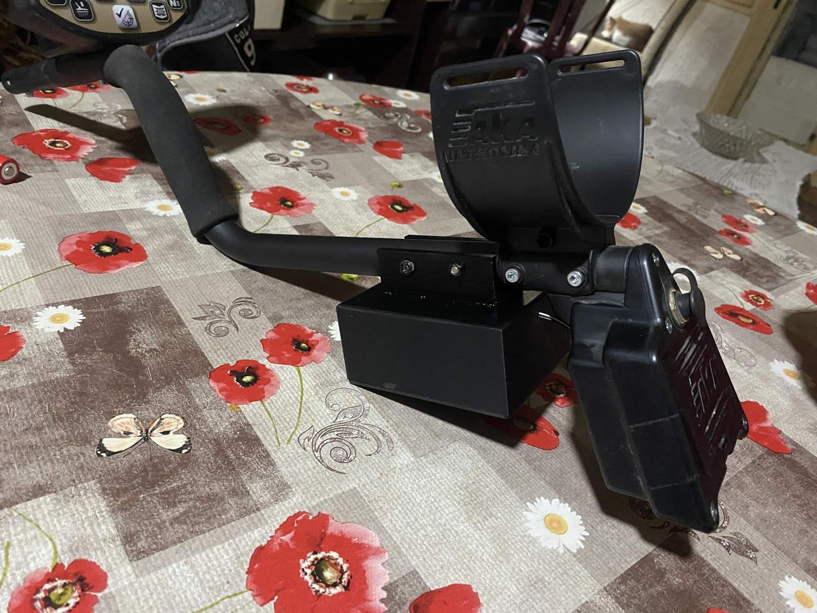

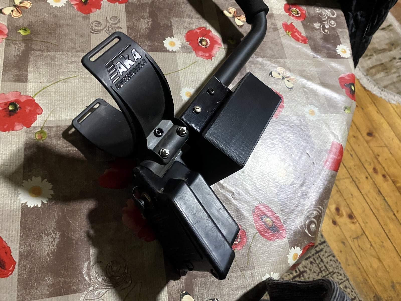

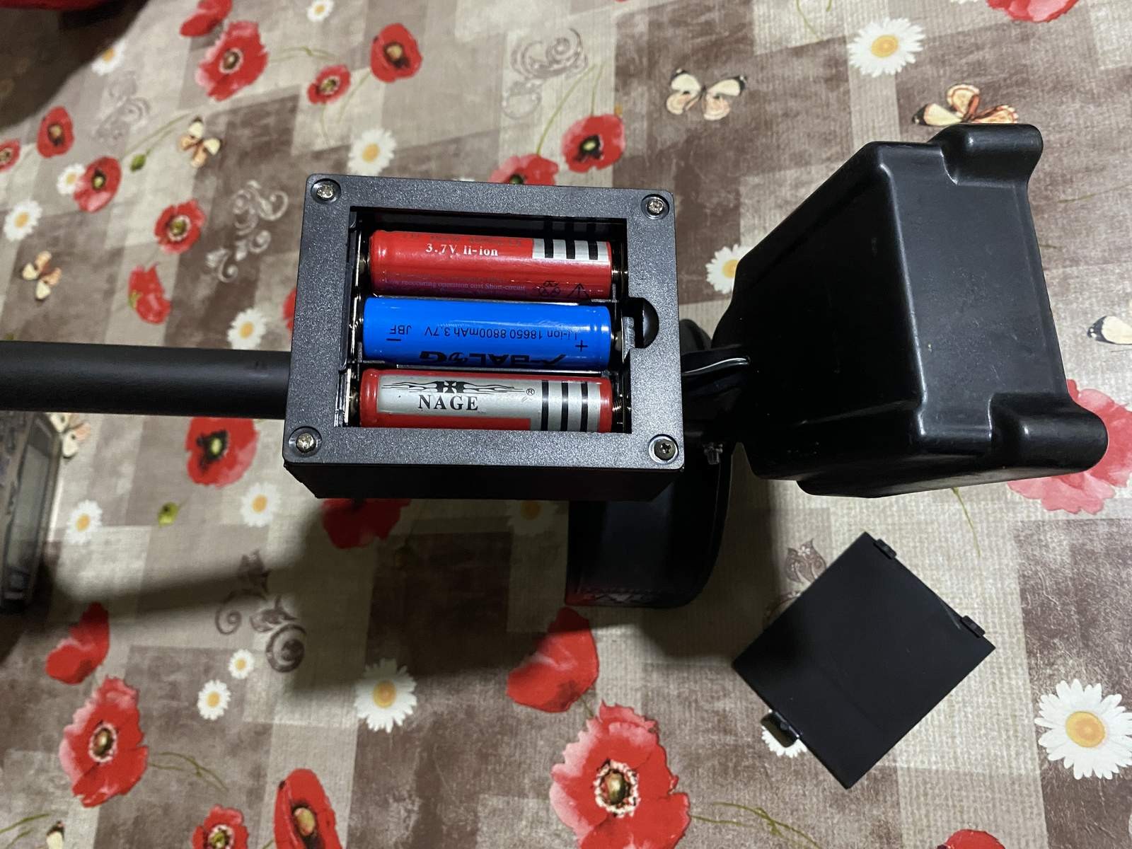

                              • #60

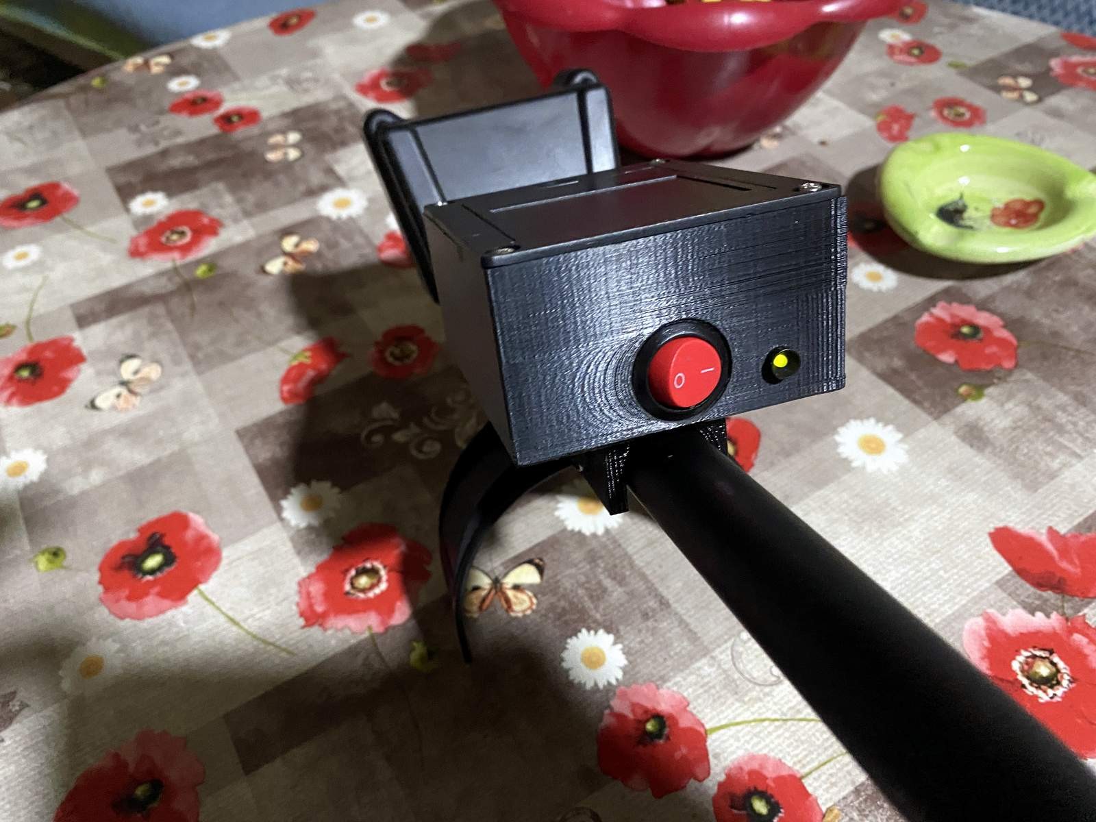

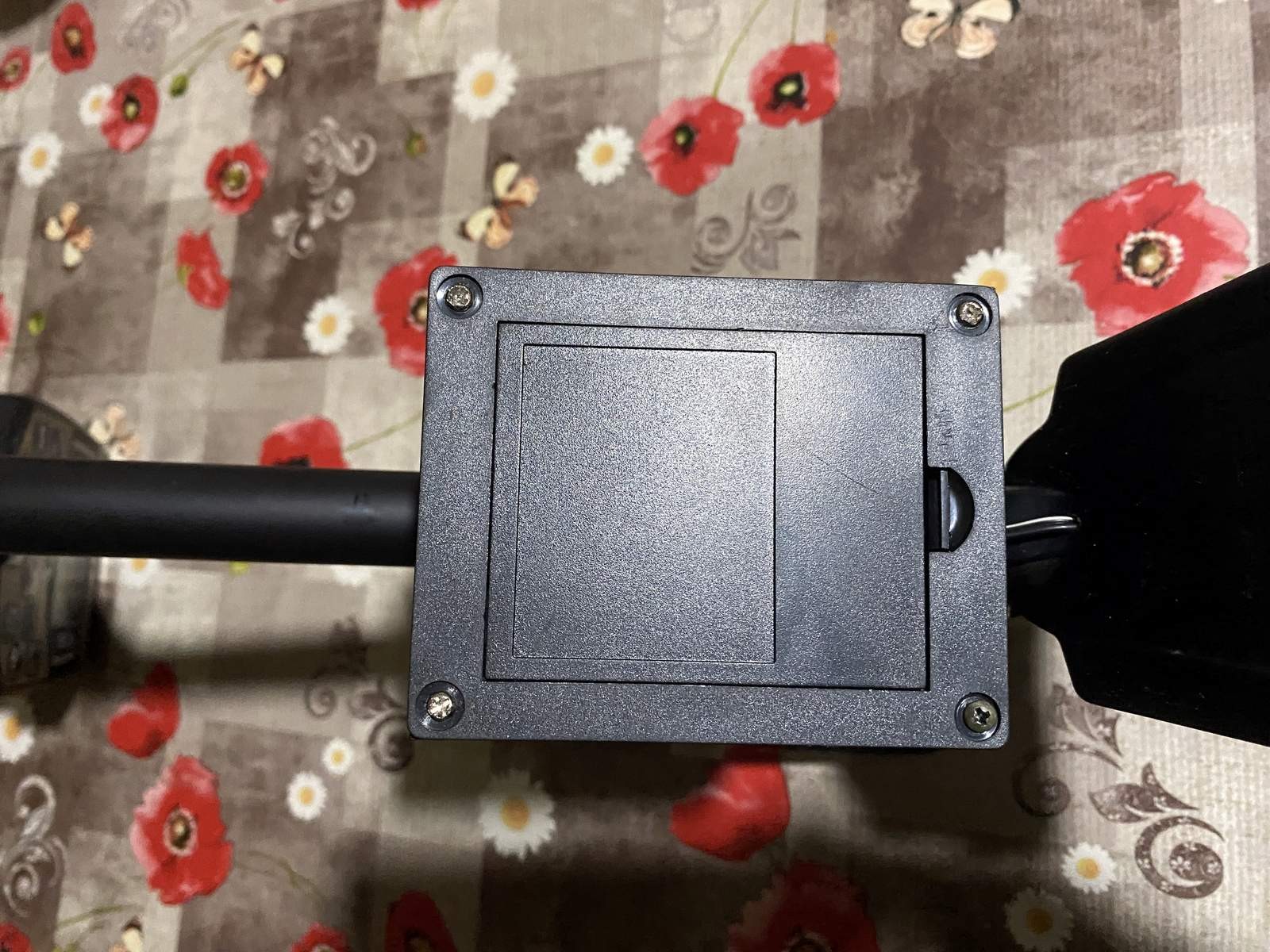

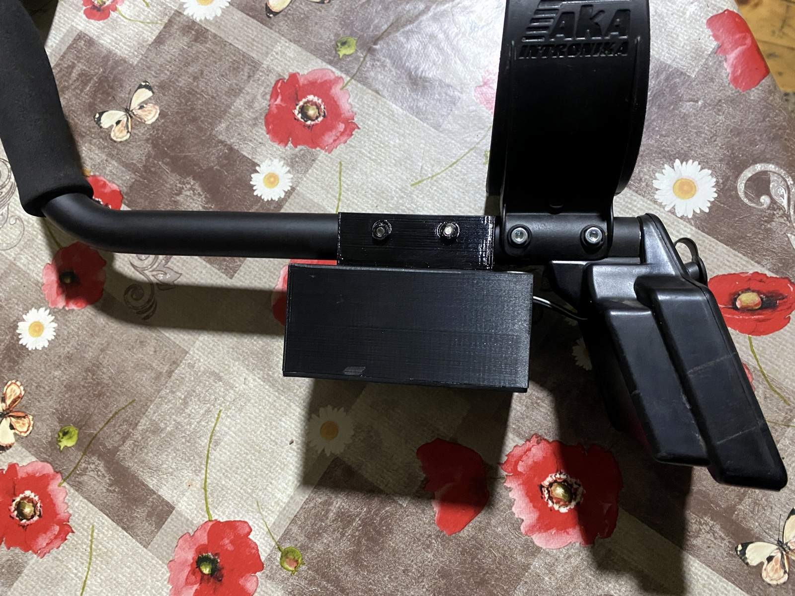

                                A friend has an AKA Signum, he is quite satisfied with it, but he complained to me that the detector simply "eats" batteries.
                                When I checked, depending on the operating mode; detector consumes from 150-280mA !!!
                                So I added this case for 3 higher capacity 18650 batteries in series, a switch, an LED and an LM317 regulator set to exactly 9V.
                                The LM317 has a heatsink, but after 20 minutes of operation the heatsink remains quite lukewarm.
                                I don't have time to get serious about this detector, I haven't even tested it outside the room.
                                It looks impressive in the room. Quite a nice detector and seems to me to have potential.
