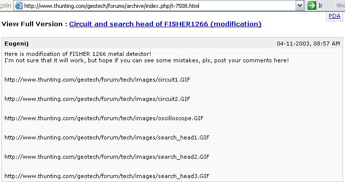

    Here is modification of FISHER 1266 metal detector!
    I'm not sure that it will work, but hope if you can see some mistakes, pls, post your comments here!

            Hi Eugeneij
            I have a look at schematic but i must say that is a very very modify 1266.
            I think you dont need the two diode in the first rx stage ( d1-d2)and found very strange detail about coils.
            You need even a 470pf capacitor connected at ground and at common pin of r6-7.
            Bye Max

                      No picture ???
                        See, is from the old forum, year 2003. Links doesn't work, maybe Carl have recorded all, or what happens during reconstruction of the forum? Here the old page you can found in Archive section:
